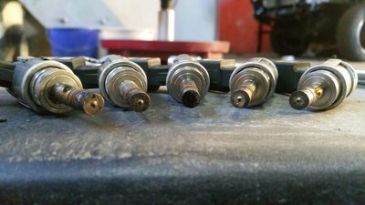

I changed yesterday all 10 injectors...(here the 5 of bank 1) :shock: :shock:
Car is running again...no ignition failures etc.

Clogged due to poor fuel quality?

No.. Never other fuel as 102 oct

Wow that's bloody terrible!!!
I'm glad it's all sorted but what the hell has gone wrong for that sort of damage to occur????

Man, I don't know.... :(

They can cause ring landing failures if they fail. I was going to send mine away to get serviced and new seals
