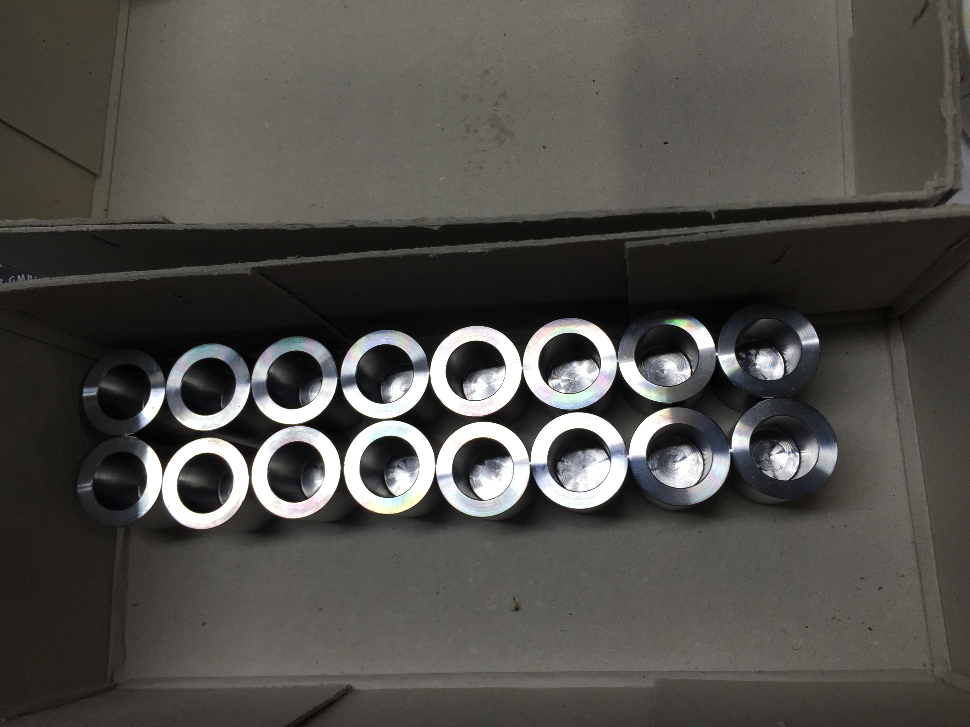

I had mine replaced with stainless steel ones.
They are cnc made and fit perfectly.
Works perfect even on track for one year now.
If somebody is interested I might be able to help you out.
PM me for details.
