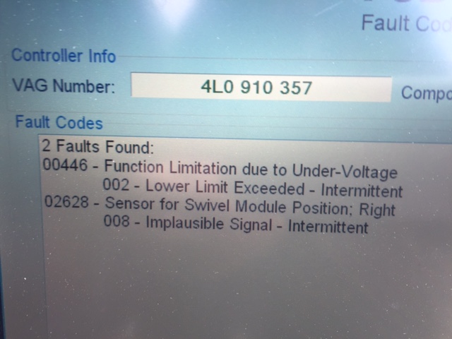

I'm showing how little I know but here goes any way. Two fault codes taken roughly 6months apart.
Does the " Right" mean the drivers side ie viewed from within or is it the opposite viewed from outside standing in front

Did you manage to swap the brains over to see if the problem moved? If not then the sensor should be checked, would need to check else for the location of this.

The first fault code appeared and I took the car to Audi they did some more checks and eventually said the whole light unit needed replacing. They replaced the near side front unit. However after just two weeks the warning light came on again.
The second fault code was last week after the unit had been replaced. I'm trying to find out if they actually changed the wrong unit as I don't know what side the "RIGHT" referees to. ????

Right refers to when your sat inside the car.

Oh dear me thinks Audi may have changed the wrong light . Thanks for your help

When you clear it what happens?

I haven't cleared it this time. The warning light has just gone out. This happened the first time light would come on then the following day it didn't come on this would happen randomly sometimes not coming on for a few weeks. Then it came on but wouldn't go off even after clearing the fault code it just came back again. This is what prompted me to check it further and Audi said the whole light unit needed replacing.

If it's intermittent then get the, to check again. Did they change that under warranty?
