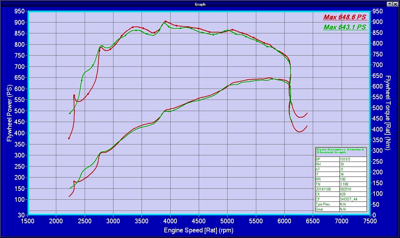

So finally had the chance to dyno the car after long time spent on the jobs at the dealer. Attached is the graph, appreciate your feedback guys whether this less than normal, acceptable, good, above good?
Please note that car is only have chip tuning done by ABT with no other mod done whatsoever, rest all stock.

Any comments guys? I was wondering if you see anything that might look wrong! or could be better, does it look close to MRC tune or big difference is there?

For a generic map it looks OK to be honest. It's a bit hit and miss as to how much you'll get unless it's tuned on a rolling road. Is there nobody out there who can do this for you?

Thanks for your comments, I don't have any one in UAE except PP-Performance, which I don't like, heard some bad feedback from couple of friends. I wish if i can get MRC or MTM over here. I have only ABT but they do stage 1 only as they don't have workshop, they only send ECUs to be chipped in Germany.
