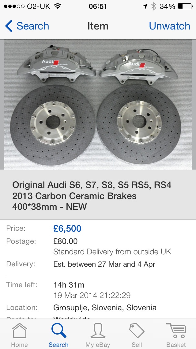

Anyone know if these will fit?
Same size discs...different style caliper?
From a C7 S6?
From a C7 S6?

No they won't fit straight on. Wrong discs and caliper carriers sizes and the discs bells might have different offset.
If you can buy some used Q7 ceramic calipers then I can help you with the carriers ( I have the CNC pattern).
New front ceramic calipers cost just over 1k each from the stealers.
Re: Carbon Ceramic brakes?
Discs are smaller.RS6chris! wrote:Anyone know if these will fit?
From a C7 S6?
Calipers wont fit.
Price is more than you would pay for an OEM set of RS6 ones!
