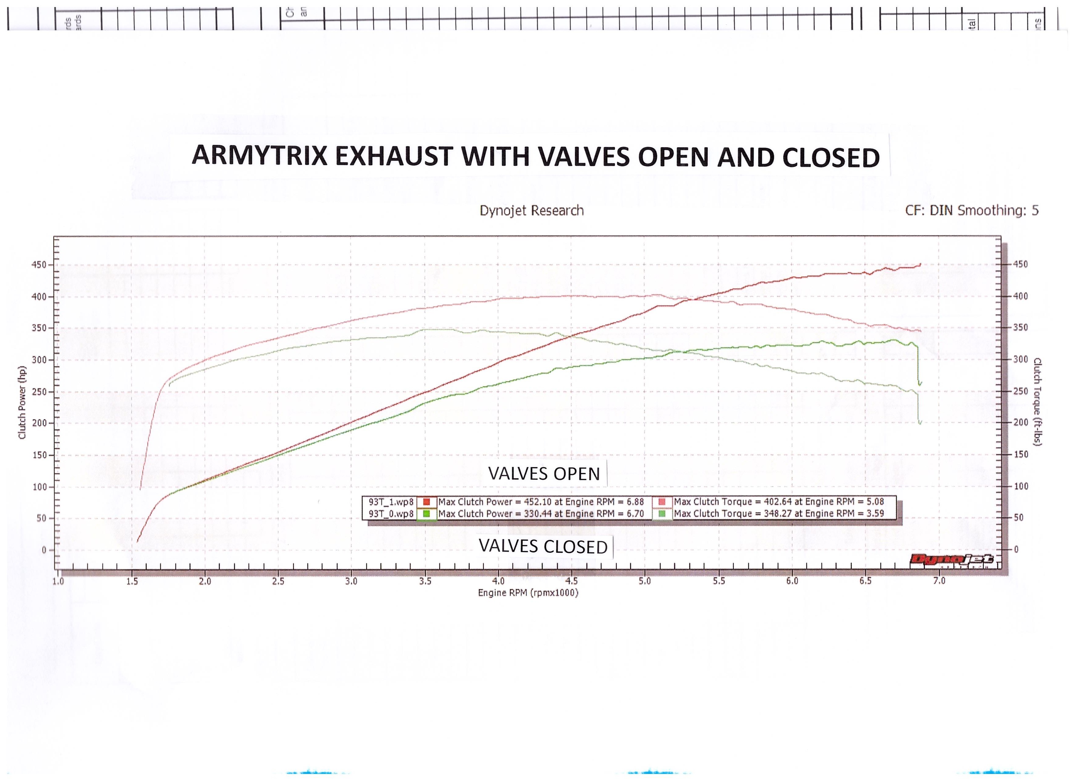

Post by S5 tony » Wed Apr 29, 2015 10:11 am
was running the Armytrix Exhaust till we put it on the dyno and got a shock.contacted Armytrix and they didnt want to know.replaced it with a custom valved Ehaust and very little loss with valves closed
