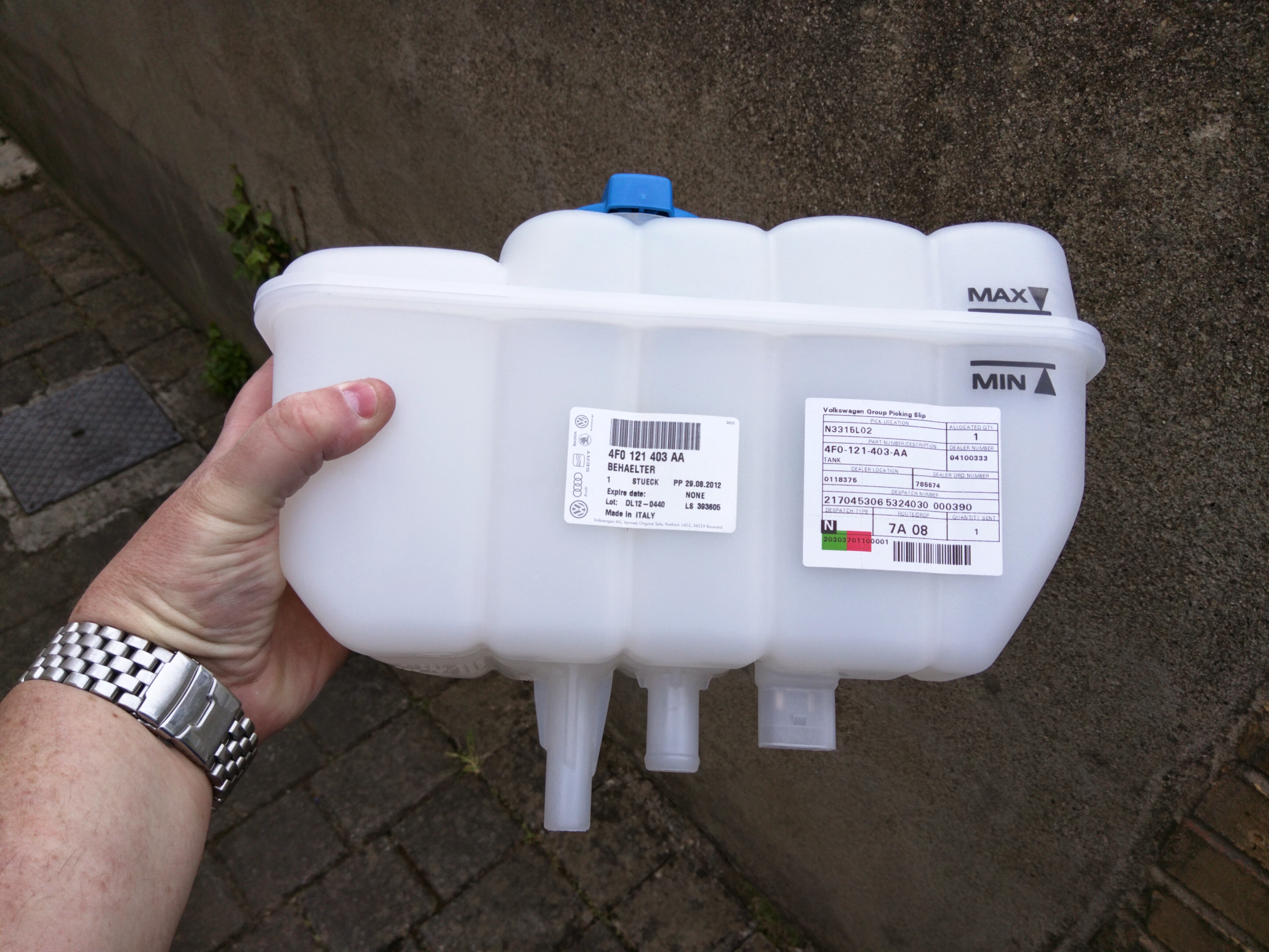

New tank prior to install so you can see the connections underneath:

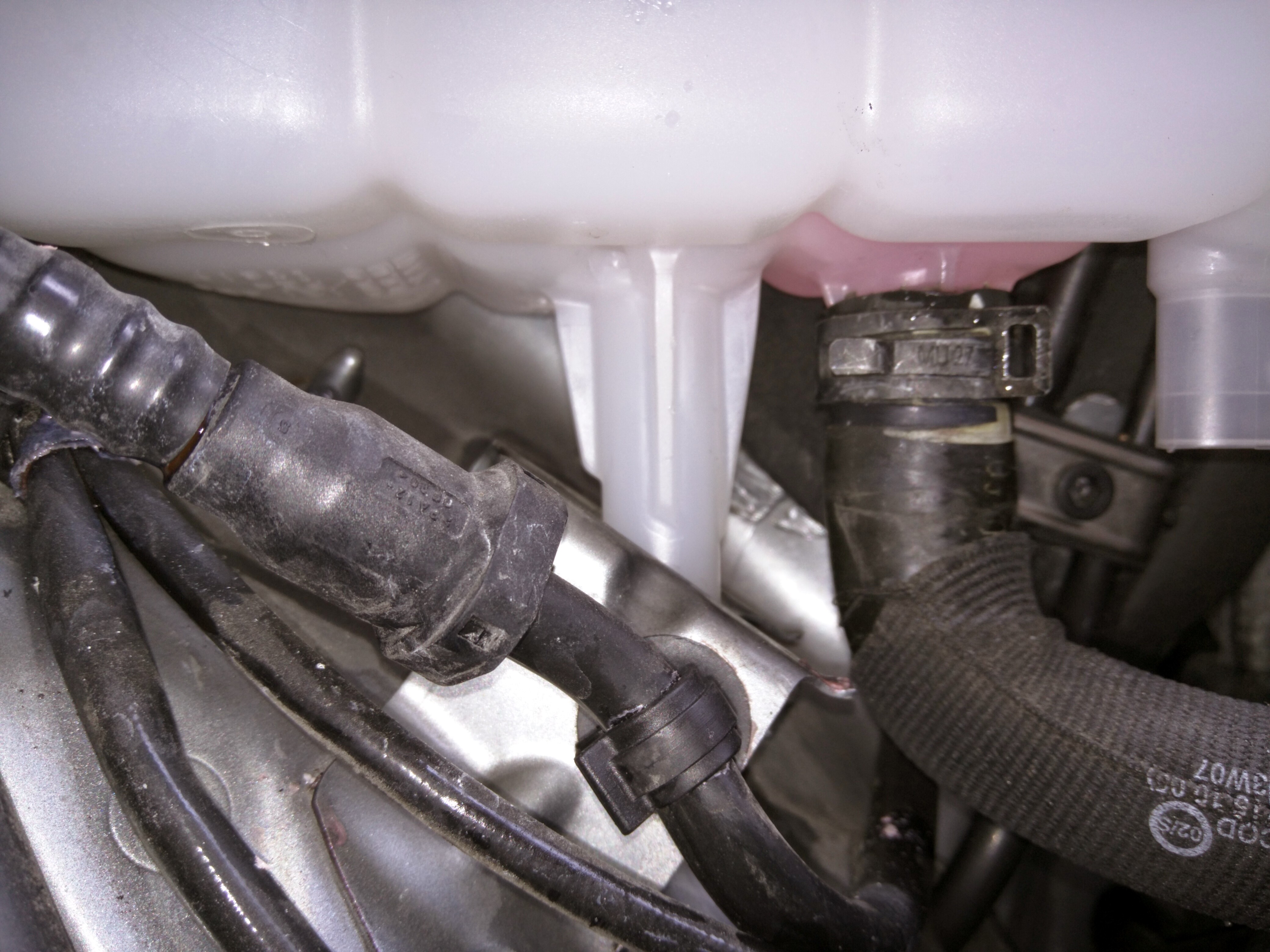

Pipe in place underneath the tank (sensor attachment is to the right, the overfilling drain to the left):

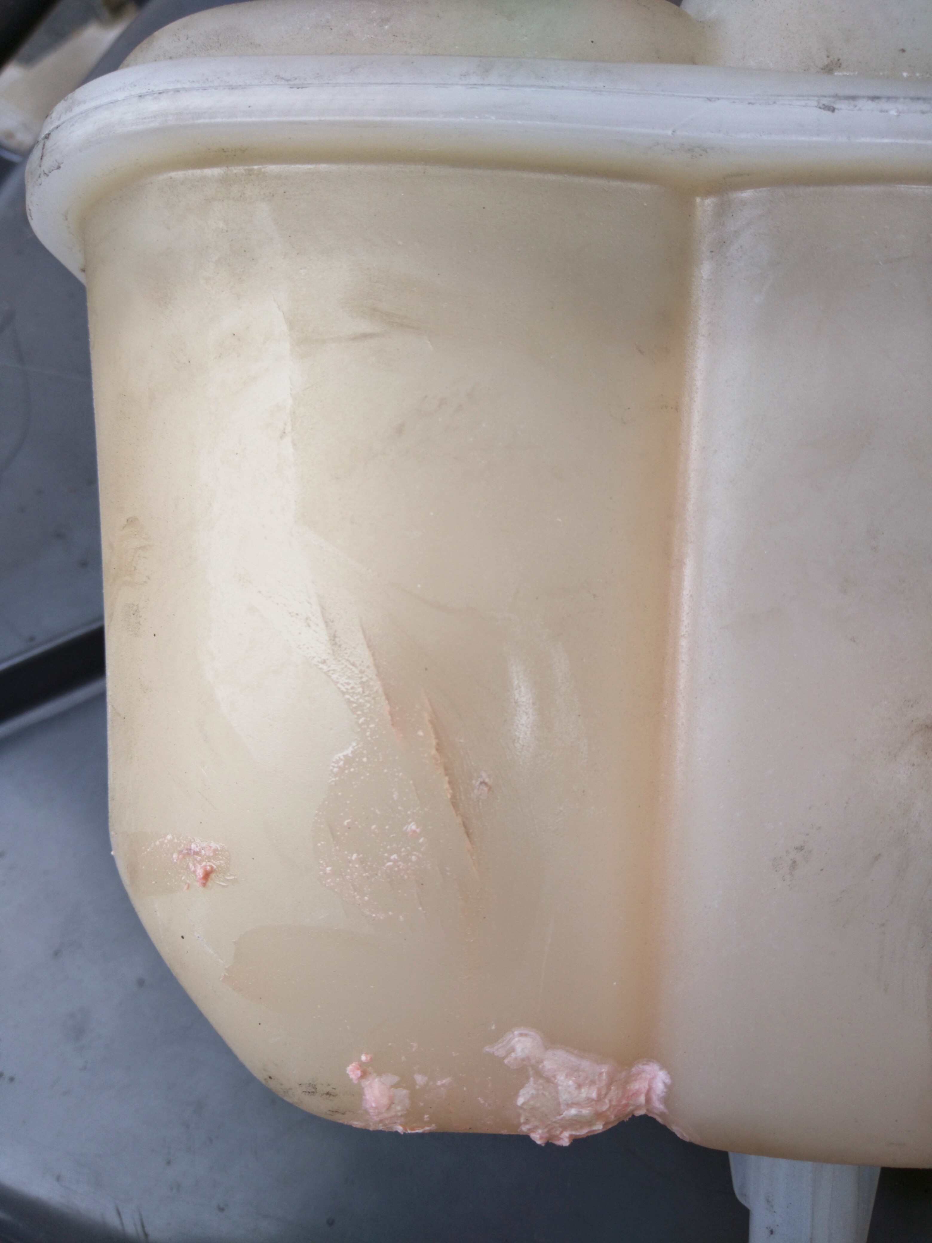

and lastly, old tank with cracks:
