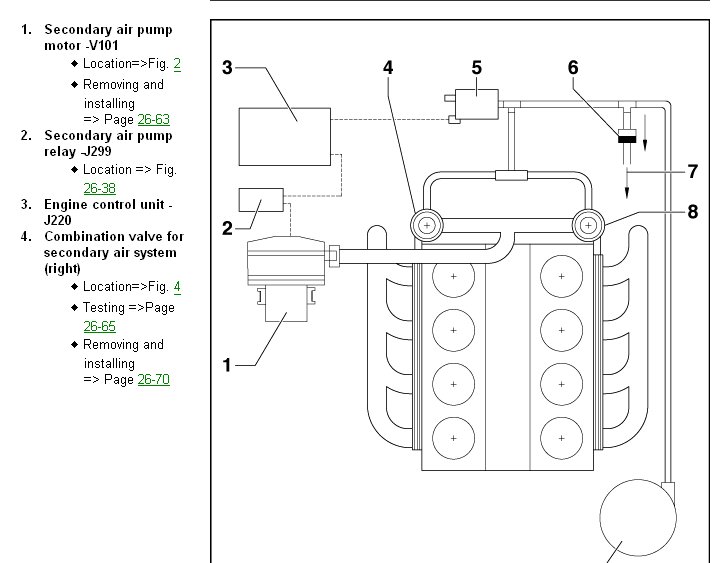

RE: Re: RE: ENGINE Faults help please RS6 C5
For physical location of the N112 and the secondary air pump, see this photo:
(the secondary air pump is visible on the far left about a third up from the bottom.
