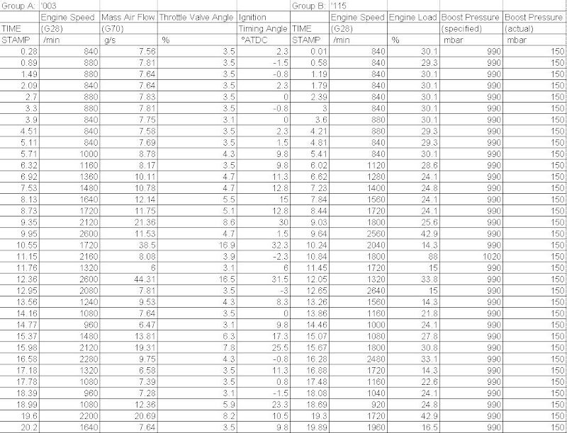

I've done some logging on VAG-COM whilst the car was stationery, just gentle revving, to see if there are any clues there.
anyone notice anything strange???
