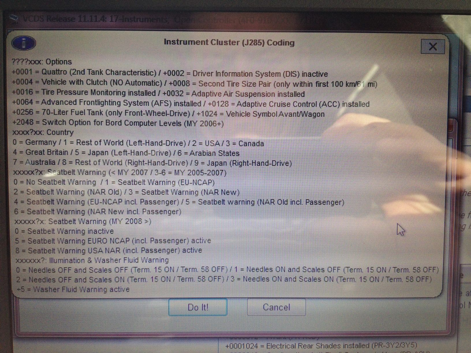

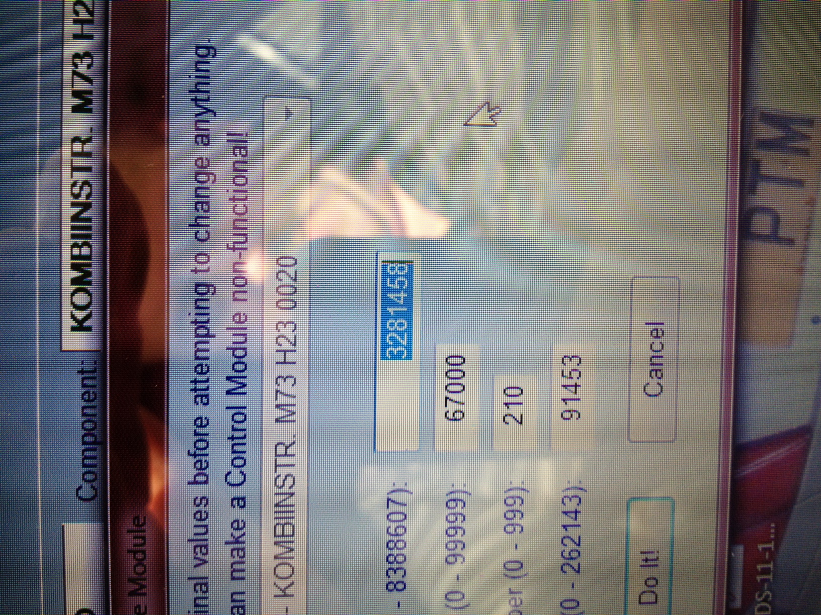

Been messing around with VCDS today.
managed to enable
Hidden menu and TV in Motion but i am struggling with the needle sweep. My car is a 58 and dont seem to have the long Code option.
I tried adding 3 removing 3 from the total, other than getting really annoying bleeps nothing happened
Anyone able to help??
Needle sweep no long code helper
