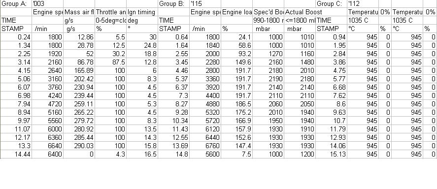

Hi All,
Could one of the specialists cast their fine eyes over this and just put my fears to rest that things are running as planned!
Car has an AMD remap and Milltek cat back.
Thanks alot for your time...much appreciated!

Anyone want to comment? Timing looks advanced but it does have an AMD map which might be the reason, Cheers

I'm no expert, but it looks OK to me.
Timing isn't that bad, specified and actual boost is close enough, and your MAF reading is pretty strong.
FATs time is a little under par, but the road may not have been flat and you may have had a car full?

Agree with Clive. Nothing looks desperately awry but perhaps bets to get someone who knows more to look over it. Boost is very good.

From memory it looks much like the logs I got off my Amd mapped S4
