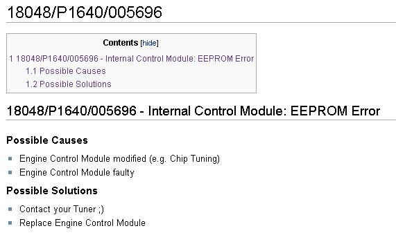

The Ross-tech wiki says 2 possible things. I've cleared the error and hope it doen't come back. Could it be related to my boost problem, I doubt it?
