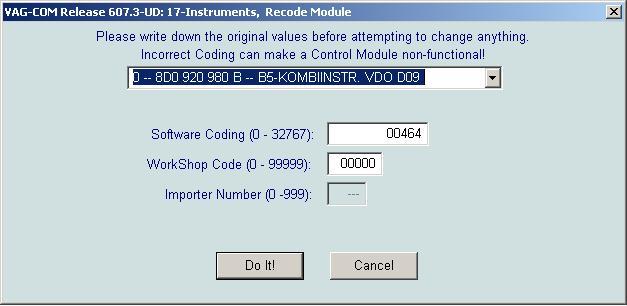

I fitted new brake pads yesterday, went for ones without the wear sensors. Thought to myself 'no problem, just recode the dash so is doesn't show an error'
So today I open VAG-COM and go to change the code, thinking I'll take 02 off the first 2 digits of the code... I then find my current code is 00464
So to me that looks like the only digits that match the ROSS_TECH site are the last 6 and 4 for 6 cylinder turbo petrol.
Anyone any ideas?
Anyone any ideas?

The table on the page referred to is woefully out of date.
Current info here:
http://wiki.ross-tech.com/index.php/Aud ... ter#Coding
As you can see, coding of 00464 makes perfect sense for a UK S4 of MY 2000 or newer. Unfortunately, all the S4's of 2000 and newer had the brake pad wear sensors so there was no programing option for that anymore. The only solution is to fool the cluster by jumpering the wires.

Thanks for the response Uwe, looks like thats what I'll have to do then...
Looking at the wiki, if I make my code 02464 will I get seatbelt warning then?

Only if your car has the appropriate wiring to and switches in the seat belt buckles. If it doesn't, you may not get a warning, or get a warning all the time even when the belts are latched.
My guess is you don't have the necessary hardware.

OK. I'll leave it alone.
Thanks for the info.
Off with the wheels again to short the wires for me...
