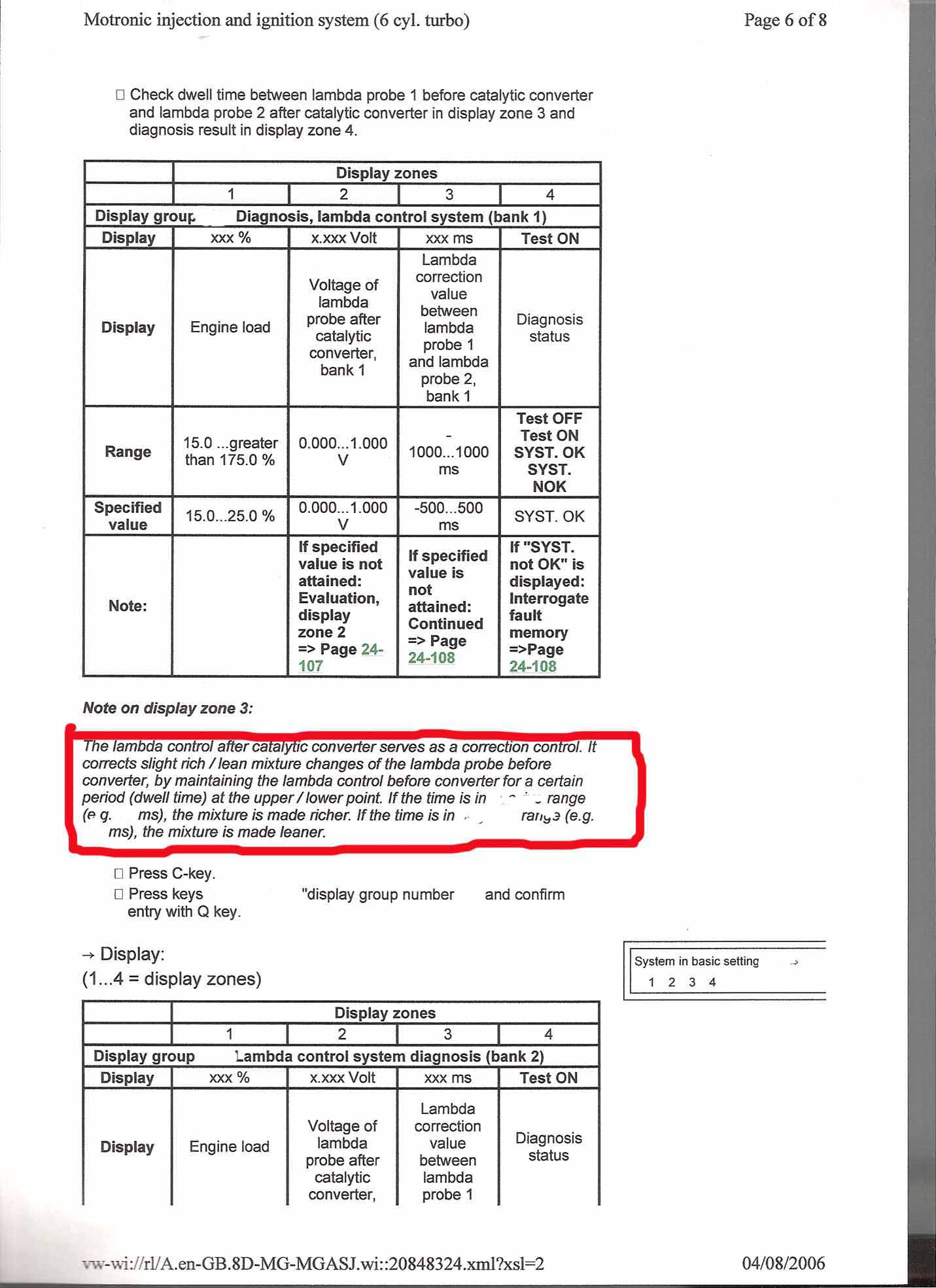

What these post cat sensors do is make sure the cats are doing their job. The generated voltage will be stable if the system is working correctly.
The Pre cat sensors should fluctuate the voltage quickly allowing the engine ecu to trim the mixture based on what they sense. If its slow, they may be aged or clogged. this will reduce the effectiveness of the engine to produce max power.

Morpheous, in what blocks do you read the post-cat lambda sensors on a 8D0 907 551F RS4 ECU? Does this specific ECU actually check for precats existance or not? Curious to see what you think vs reality.
What are you talking about, it cant check for the existence of the pre cat.
I obviously need to clear this as you are confused.
Forget testing of pre cat itself this is what I was trying to say:-
You have bank 1 or 2 probe 1 which is the pre catalytic converter probe which does most of the sensing work B4 the gas is cleaned by passing through a catalytic converter.
Bank 1 or 2 probe 2 is the probe after the catalytic converter which checks for correct operation of the cat by sampling the cleaned exhaust gas, if the cat is knackered, this probe would detect the cat is not doing its job. If this is the case, catalytic converter low efficiency is flagged up.
It does not check to see if someone has removed the pre cat.

Morpheous, what I'm talking about is the fact that an RS4 551F ECU coded to 04711 doesn't give a damn about the secondary lambda probes and it doesn't care of the precat existing or not. Nor does it display the secondary lambda output voltage. This is something that ELSAWin doesn't tell you, but be my guest and connect to such an RS4 and you'll see for yourself (block 031).

oh, by the way, have a look at the RS4 exhaust system and you'll see that the secondary (B1/2S2) lambda probes only check for the precats, not the main cats. They are mounted right at the inlet of the main cats.
And, on a 551F ECU, the codeword DKAT (catalyst diagnostics) is set to 0.
Yep you are right, looks the same as S4 looking at elsa.
Don't see these much any more and getting old hence the memory loss. On the new stuff its different and as stated.
