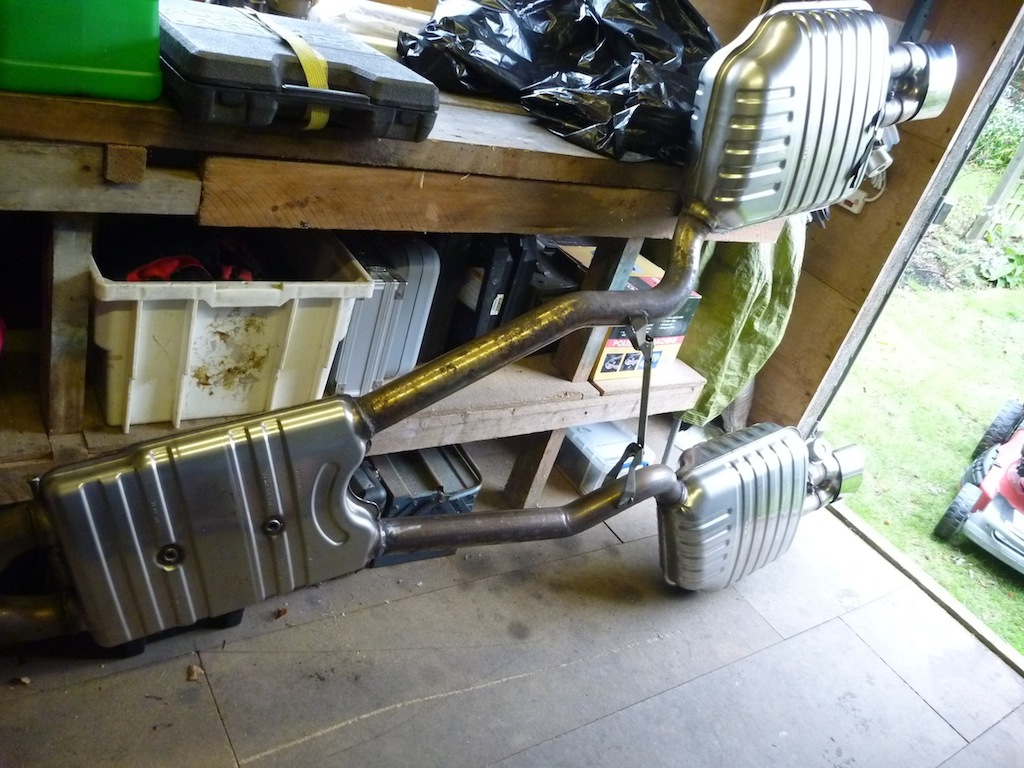

here's the OEM system off the car - I'd suggest cutting halfway between back boxes and centre resonator box, as the pipes are straight at this point - would be a good idea to draw a straight line on the pipe with a marker pen before cutting so you can make sure you can align them correctly when re-fitting
OEM system

Looking at the wheelcourier site, they'd charge £35 to get your OE system back to you (it's just under 3m long) - so not much difference in cost in cutting it into 3 and buying 2 more clamps to put it back together again later. I reckon without a car lift it would be much easier to get the system back onto the car if it was in 3 sections. All aftermarket systems are done in multiple sections, so no different

Ps. after paying a courier to retrieve mine from the fitters, I had to cut them anyway as didn't have sufficient room.
As others have said, they're easy to saw and put a few alignment marks should you want to re-fit.
