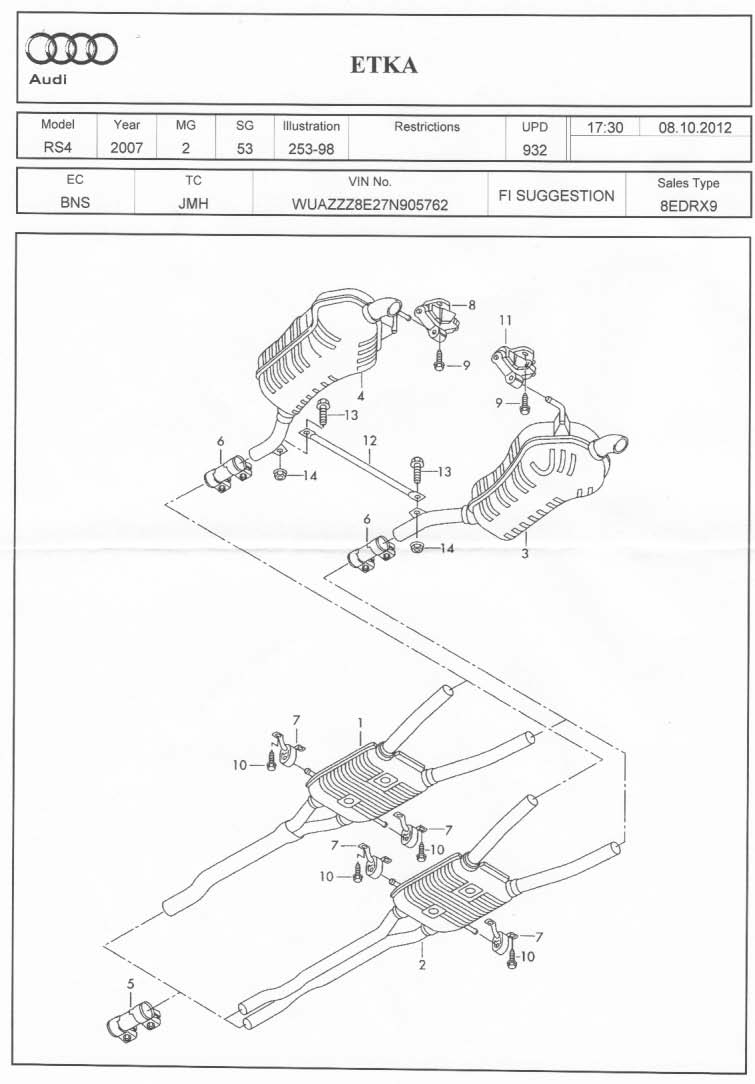

Here you go....
Audi parts diagram showing 3 sections

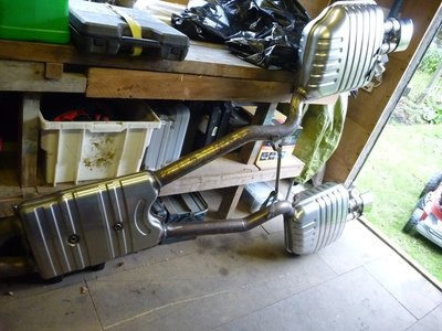

here's the OEM system off the car - I'd suggest cutting halfway between back boxes and centre resonator box, as the pipes are straight at this point - would be a good idea to draw a straight line on the pipe with a marker pen before cutting so you can make sure you can align them correctly when re-fitting
OEM system

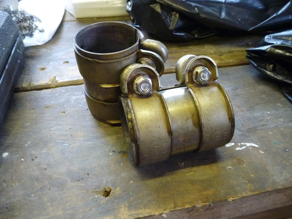

you'd then need a pair of these clamps to re-connect the sections - Audi part number 1K0 253 141 H
'dual clip' 60mm exhaust clamps

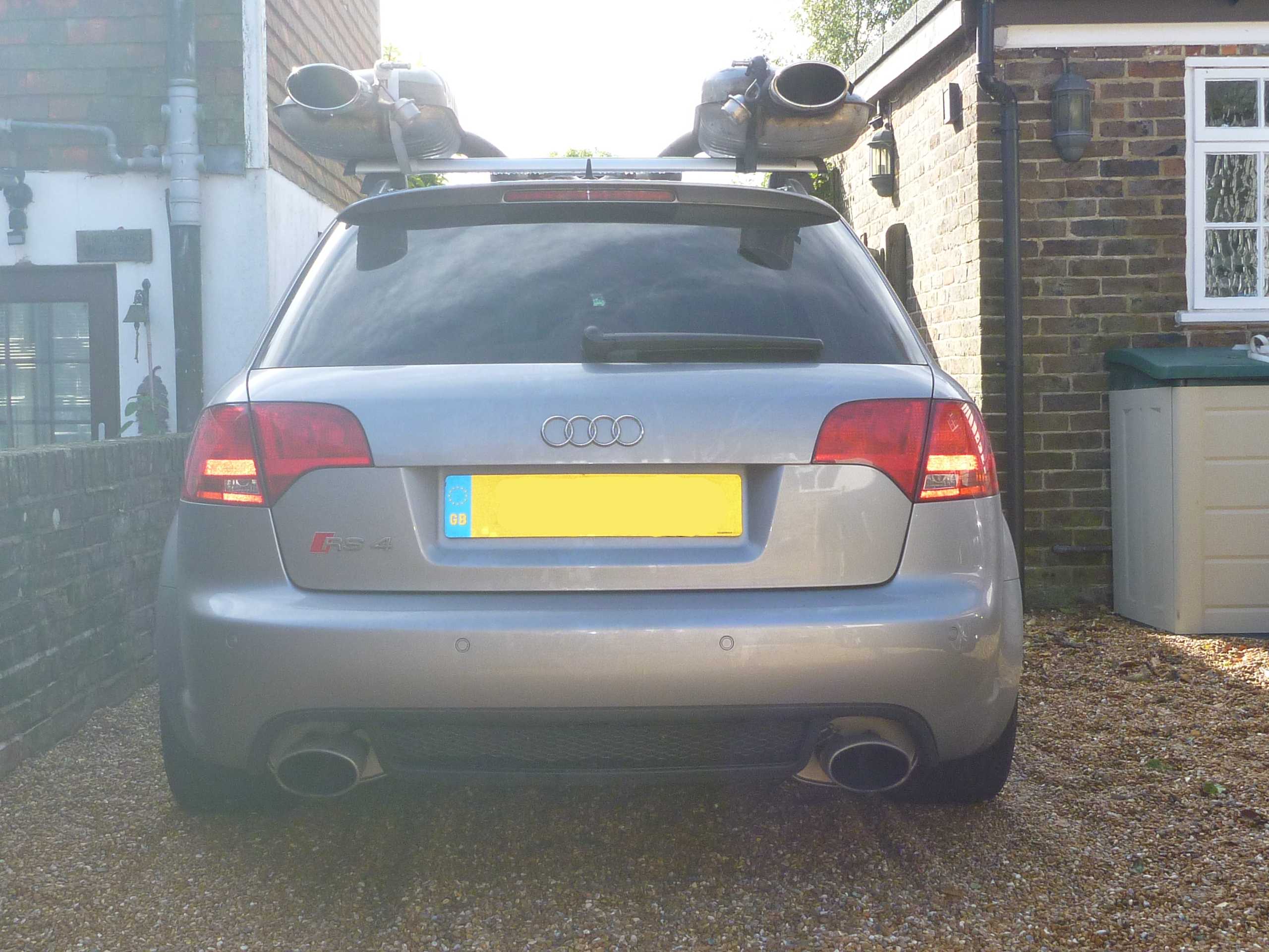

and for a laugh - here's the unique quad exhaust quad valved Avant that I created for an afternoon!....
roof mounted exhaust anyone?....
Looking at the wheelcourier site, they'd charge £35 to get your OE system back to you (it's just under 3m long) - so not much difference in cost in cutting it into 3 and buying 2 more clamps to put it back together again later. I reckon without a car lift it would be much easier to get the system back onto the car if it was in 3 sections. All aftermarket systems are done in multiple sections, so no different

That looks awesome... I'd be tempted to tack-weld them up there.
Ps. after paying a courier to retrieve mine from the fitters, I had to cut them anyway as didn't have sufficient room.
As others have said, they're easy to saw and put a few alignment marks should you want to re-fit.

Ha, that looks like something out of starwars, epic! No wonder you got some funny looks, hehe.

RS4-AL wrote:Ha, that looks like something out of starwars, epic!
hadn't thought if that - but now you mention it, it was a kind of RS X-Wing! as Timster says, should have left it on... :biggrin3:

That does not look like a RS 4 Exhaust in that ETKA diagram
**edit, take it you was using that as a example of where to cut the oem exhaust?
pDkALO
Posts: 688
Joined: Sun Dec 18, 2011 9:43 am
Re: Getting the Stock Exhaust Home
Post by pDkALO » Wed Oct 17, 2012 10:12 pm
sonny wrote:That does not look like a RS 4 Exhaust in that ETKA diagram
It's actually the dealer's ETKA print out from my car's details, and agreed it's not exactly right (no valves, wrong outlets etc) - the parts guys told me that it's a generic diagram that comes up against a number of cars.
But otherwise, yes, I put it up as useful for showing the approx cut locations.
