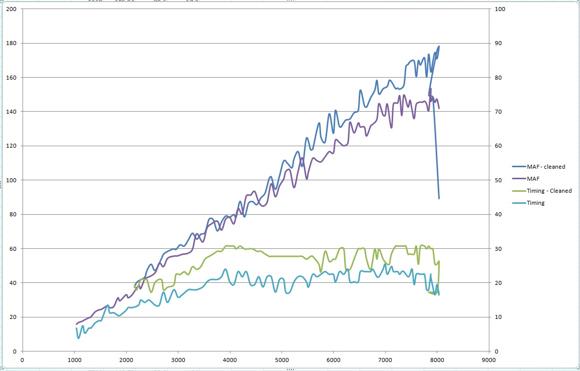

Started a conversation Doug at MRC. He suggested the best way forward was to have a Health Check. Took the car in about 3 weeks ago. Dyno run showed 355ps, greatly reduced amount of air going into the engine/cylinders and a <beep> of up to 13 degrees!
Clearly only 1 way forward - MRC clean. I chose to go for the 'quick clean'. Booked in and waited until 4th. Had also acquired an MTM replacement panel filter and asked for that to be added at the same time. (There's another story that but for another time).
Dropped the car off yesterday and then went off to Bletchley Park for the day.
Came back around closing time. Dyno sheet waiting for me on Dougs desk. 411.9ps !! :D

That seems too high mate, really? I've never known anyone to get that kind of change from a carbon clean in fact some say that they wouldn't have done it if they'd known how little difference it made. I guess Miss Daisy must have been driving your car! There is a lot to be said for REALLY driving it to the redline and getting air through the cylinders to prevent build-up.

about the normal increases for a car in that state standard:
Peak Maf from 153 g/s dirty to 178 g/s cleaned
Overall timing from 22 degrees drity to 30 degrees cleaned
