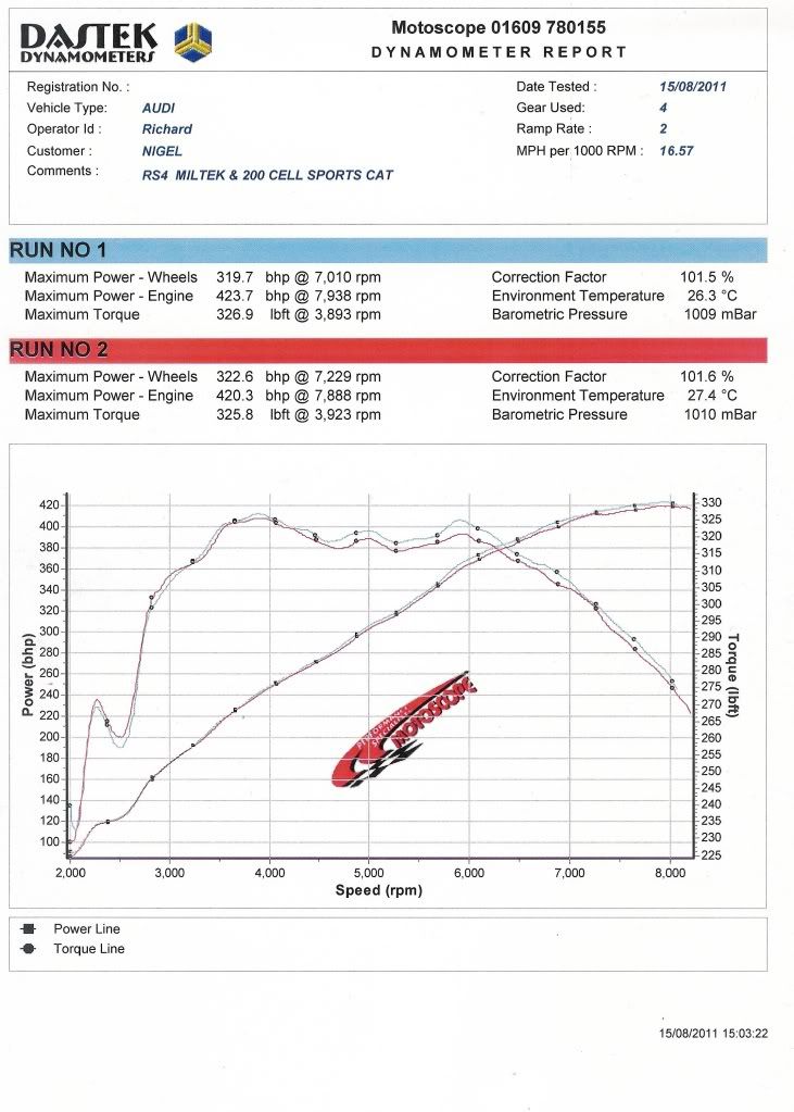

Also, I did a power run at Motoscope back in August, the figures seem to be quite good comparing to others I have read on here (423.7 & 420.3 bhp). What sort of power increase would I expect after re-map?

Just a question. Why does Run 1 show less power at wheels but more power at engine than Run 2?? Probably a logical answer. Not having a pop at you but just something I saw.

alex020869 wrote:Just a question. Why does Run 1 show less power at wheels but more power at engine than Run 2?? Probably a logical answer. Not having a pop at you but just something I saw.
I notice that too, but have no idea how dynamometer works. I'm sure someone on there can explain.
I'm not totally convinced on the accuracy of dynamometers. My car made maximum of 423.7 bhp with just K&N filter, Milltek exhaust and cats, where as others are producing not much more with ported/polished/deflapped manifold and cold air feed. I might take it to another dyno to see if there is any difference.
For comparison on the same dyno mine made 407 bhp and 315 ft.lbs. (IIRC on torque) with non-res cat back, BMC filter and ported polish manifold vs. 394bhp and 312 ft.lbs. on non-res catback and BMC filter with OEM manifold.
I reckon with a decoke I could temporarily achieve the same numbers as you so your cats do work but not that well and would work better with a remap. IIRC caldy with 200 cell cats and s/s exhaust, remap and OEM filter and OEM manifold made marginally more BHP but more torque than you did on the same dyno.

I thought Milltek exhausts and sport cats don't really increase power (just better sound) on it's own, that's why a re-map is recommended to maximise the better exhaust gas flow.
Consider that you have a modified exhaust, my car produce about 30 bhp and 15 lbft more that yours (before ported polish manifold). That means the Milltek is a worthwhile modification. Hopefully a re-map will increase it further. Once I have the re-map done, I'll take it for another power run on the same dyno.

cat back marginal, maybe a few bhp, but sports cats yes. You are effectively getting rid of two and then halving the density of those that you have left by using 200cell cats so airflow is always going to be better giving you more power.
The point I was attempting to raise is that a simple port polish, and decoke potentially have the same effect as sports cats but is a VSA compliant modification.
