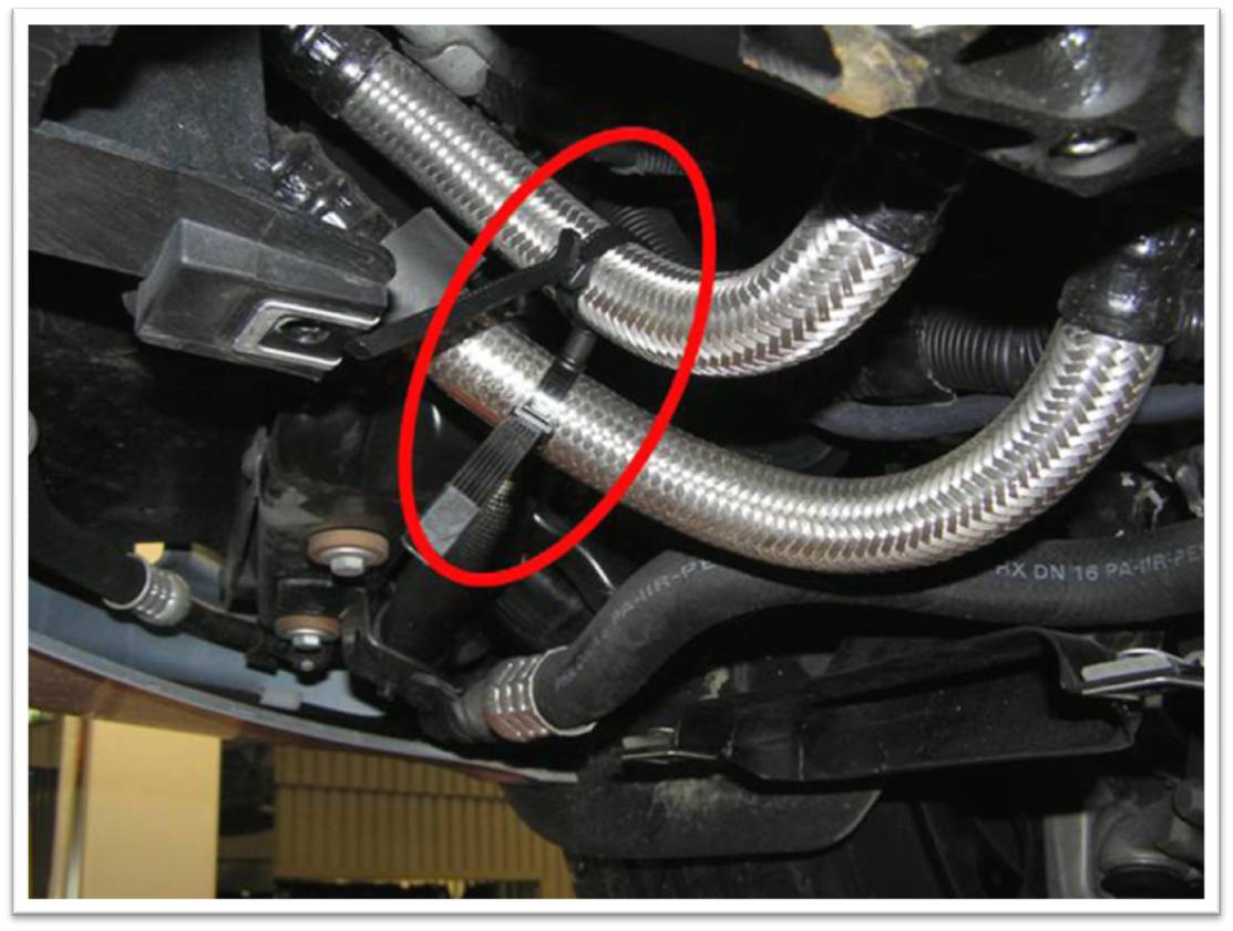

Hi All
Got a leak on my oil cooler pipes which I thought was covered under warranty under a previous recall.
Emailed pics to my local Audi dealers and they say probably wont be covered as "corrosion", can anyone clarify if its covered under my Audi extended warranty and is there a recall number or something I can email back to the service dept.

IIRC the oil cooler inspection TSB was to inspect and slap on a bucket load of grease on them to stop them corroding, not to replace them.

I had them done under warranty on my B5 S4 due to them corroding if that helps.
Re: Oil cooler pipes corrosion....under warranty?
Just had mine replaced under (extended) warranty. The initial problem was a slight oil leak from the oil cooler and the pipes were replaced as a precaution as was the oil cooler itself.

I had to pay for mine as well, got it done by a indie.

I had mine done last year, Audi paid 50% Good will. Cant grumble at that.

Cant remember the price Think it was about 500/600ish?, I had the oil cooler replaced too, so had it done together, to be fair the corrosion was not that bad, im mega OCD when it comes to the car so would rather have it changed out there and then instead of it busting on the road of even worst on the track. At the same time I had the expansion tank replaced too only £23!

It was my pipes that were corroded, not the cooler but the join to the cooler was so corroded they could not get it off without replacing cooler, think it was about 600 all in.

Just got email through from Audi.....
Unfortunately we have attempted to claim the oil cooler through extended warranty previously and they send inspectors who will decline authority if the fault is due to corrosion.
Car has clicked over 60k miles now so guess they have a fair point as a lot of miles...unless anyone knows a way around this its going to get stripped and done by us....looks like a fun job!

So, a part that is known by Audi to corrode early (hence the recall procedure) is not covered by extended warranty, even though some others have had it replaced or had 50% goodwill? That's f*cked up.
It is crazy, there was never a recall on the oil pipe or cooler. There was a workshop campaign, that saw the the attachment of a double cable tie, this was to stop the pipes chaffing together, not corroding due to rust.irvind wrote:So, a part that is known by Audi to corrode early (hence the recall procedure) is not covered by extended warranty, even though some others have had it replaced or had 50% goodwill? That's f*cked up.

ahhh, now explains it then.....
managed to locate 1 x pipe from a fellow member (thank you) and will be ordering the other pipe from Audi and do it ourselves.....along with the clip to stop anything going wrong again.
