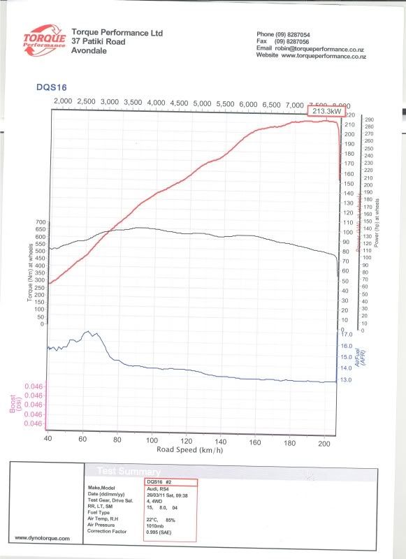

Just dynoed the B7 RS4. Got 213wkw.

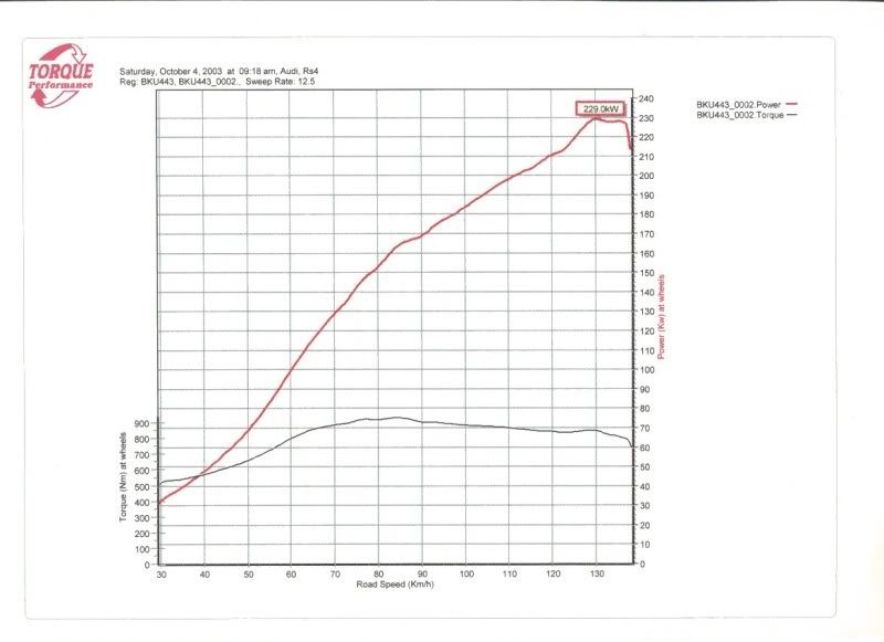

Problem is, my old B5 RS4 did 229wkw (stock), and thats suppose to have ~30hp less that the B7.
I assume this is the dreaded Carbon build up, as i dont seem to get any 5,500rpm kick in the pants.

Here is the Dyno Graph. As far as i can tell its down to flywheel ~360hp peak.
http://i20.photobucket.com/albums/b239/ ... B7Dyno.jpg
Here is my old B5 RS4 (Stock) onthe same dyno.
http://i20.photobucket.com/albums/b239/ ... rwheel.jpg

Well, that equates to 286bHP which is not a lot for an RS4, also judging by the radical change in printout, although you have gone back to the same place, it would appear you were tested on different (possibly new) rollers !
Re: Low power output, B7 RS4
Do note that that is Wheel KW.Ice_Coffee wrote:Well, that equates to 286bHP which is not a lot for an RS4, also judging by the radical change in printout, although you have gone back to the same place, it would appear you were tested on different (possibly new) rollers !

It's not that bad actually. You don't have the kick, I can see that as your torque generally falls off and there is no peak in torque at 5500 rpm.
The temp is 22 Degrees, but your intake temp is probably in the 50's on the Dyno. I'd say the drop in torque is just due to more timing being pulled given the hotter intake temps.
Your power curve looks ok, I don't think you have anything to really worry about at the moment.
test was run in 4th
from 65-170 (~40 to 102 mph) you have > 600 Nm
that equates to 2500 to 6500 rpm
600 Nm ~ 440 lb ft?
what am I missing?
600 Nm ~ 440 lb ft?
what am I missing?
