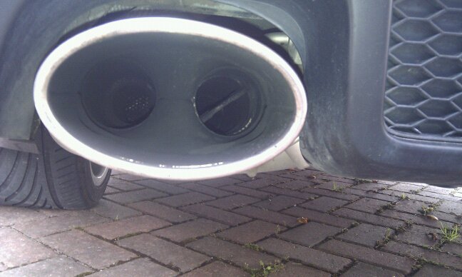

The final thing that was wrong that I have resolved was the exhaust flaps. They were stuck shut :roll: With a bit of intervention with the wooden handle of a hammer they are now stuck fully open. Is there any reason (apart from noise regs) not to have them permanently open?

As for the exhaust flaps... This could be a faulty/kinked vacumn hose and this will affect other things and required the engine manifold off to check and fix. Something like 4-8 hours just to remove and refit let alone diagnostics.

Yes I certainly do get the hyper speed kick at 5500RPM so it would appear the additional engine air intake flaps are opening as they should. I think the exhaust issue is just that the exhaust flaps are very stiff. Perhaps the previous owner was too sensible for the sport button so they never got used... After pushing back open, the exhaust flap on one side was shutting occasionally due to the vacuum actuator. Nothing that a couple of tiewraps on the actuator shaft couldn't deal with to stop the shaft retracting and closing the valves. I presumed this would not cause any damage as it's only a piston and vacuum system, i.e. not like I'm stopping a motor from turning.

Yes I certainly do get the hyper speed kick at 5500RPM so it would appear the additional engine air intake flaps are opening as they should. I think the exhaust issue is just that the exhaust flaps are very stiff. Perhaps the previous owner was too sensible for the sport button so they never got used... After pushing back open, the exhaust flap on one side was shutting occasionally due to the vacuum actuator. Nothing that a couple of tiewraps on the actuator shaft couldn't deal with to stop them retracting and closing. I presumed this would not cause any damage as it's only a piston and vacuum system, i.e. not like I'm stopping a motor from turning.
Lubricate the linkage for the flaps with some spray lube, at warm idle you should be able to see them opening and closing as per sport button.
I just find it weird that both don't open and close.
Until you properly check with VAG COM that the intake air flap is opening, I wouldn't assume it is as it's not just this that creates the 5000ish rpm surge.

Certainly need to lubricate the exhaust valves in this weather as the actuators get covered in salt and other crap!!!
