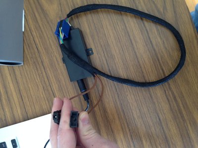

I purchased the OEM iPod adapter. I tried fitting it to my RNS-E but I wasn't sure what to do with the two brown wires in the wire bundle. I'm looking for some guidance as the instructions were not very helpful.

Wire colours are not a good guide to their function as they get changed, knowing which pins they are attached to is the important thing. Can you trace them back?CaptainLF wrote:I purchased the OEM iPod adapter. I tried fitting it to my RNS-E but I wasn't sure what to do with the two brown wires in the wire bundle. I'm looking for some guidance as the instructions were not very helpful.

I have attached the pictures. The wire harness is wrapped so I'm not sure if I can answer your pin question. LMK if the pictures help or if you need more info.

Really difficult to tell from those pictures, but one of them appears to show them being plugged together?
Would be good if you (or someone) could find and post a link to a pdf of the installation instructions...
