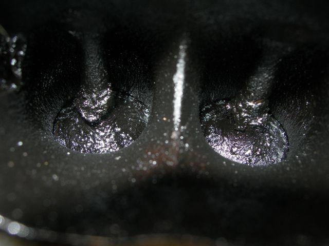

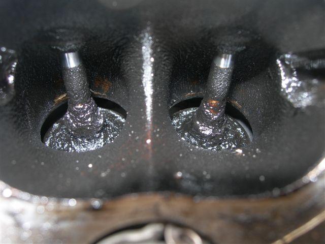

So, after reading Rob's write up (pippyrips 'v' MRC), I bit the bullet and decided to go for the same, which was intake manifold removed and cleaned, ITG filter, No-cat downpipes and Milltek non-res, non-valve and re-map.
Milltek had a bit of a mix up on the pipe so I had to go the resonated route if I wanted my car completed in one visit.
Result? Well, firstly I'm glad I went the resonated route; I think non-res would be just a bit too much. Res is plenty loud for me thanks!
After driving it back from MRC, all I can say is christ almighty, it's like a different car. It feels so much more alive and powerful and the noise...oh, the noise, what a lovely sound.
MRC fitted new plugs and did an oil/filter change as well (I supplied oil/filter).
The carbon/oil deposits were bad as you'll see in the pics below. :(
Rob is due to take his car back in to have the intake manifold removed to see how much it has built up since it was cleaned. MRC know what is causing the problem and will hopefully have the solution to it soon'ish :D

Pleased for you .. the valves don't look too bad ... best get some wynn's to keep them that way .. welcome to the 414 club ... I am not a member yet ....

Interestingly, I'd already added Wynns about 2-3 weeks before the work was done - hmm, look at the difference it made! BTW - car had 20,000mls on the clock.
