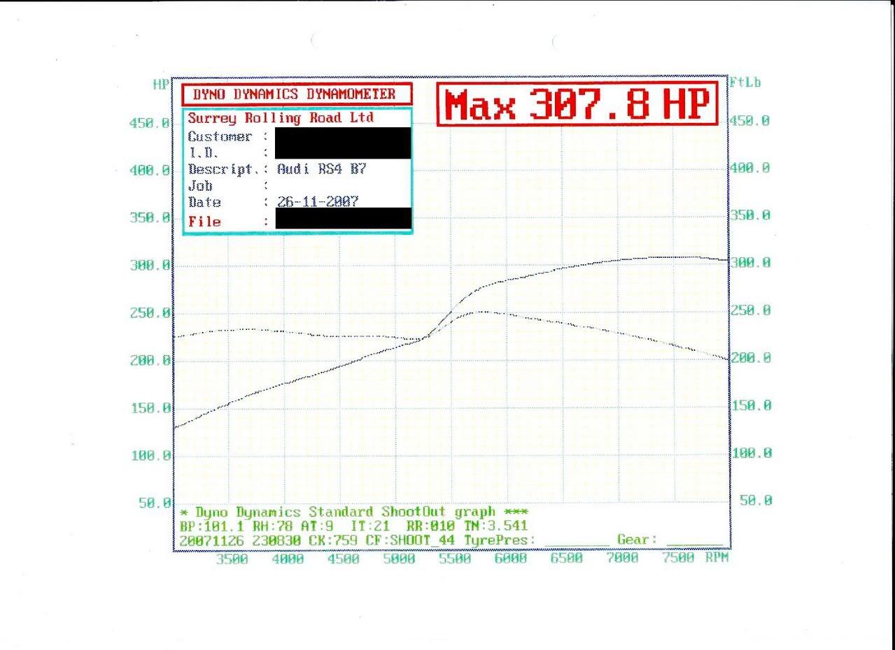

Hi everyone,
As promised, my dyno results below. My car is a March '06 completely STANDARD saloon with 21,800 miles. Service due in 3200 miles (last one at 15,500 miles). Runs were on optimax and 3rd gear to begin with and finally a couple in 4th gear but it seems it had got too hot by that stage with evidence of the ECU retarding the timing at the top end.
Thank you to Charlie at surrey rolling road who was very helpful and honest about the entire thing. He said mine was the first B7 RS4 he had done with more than 20k miles and so far also the first with figures reasonably close to manufacturer stated figures.

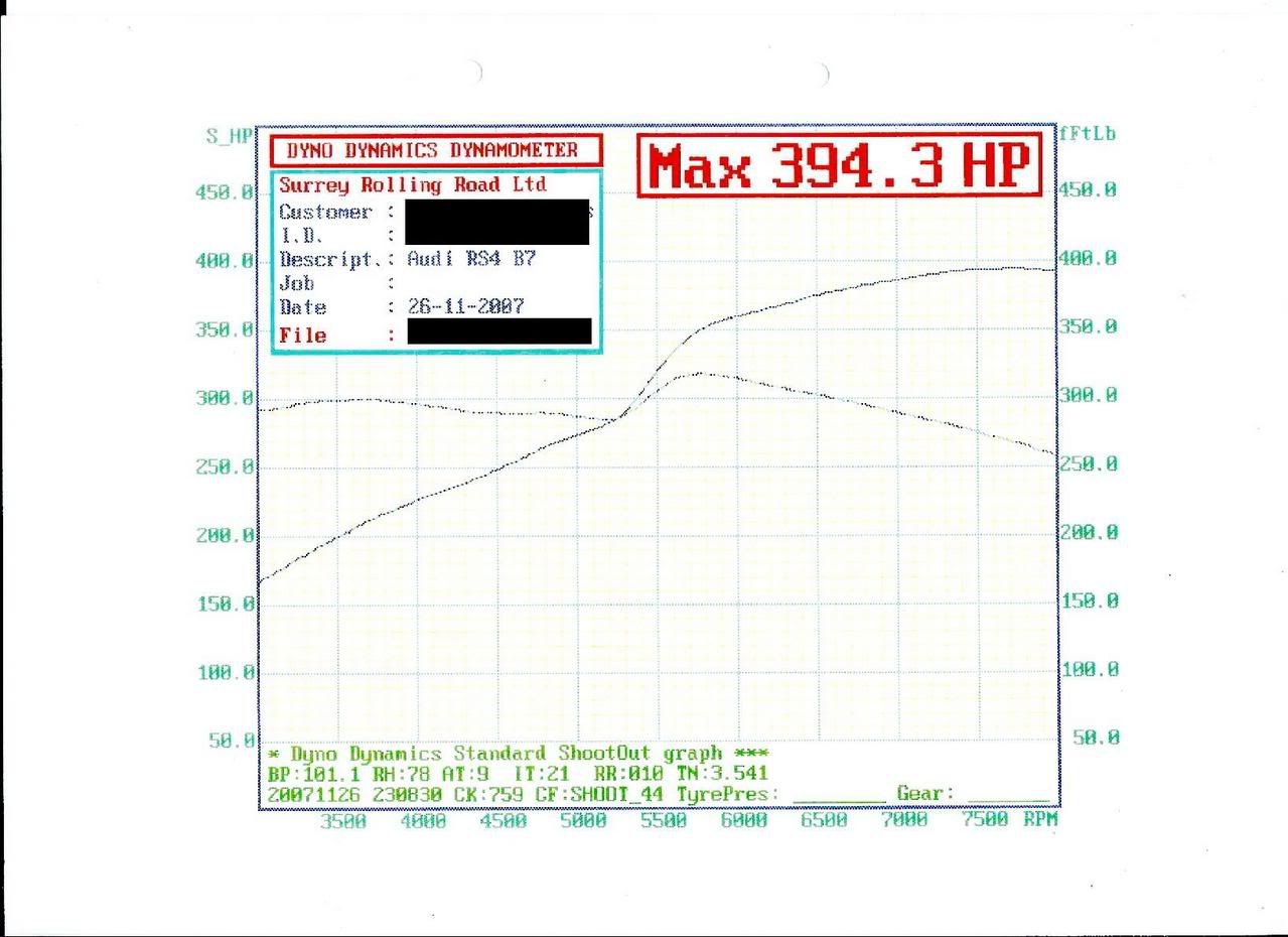

Just to clarify, the flywheel bhp figures are calculated using a 22% transmission loss. If you were to use a higher percentage as has often been mentioned for audi RS cars (anywhere between 24-30%), the flywheel bhp figures would look even more impressive. However, I'd mainly like to focus on the at-the-wheels figures as there won't be the issue of guessing the transmission losses.
1st graph - HP vs torque at the wheels
2nd graph - HP vs torque at the flywheel

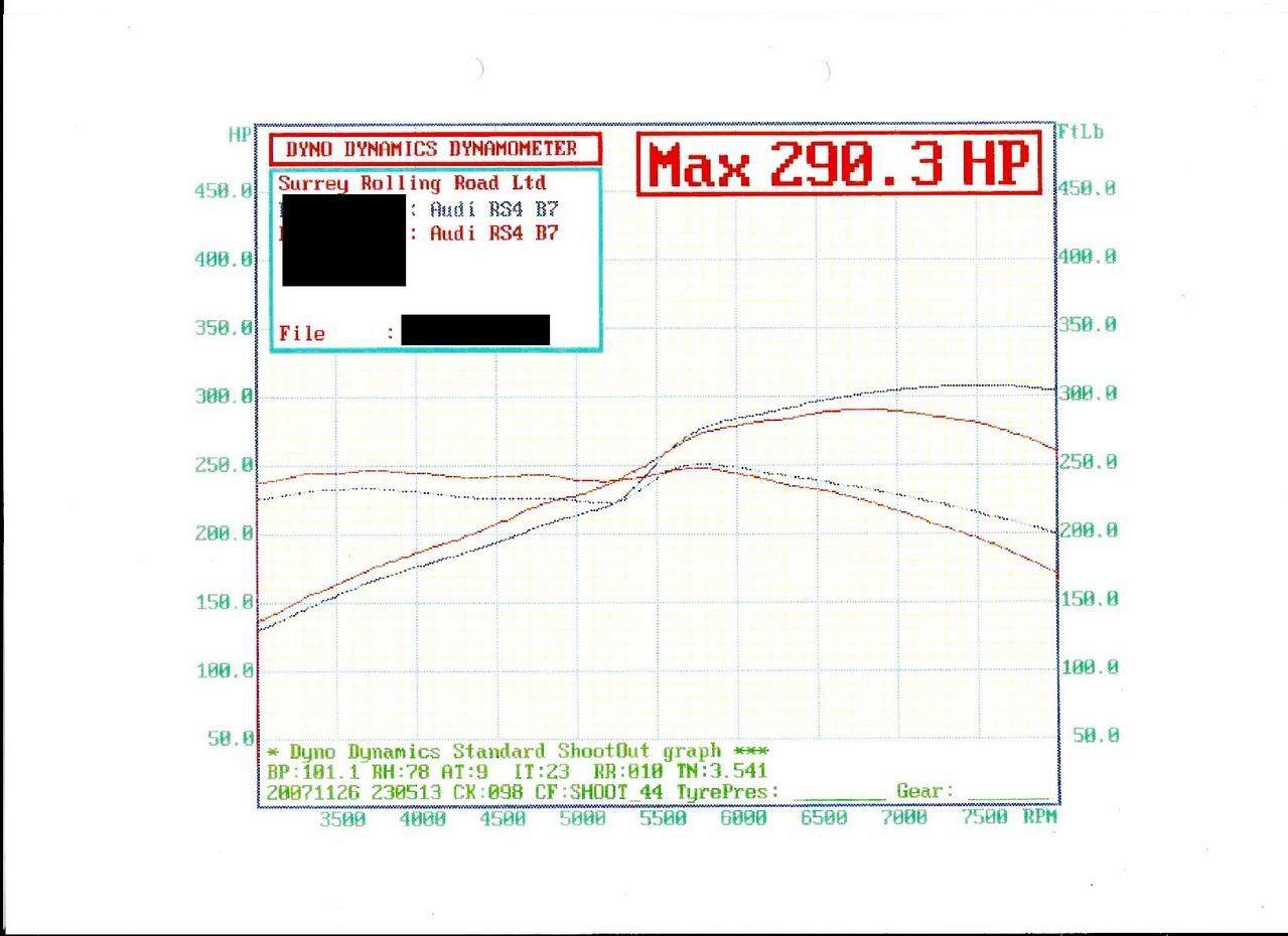

4th graph - 3rd vs 4th gear comparison (red line = 4th gear, blue line = 3rd gear). By the time we got to do the 4th gear run, the car had become quite hot and it is likely the ECU retarded timing above 6,700 rpm where power drops off quite quickly (compared with the 3rd gear run which shows peak power pretty much bang on at 7,800 rpm). 4th gear WHP figure was 290.3 on this less than optimal run.
One other interesting thing to note was that below 5,500 rpm, there is quite a bit more torque/power in 4th gear. I wonder whether this is consistent with what had been discussed previously. I.e. that thethrottle opens 100% in gears 4-6 throughout the rpm range, as opposed to only 60% throttle opening below 5,500 rpm in gears 1-3.

This is the same age and mileage of my RS4, are you happy with these results? I would be happy to at least see it over the 400 mark!

Hi SJ, I am fairly happy with it as I know that there are huge difficulties in calculating flywheel bhp figures from wheel horse power figures in 4WD cars. Noone can quite agree on the transmission losses of these cars (especially B7 RS4s). I wouldn't get too hung up on flywheel bhp figures. I would look at the wheel horse power and use that to compare to other people's results provided they were done on a similar dyno. As far as I'm concerned, anything close to or above 300 bhp AT THE WHEELS, is fine.
Had we used the 24% transmission loss today (instead of 22%), the headline figure on my graph would have been 405 bhp at the flywheel (or even higher had we used the max 30% which others use). I'm sure that after my service in 3k miles when the oil, air filter and spark plugs are changed, it will perform marginally better still.
The point is, it feels like a 400+ bhp car and its timed performance suggests this as well (as I have posted about previously). I don't really get hung up on dyno figures, but my main reason for doing this was the talk recently that RS4s are under-powered etc etc. I wanted to make sure my butt dyno wasn't way out ...and from what I saw today, it isn't.
These results have shown to me that my own car certainly isn't underpowered. I also really doubt that the majority of RS4s are underpowered, but I'm happy to add my results to all others collated on this site.

Funny, becasue isn't the torque figure up on quoted for the RS4? I thought it was 315 ft. lbs?

Hi P_G,
Quoted torque for the RS4 is 430 Nm or 317 lb ft. My figure is approximate on looking at the side of the graph as I don't have a printout of the gradations of the torque scale. It looks to be about 320 lb ft, in other words around the audi quoted figure.
Look forward to seeing your results. In order to achieve comparable data, could you ask Chris to use mode shoot_44 (+ any others he might recommend), as this seems a fairly standardised mode for the RS4.

Alex, you got some good figures there in 3rd gear.
Shame you did not have VAG-COM connected to log the timing retardation in the 4th gear run as i imagine it was pulling the timing a bit
like you say which could have caused the slightly lower figure rather than a slightly higher figure.
Your graph clearly shows the difference between 3rd and 4th where the throttle opens to 100% just after the 5k mark in 3rd but is already open in 4th.

Yeah it was a shame...I had the laptop and cable in the boot but I didn't think to plug it in and log the info. Next time I will. I did check the car before the runs at home and found no error codes (engine modules).
Next time, I will do the runs in 4th gear first. I was really interested to see the difference in power and torque below 5.5k rpm between 3rd and 4th gear. I think it was you who first noted it at JDE in Belgium if I remember correctly. It shows that there is potential to make the car a lot more responsive in gears 1-3 by eliminating this partial throttle opening effect. Quite why audi put this throttle opening restriction in 1st to 3rd under 5,500 rpm I don't know.

I dont really understand this rr stuff but I pressume that you are saying that the car looses aprox 22% through the wheels therefor in order to get to a quoted BHP of 414 the car should make 323 at the wheels.
At 25% loss ist should be 311
At 30% loss it should be 290
The bit Im not sure about is that presumably when you do a 4 wheel drive car how does the machine know what the different splits are ie; RS4 is 60:40 split and rear bias.
Are our cars variable in this split ala haldex system or are they fixed at 60:40?
There must be so many variables in the calcs.
