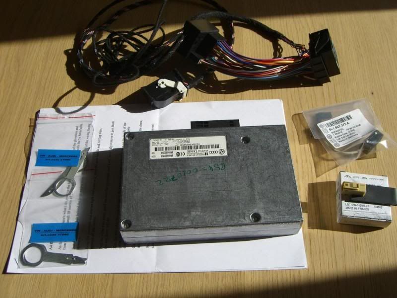

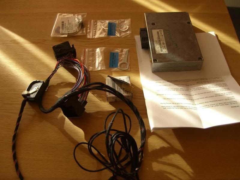

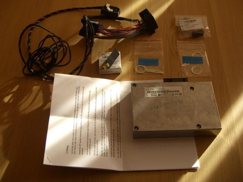

What arrived
Read instructions

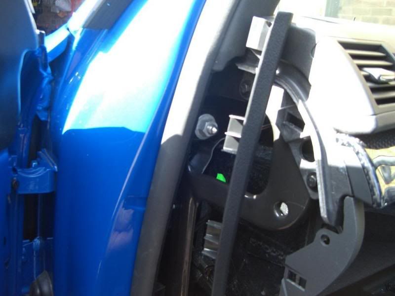

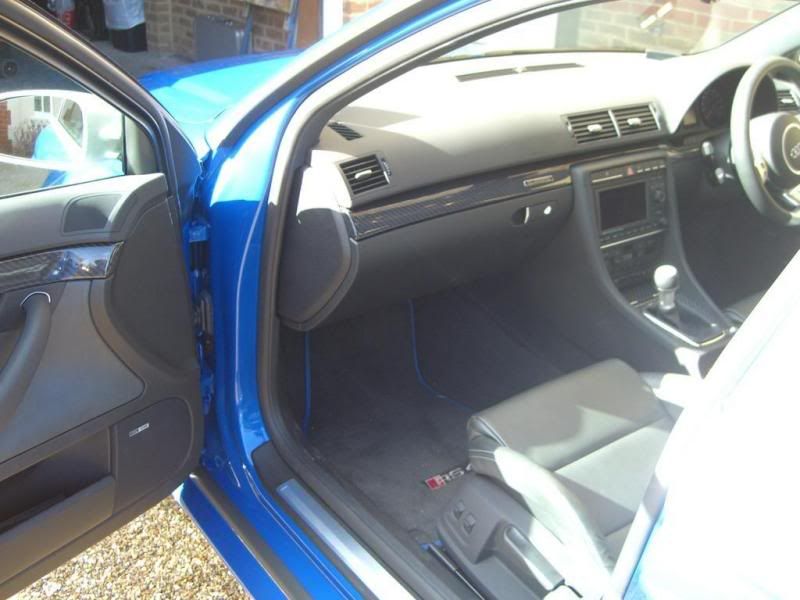

open the door
side trim off

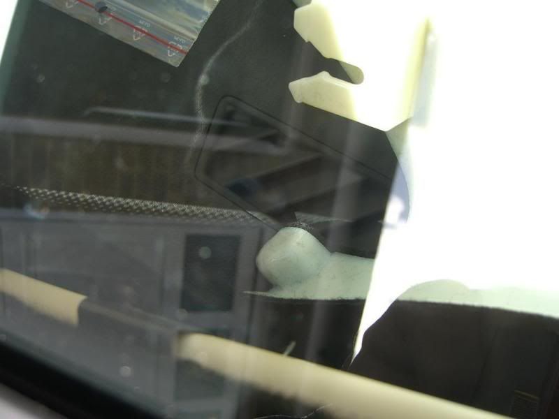

and this bit

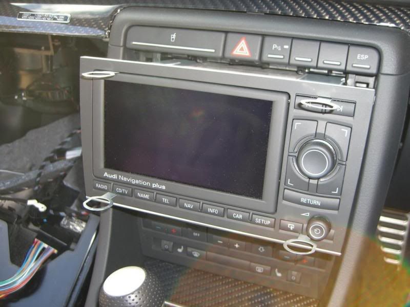

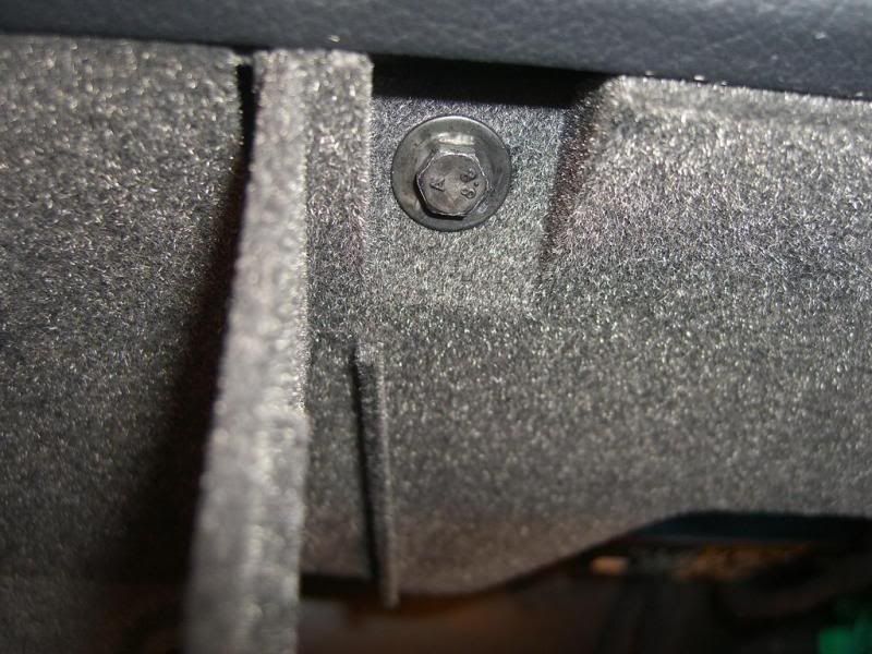

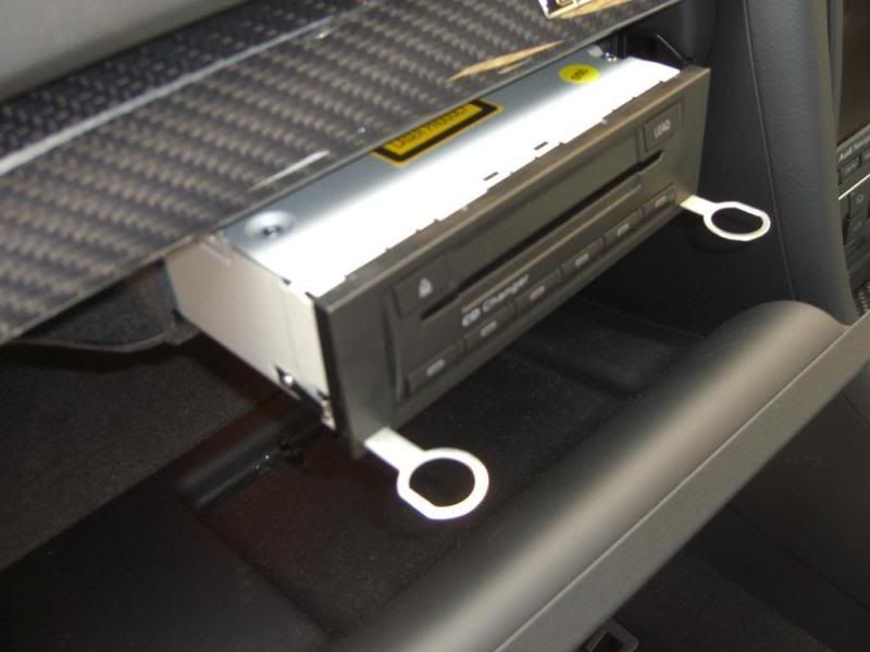

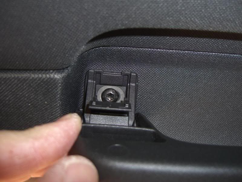

Use keys, note direction of keys .. I had no idea which way round they went

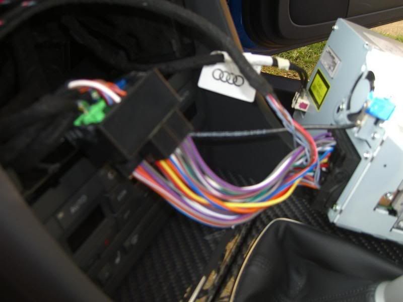

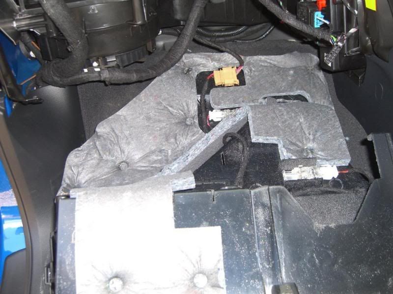

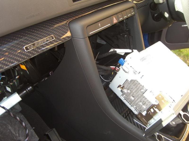

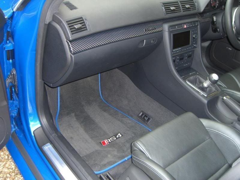

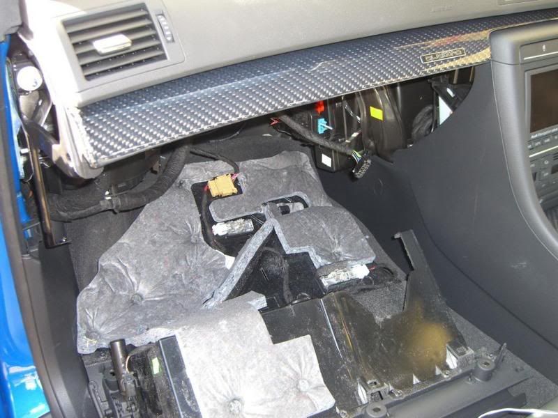

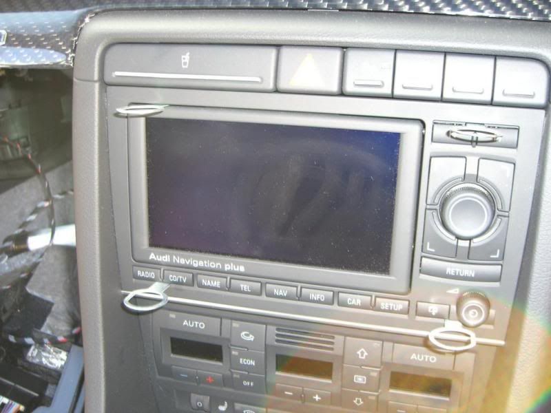

Remove CD changer plug

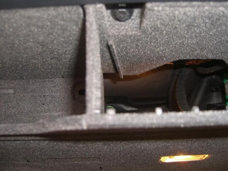

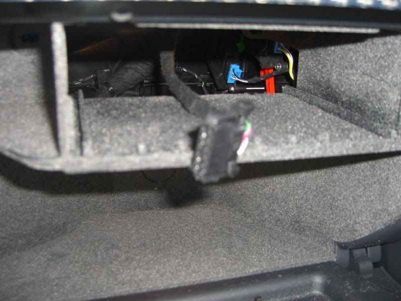

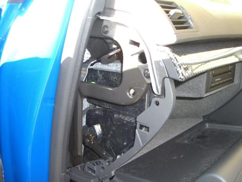

Don't forget to remove, to get glove box out
keys again, also puch from rear

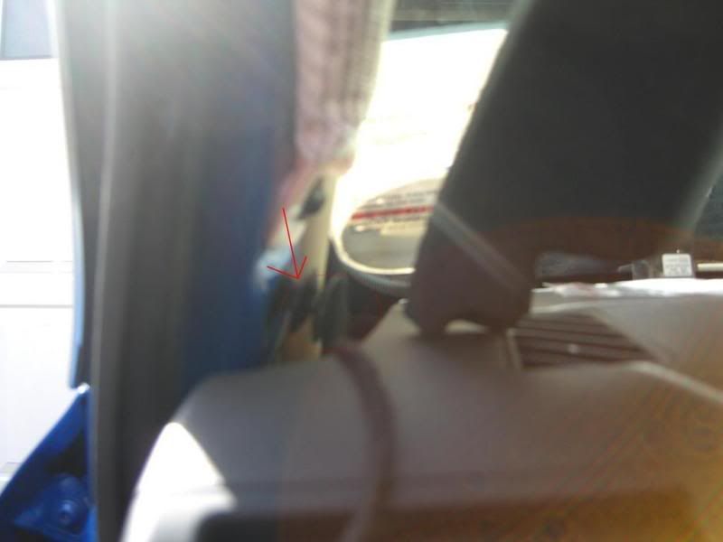

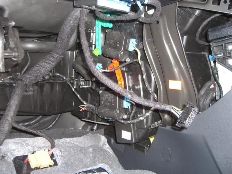

Now plug in cable

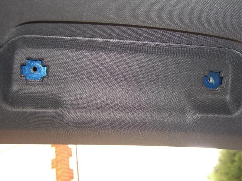

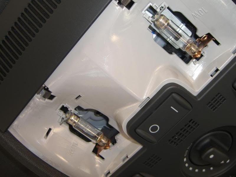

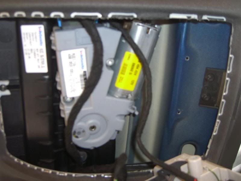

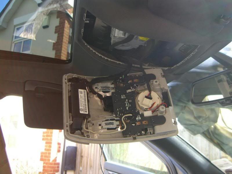

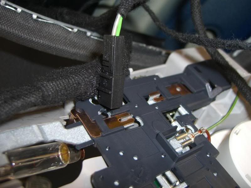

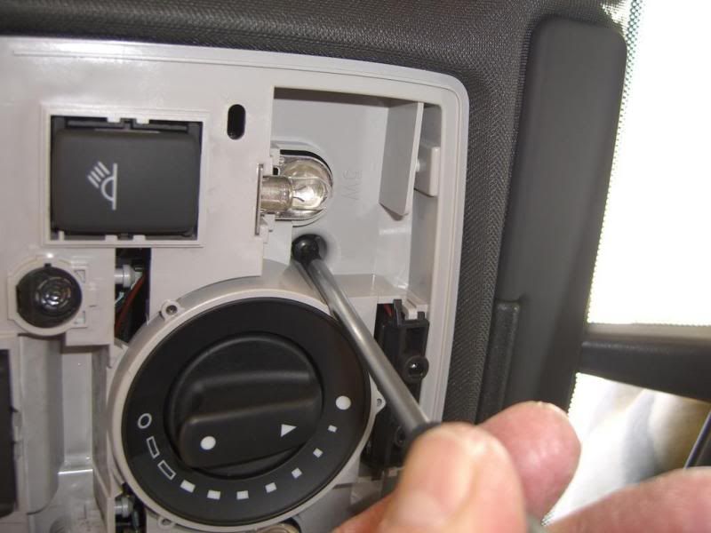

Sun visor light
Sun Visor

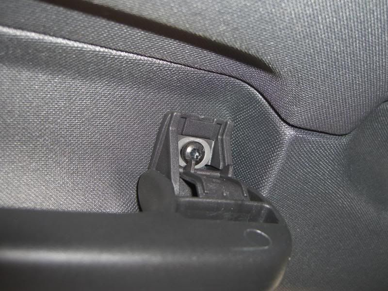

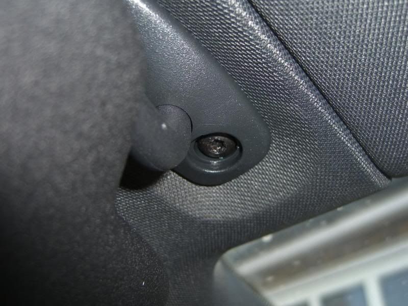

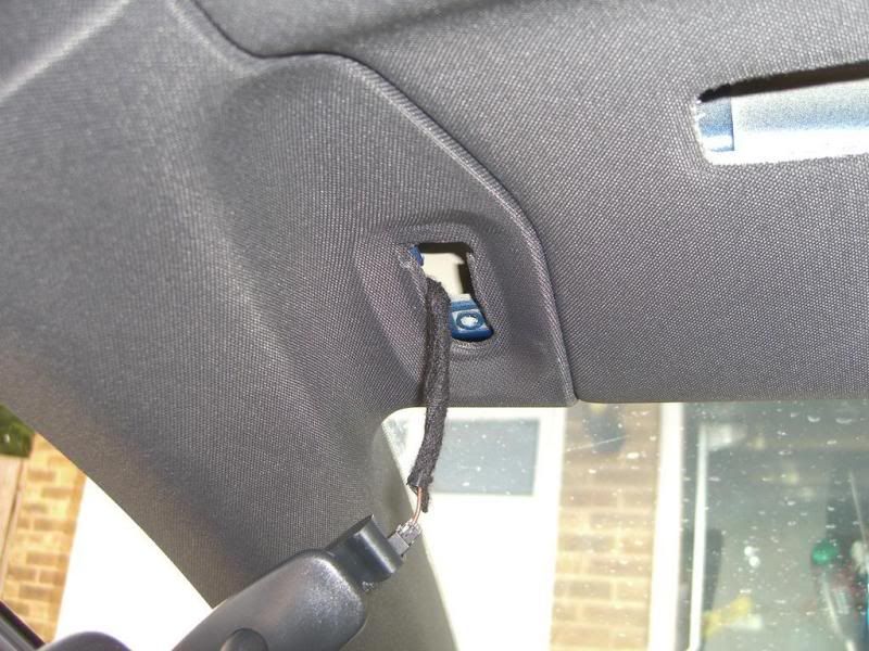

Grab handle

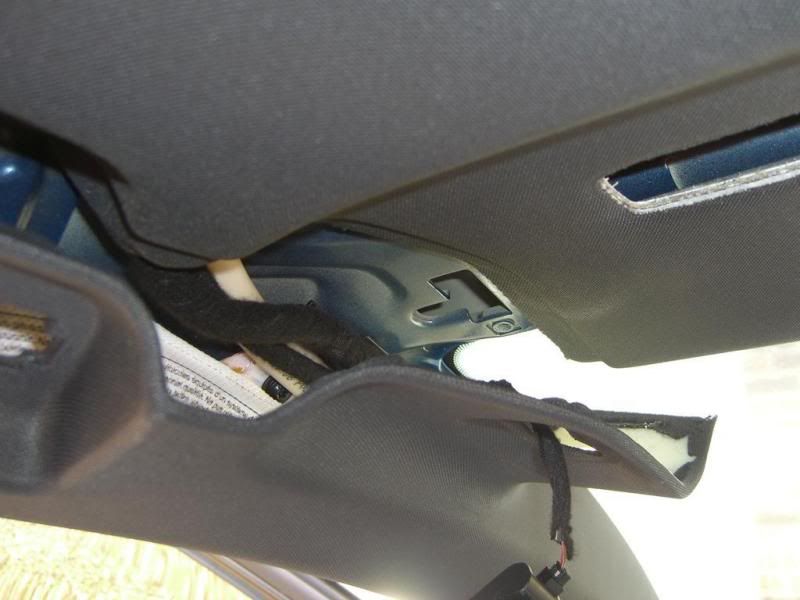

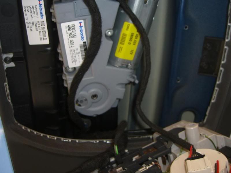

Trim off, I found hard to put back, so care needed

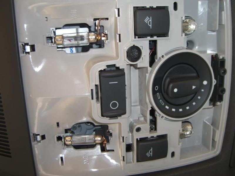

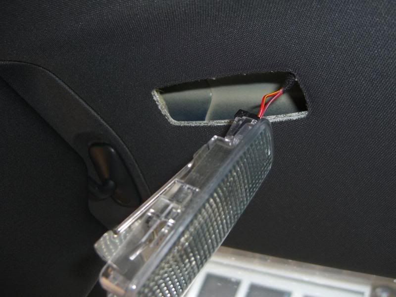

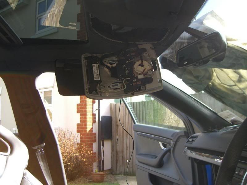

Centre light
Undo screws T20

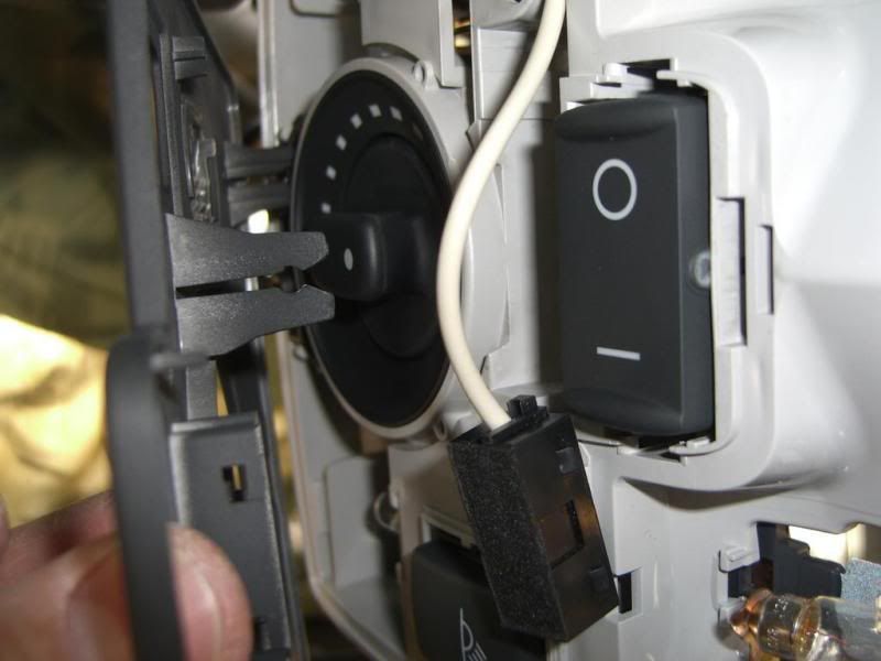

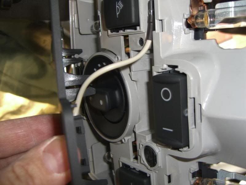

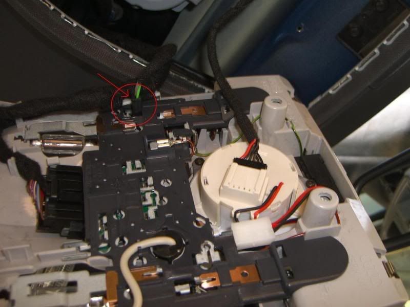

Put supplied mic in
I think I should have put in the other way round so mic lead runs to furthest point.

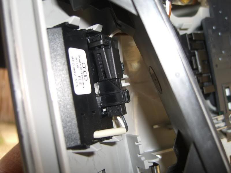

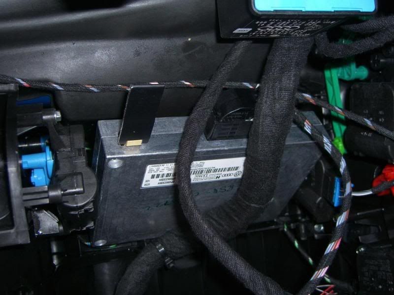

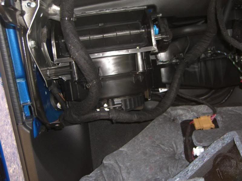

BT Module location

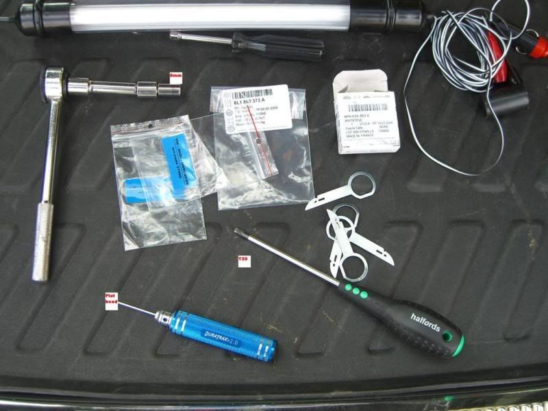

tools i used
Put back, LOL

Andy, this thread inspired me to put one in our RS4 Cab this afternoon so many thanks. Was surprised how relatively easy it was. Craig- one thing, you need to amend the instructions to say 6 x 8mm bolts- I was tugging for ages until I came back indoors and re read this thread about the hidden bolt!! My wife thought it rather amusing to watch me running backwards and forwards looking at your pictures!! Also, not sure if you knew but there was already a mic in the interior light of our car.

Yes, 6 bolts if you have a CD changer or a cabriolet, but the extra mic is because you have BOSE. So you will have 2 mics, one for the phone and one for the BOSE.
You will need the RNS-E VAGged to fix the message and also your cluster, PetrolDave is in Southampton, I'm sure he will recode them for you.
IanWest
Posts: 12
Joined: Sat Mar 24, 2007 5:02 pm
Post by IanWest » Sun Mar 25, 2007 8:41 pm
Ah, I disconnected the other mic, took it out and swapped it with the one that you supplied me. Should I reconnect it again? Why does the BOSE have a mic?
If anyone is thinking about doing this, I am no expert and I did it and Craig was very helpful with my questions pre delivery! Craig- many thanks for the speedy delivery as well, much appreciated.
craigyb
Posts: 412
Joined: Tue Aug 03, 2004 2:24 pm
Post by craigyb » Sun Mar 25, 2007 8:43 pm
Yes, you should put the old mic back and reconnect it or your BOSE system will be broken. It listens to cabin noise.

Sorry, I was out .. looks like Craig sorted you .. you can see the other mike. 6th picture from the end.. BTW you will love it once you have the Vag com thing done ..

The pics are great, but this car is a cabriolet that has two round mics in the lighting dome, one at each end, BOSE and TEL.
