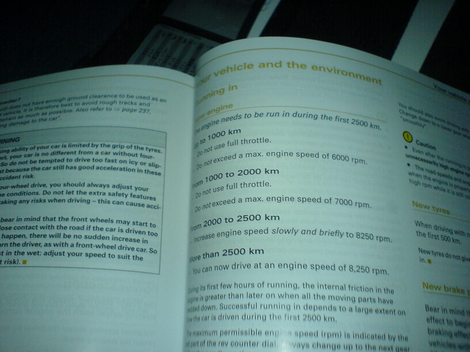

Audi Technical As follows:
0-1000 k/m No more than 1/3 Full throttle; No Top speed or high engine revs.
1000-1500 k/m slowly increase engine revs until 1500 k/m
For people with RS6 manuals; see your running in section; the B7 uses the same period.
The fuel flooding problem has been a very isolated problem; which you will only experience in extreme conditions. Taking your car to running temperature seems over kill; the engine management system is designed to control and restrict damage; so my advice would be the same as any performance car; go easy after first starts. Even more so during the first 1500 k/m

Must admit, we have not had any issues -- the cars have behaved perfectly normally even if only started for short period -- there is obviously an element of common sense involved with running any new vehicle, personally I would not use full throttle for 1,000 miles and limit even light throttle use to a max of 5,000 rpm.
I think the overfuel problem related to repeated cold starts without being driven -- so should be safe.
