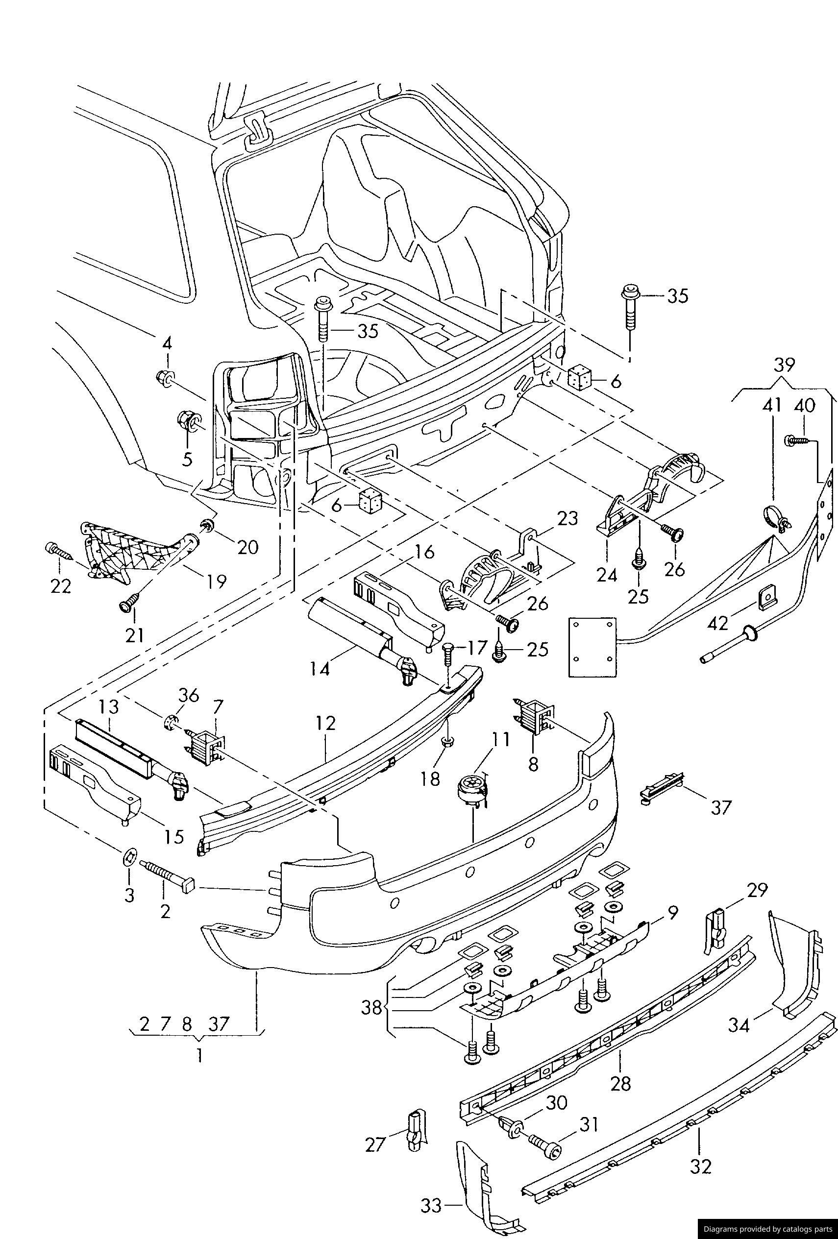

I did the above, swapped over my new parking sensors & all seemed good until I went to put in the last/bottom 3 screws underneath.
The bumper would swing under enough for the holes to line up.
On inspection there was a white mount hitting the crash bar. I loosen the bumper just enough to pull it out & to get the bumper back on.
Here's a picture of it. It's some sort of mount but I can't figure out how necessary it is. (I know Audi would have put it there for a reason). Anyone got any ideas if it is strictly necessary? I don't really fancy doing it all again as refitting the side panels was a pain in the arse!
Everything looks and seems fine but any thoughts appreciated.

Re: RS4 B7 Avant rear bumper & parking sensor
It's number 11 on that diagram
