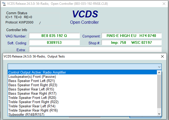

You can use VCDS to test the Output stages of ALL the Bose speakers, Under 56-Radio , Output Tests - (handy, and saves you the headache of ripping off the door-cards!) :

Nice one, hadn't thought of trying that route!
Will give it a try.
