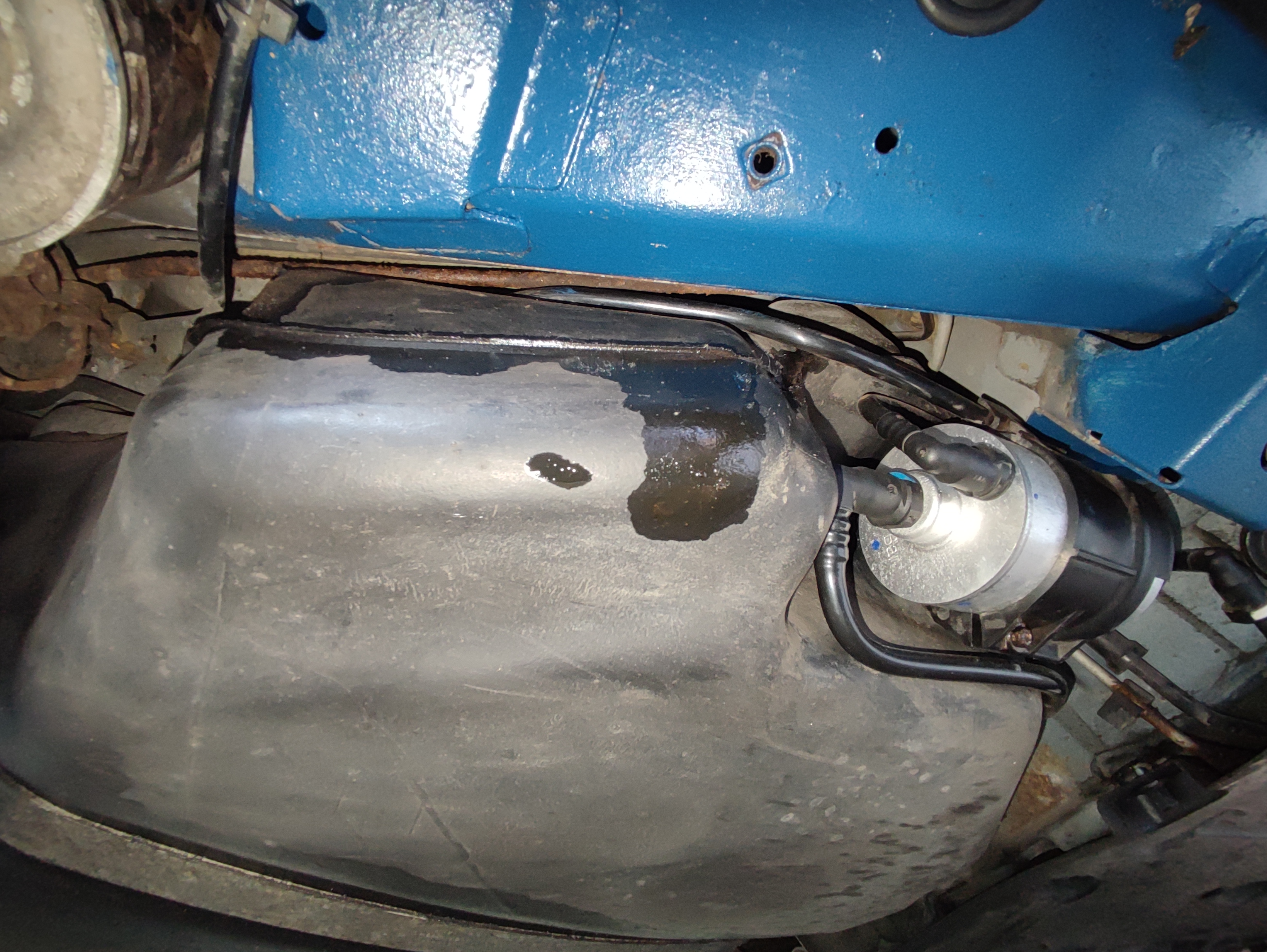

After replacing the leaky Factory DRC shocks .. I had another surprise when I recently went to replace the Fuel Filter:

At first I though sh** fuel tank is leaking.. but quickly realised it was the oil seeping from the DRC line - from above the upper left corner of the fuel tank.
You can see the totally rusted DRC line running above..
ok, so what's the best way to drain all the oil from the DRC lines ?
I would like to eventually remove everything DRC related, as all the lines look shot - when time permits.
Keeping the RS long-term and very unlikely I would ever return to DRC, knowing the issues, costs and maintenance involved.
