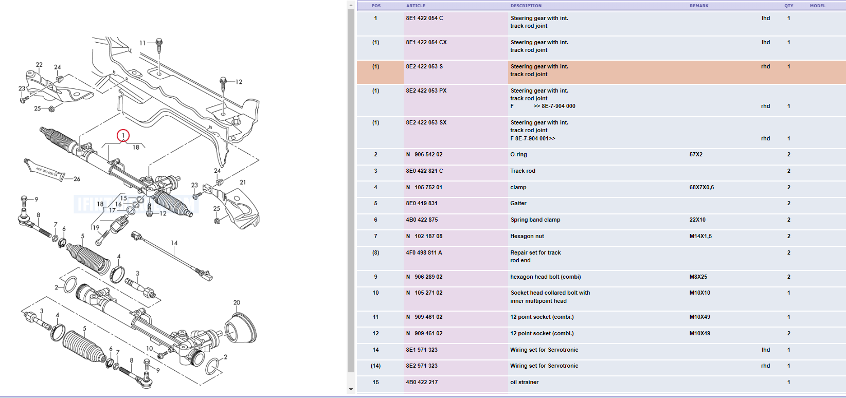

As far as I'm aware, there are 3x steering rack bolts - two on top, one underneath:
Think one is located underneath the ECU, under the plenum chamber / skuttle panel

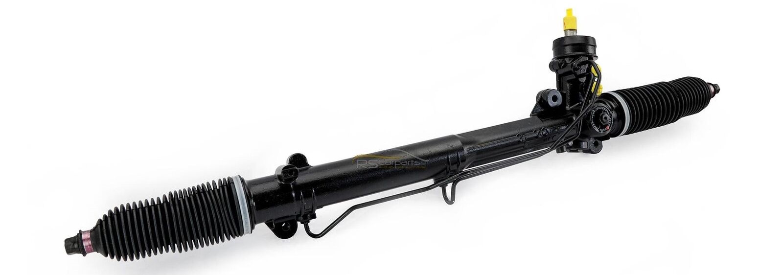

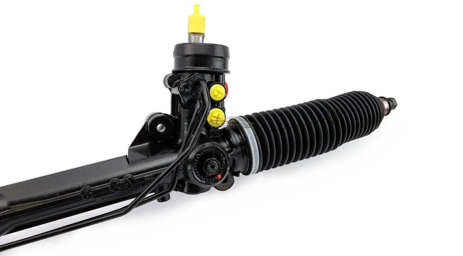

Well. I didn't know the RS Steering rack was adjustable.. that's interesting
Here's a close-up of that rack adjusting screw:
Let us know if any rack adjustments cures your knocking..

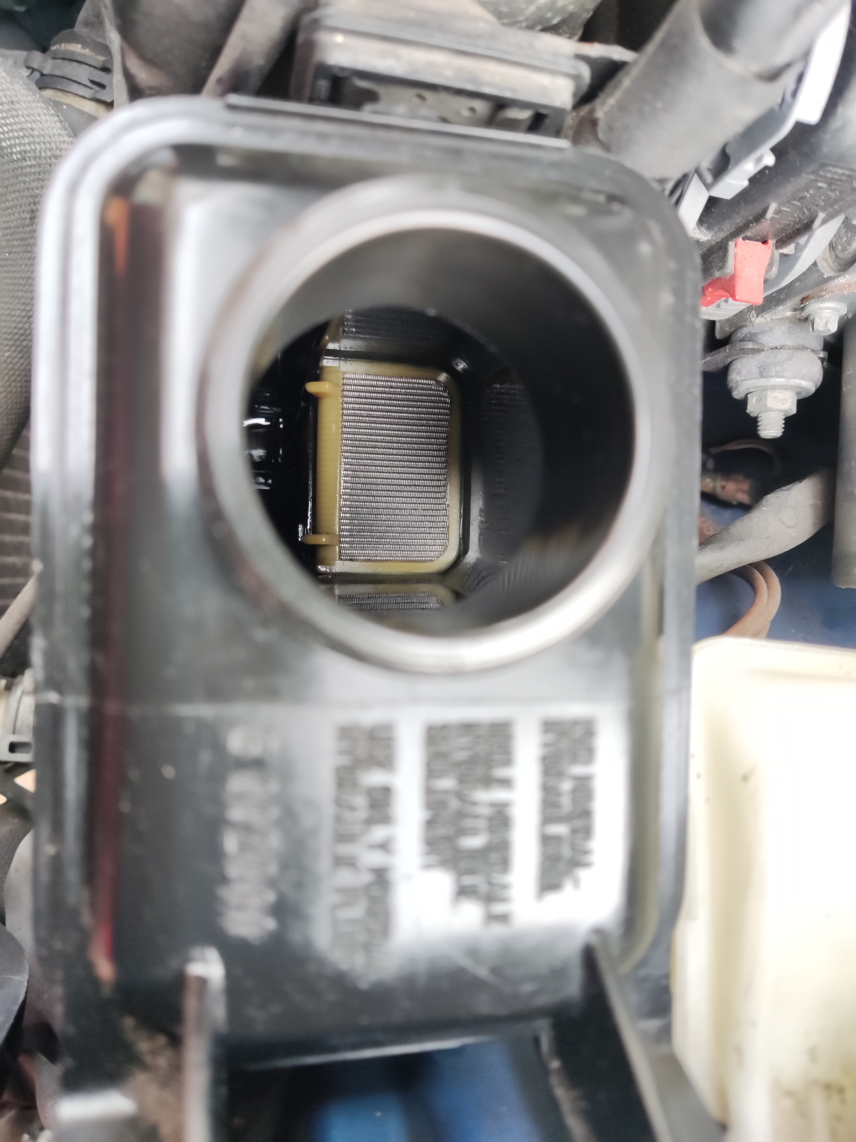

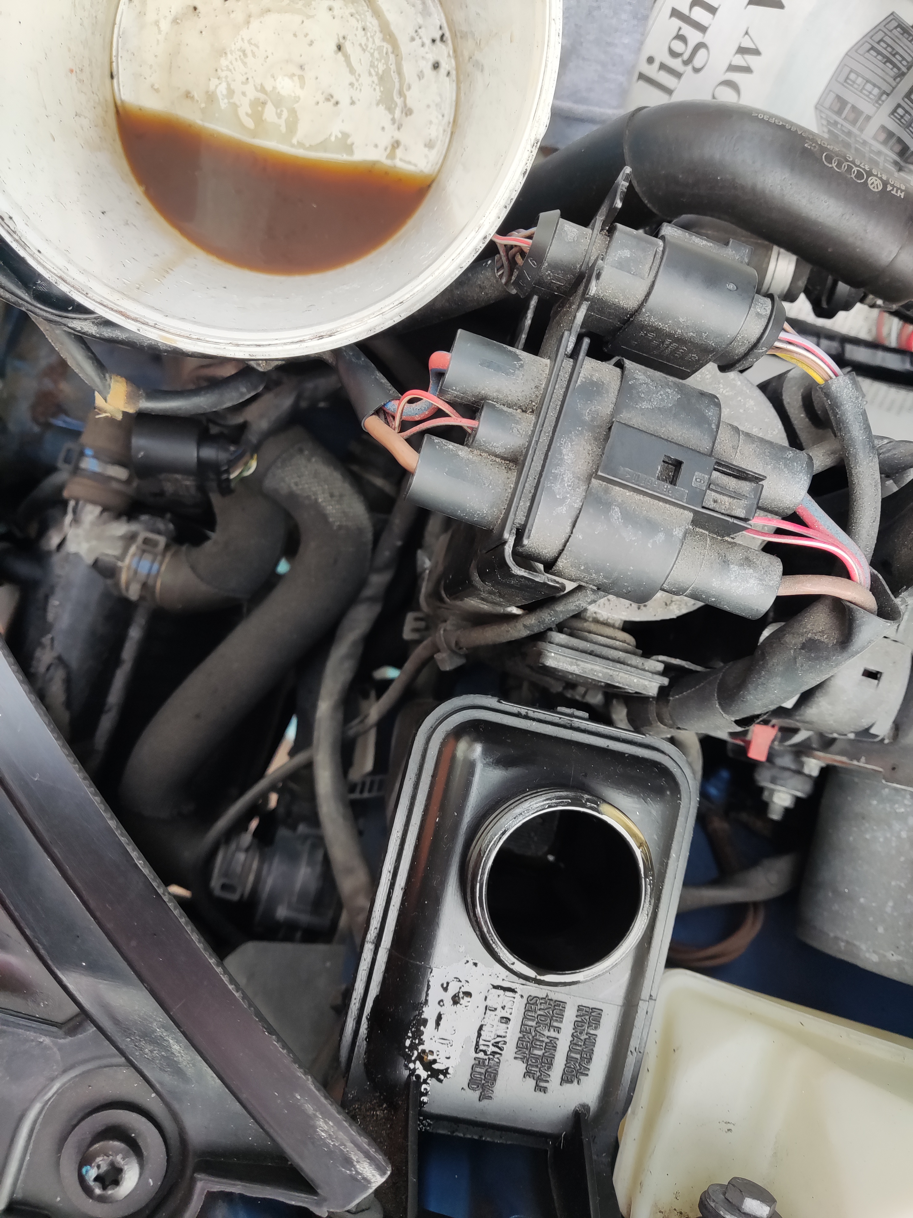

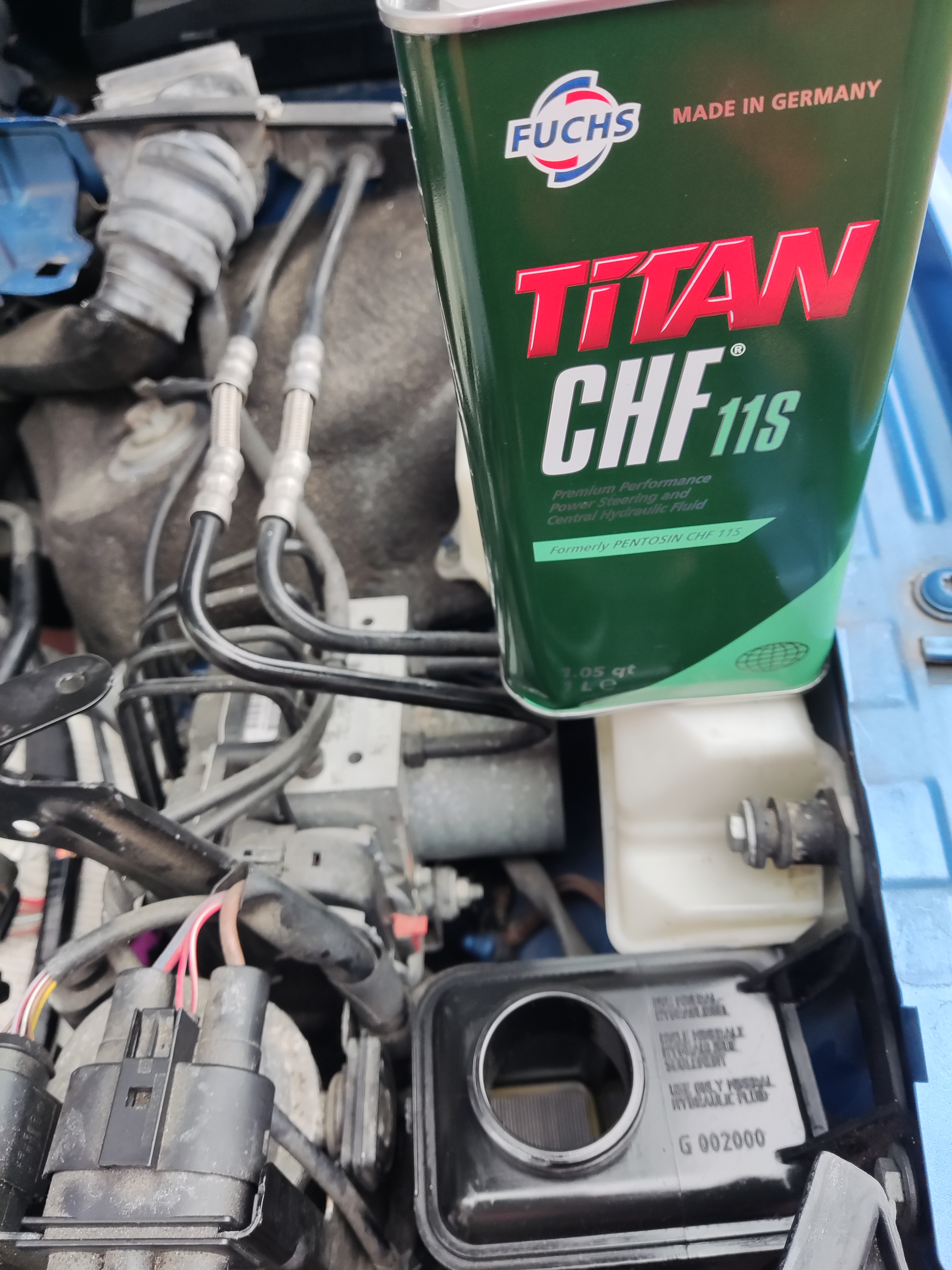

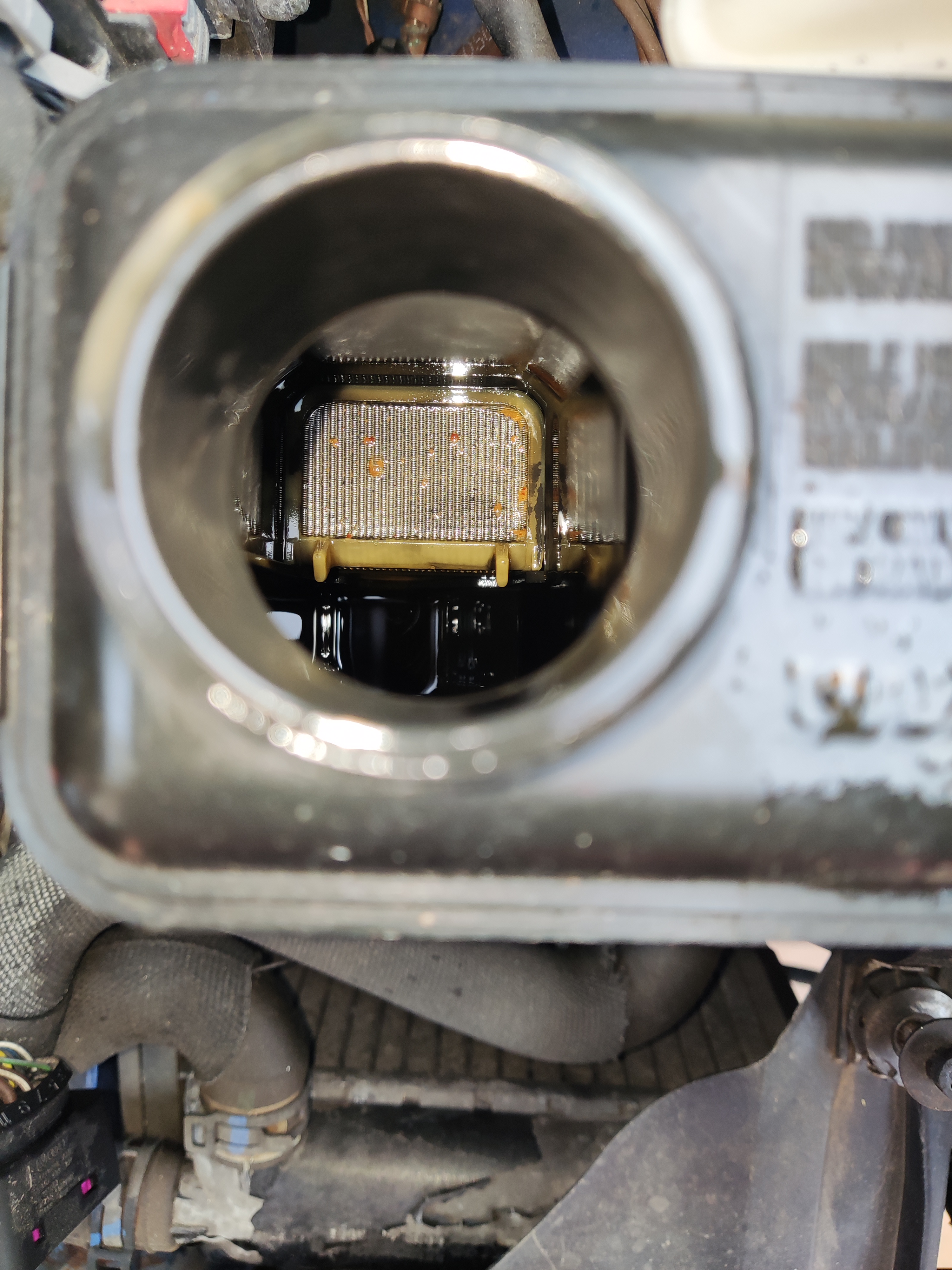

In terms of PS Fluid renew / flush, never found any drain plug as such - so you can either disconnect the hose from the bottom of the PS reservoir to drain - or syphon out all the old fluid, which is what I usually do.
Give the reservoir a good clean, and fill with new fluid. Then, purge the rack of any air / get rid of any air-locks by turning the wheels side to side - with the reservoir cap off and engine off. (easier to do when wheels are off the ground).
Do this a couple of times over a few years (or as you determine) .. to flush the system .. and you'll notice the difference in steering feel.

Thanks, i will have a go at adjustment over the weekend, having just replaced all the front suspension, its certainly the rack and driving yesteday i was reminided it's worse when cold.
May make sense if the rack/fluid warms up, its also right above the exhaust manifold so will get some heat off that, maybe something expands, who knows.
Not sure how easy it will be to access the adjuster, cant find any examples of anyone doing it on the B7 RS4.

I have done a write up here on how to flush the fluid out:
viewtopic.php?f=121&t=131868&start=30#p917323

I dont beleive the rack is knocking. Looking at DRC re-charge now.
The rack bolts were tight.
The knock i feel / hear rocking the wheel with engine off, goes away with engine running. But it was a concern. However our other VW car appears to do the same, so maybe a knock when rocking the wheel is normal without the power steering running?
