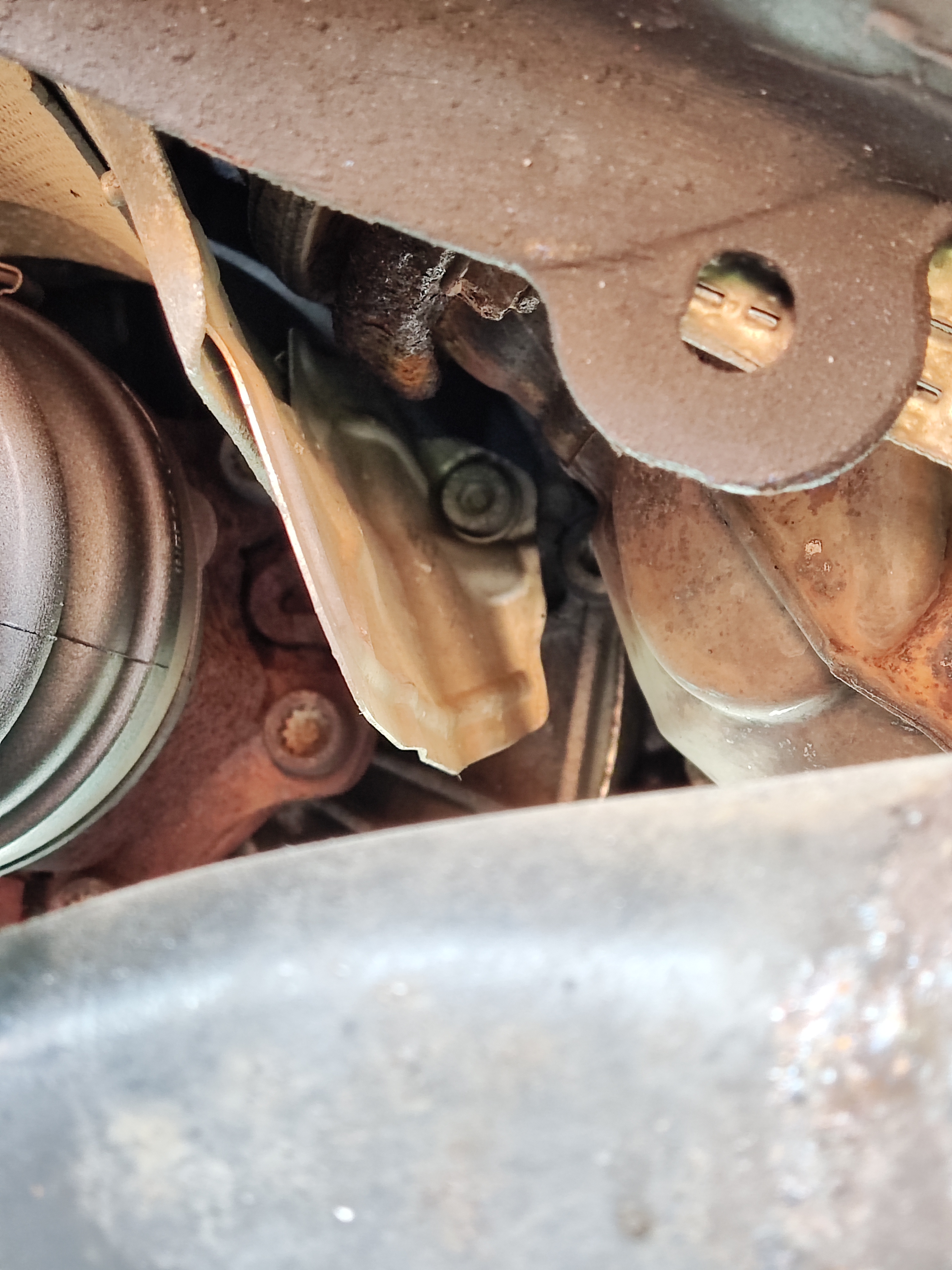

Post by lugars4 » Sun Apr 14, 2024 10:11 am

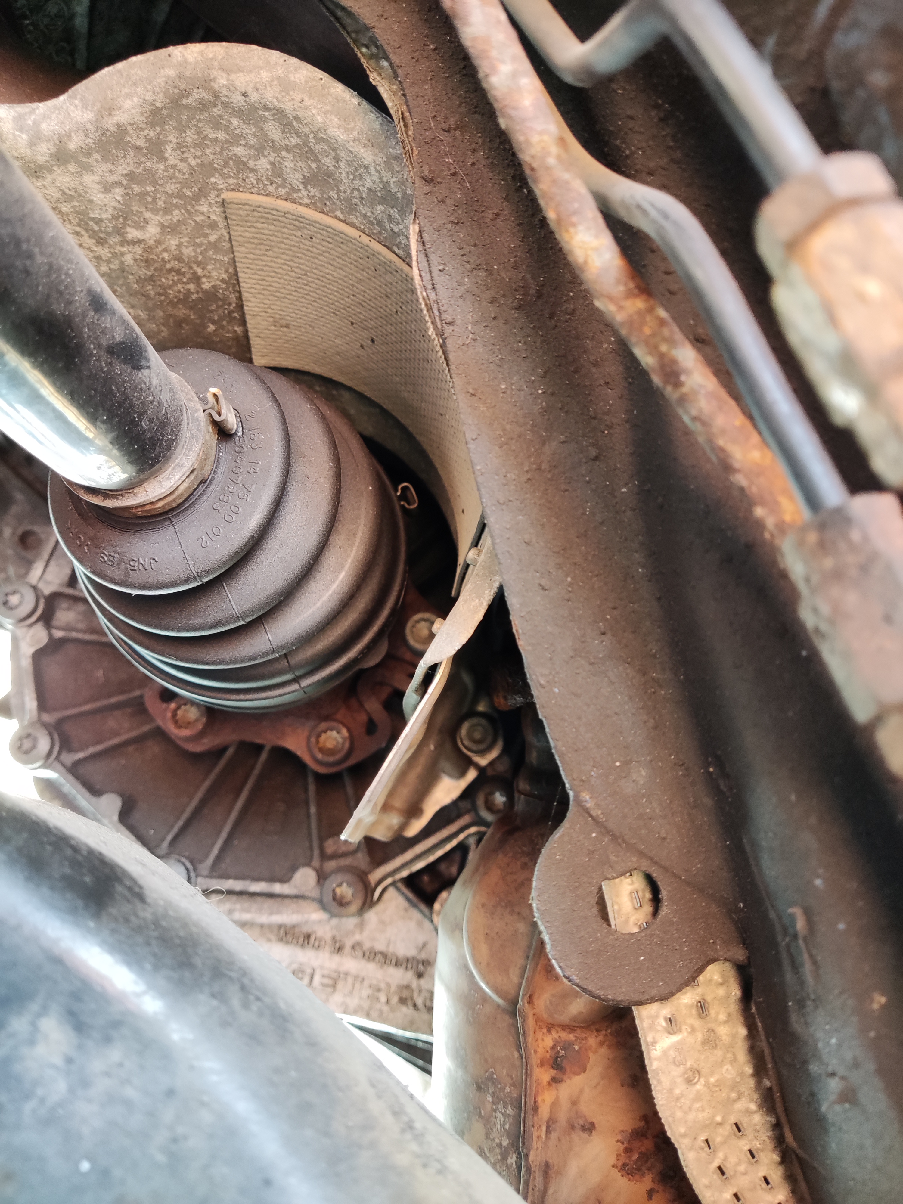

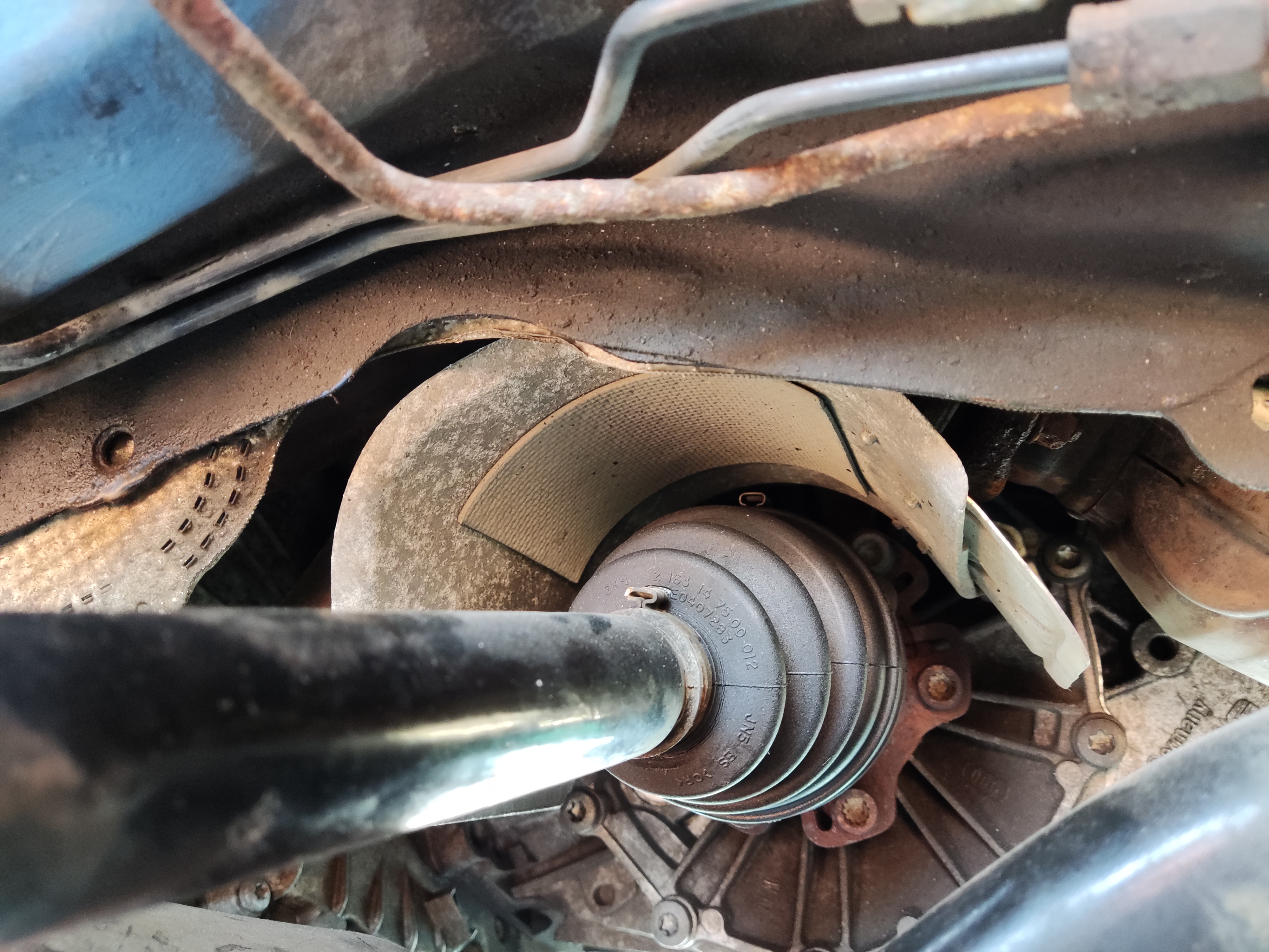

Not too bad so far, stopped for coffee.
Side bolts easy, with extension.
Rear:
Front:

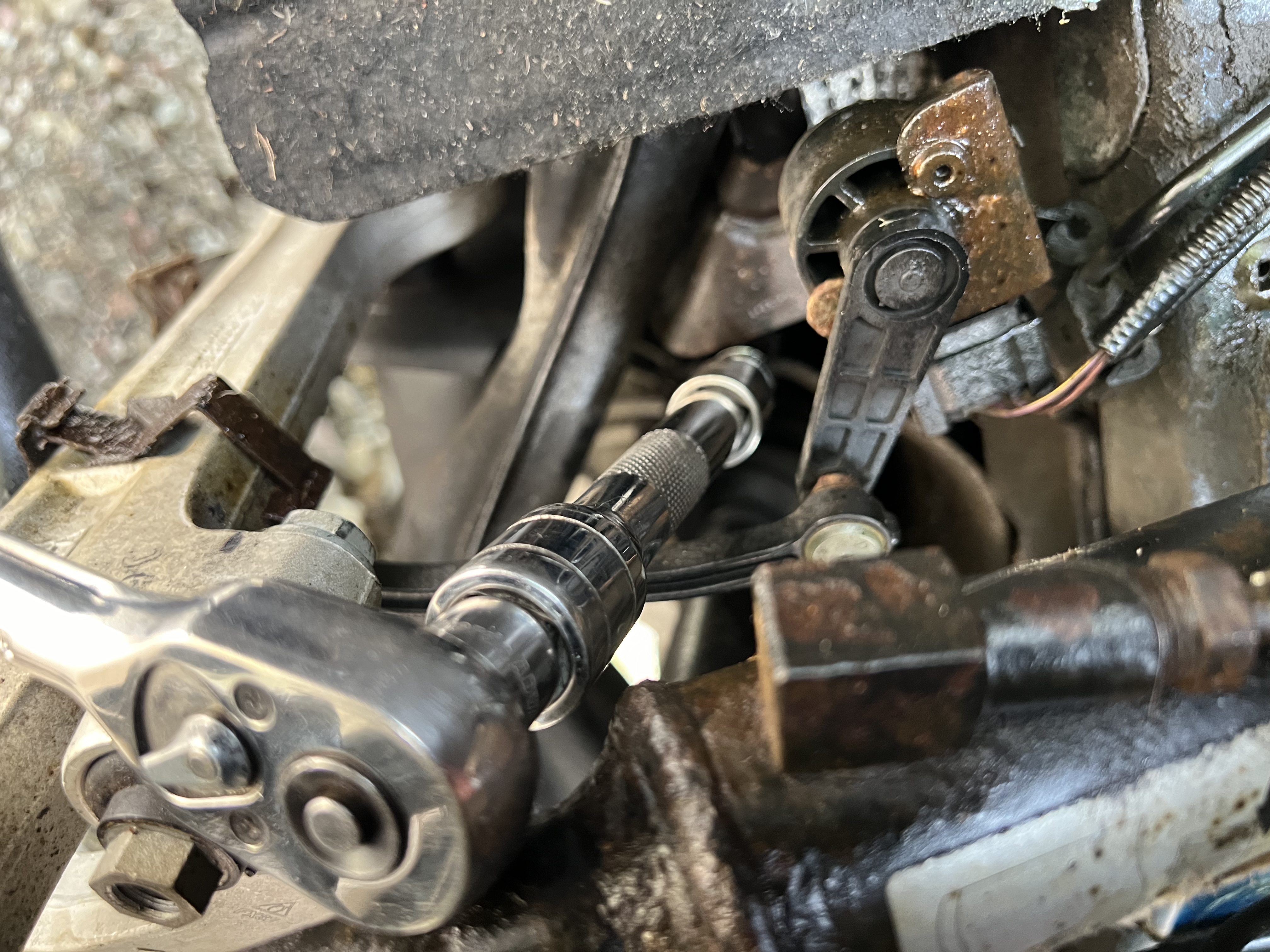

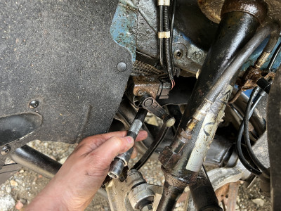

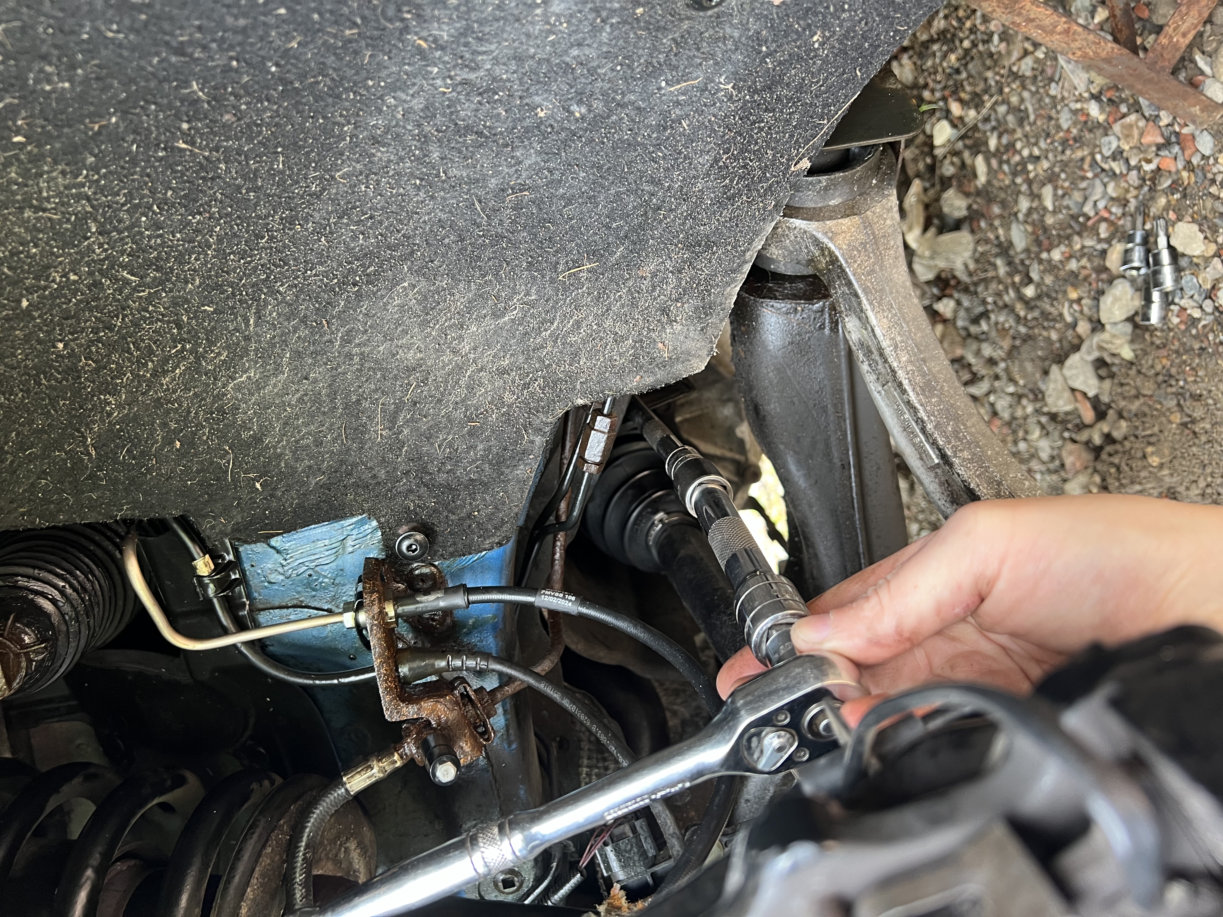

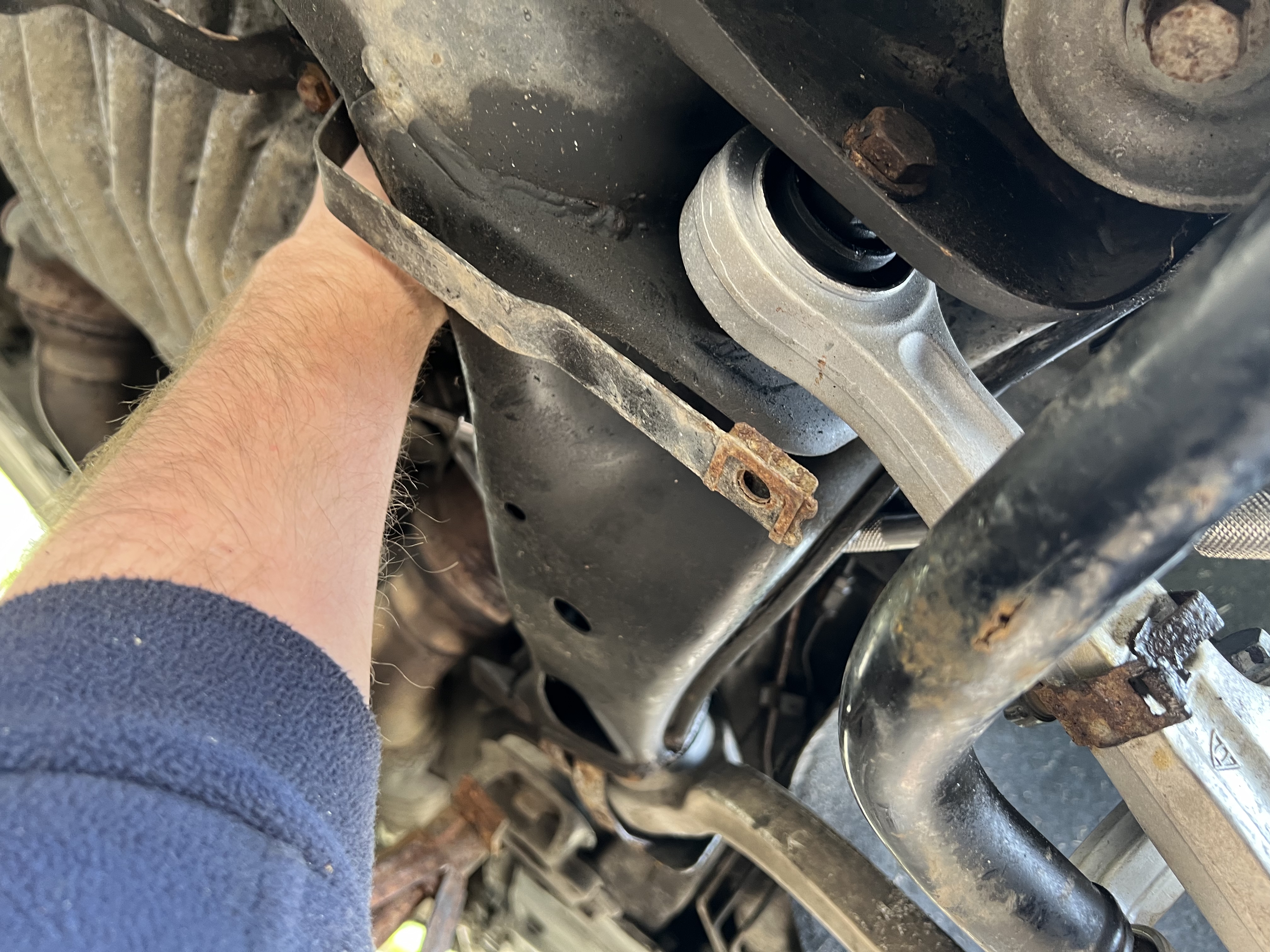

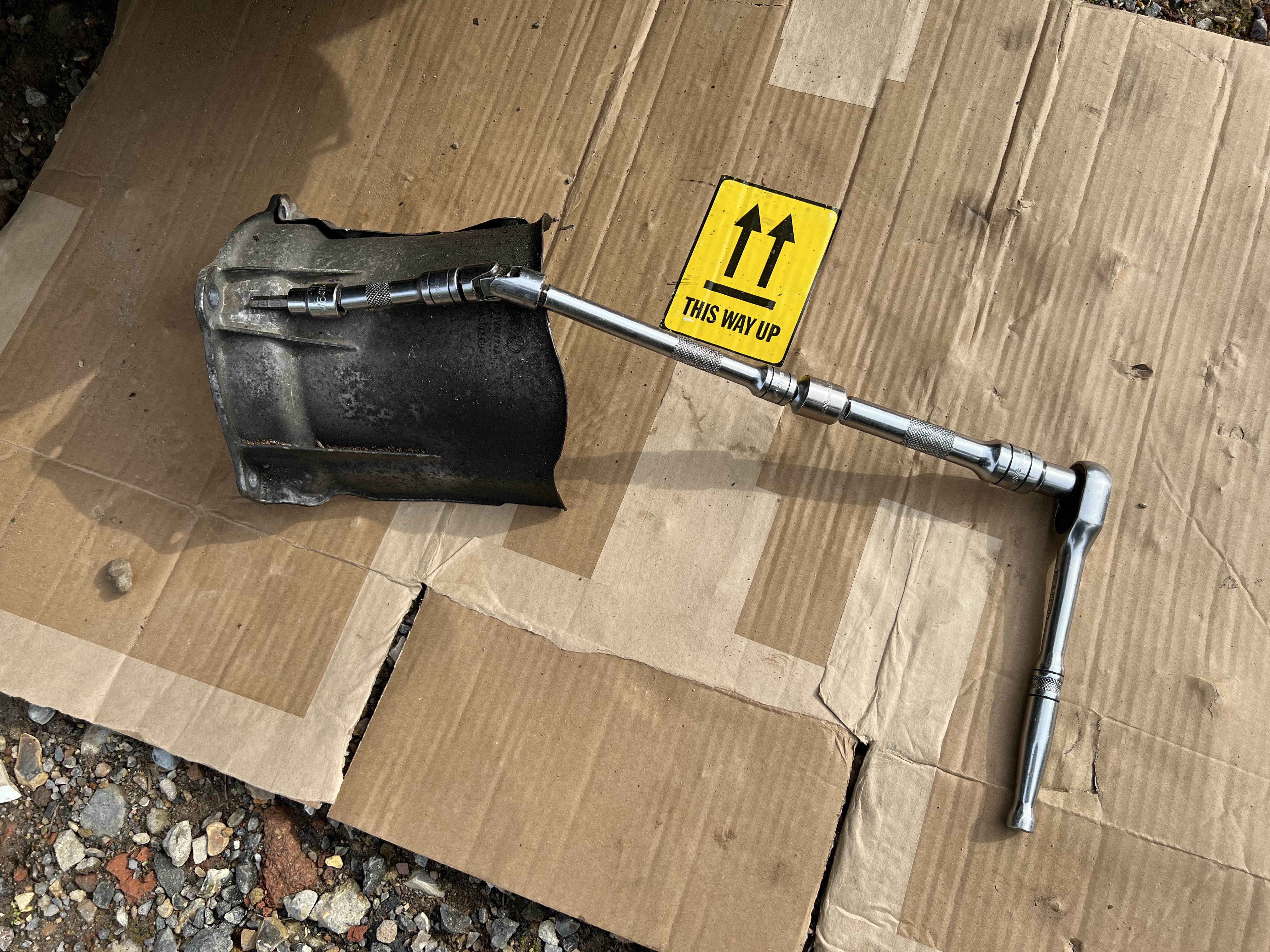

Top bolt, put your arm up fron the front to feel for it, dont bothewr trying to see it!, its a way back when your arm is uo there, then this extension arrangement from this arch position did it.
Position of the UJ on the extensions way key to success.
Took 15 mins without knowing where to start...
Can feel the bleed nipple. see how bleeding goes....

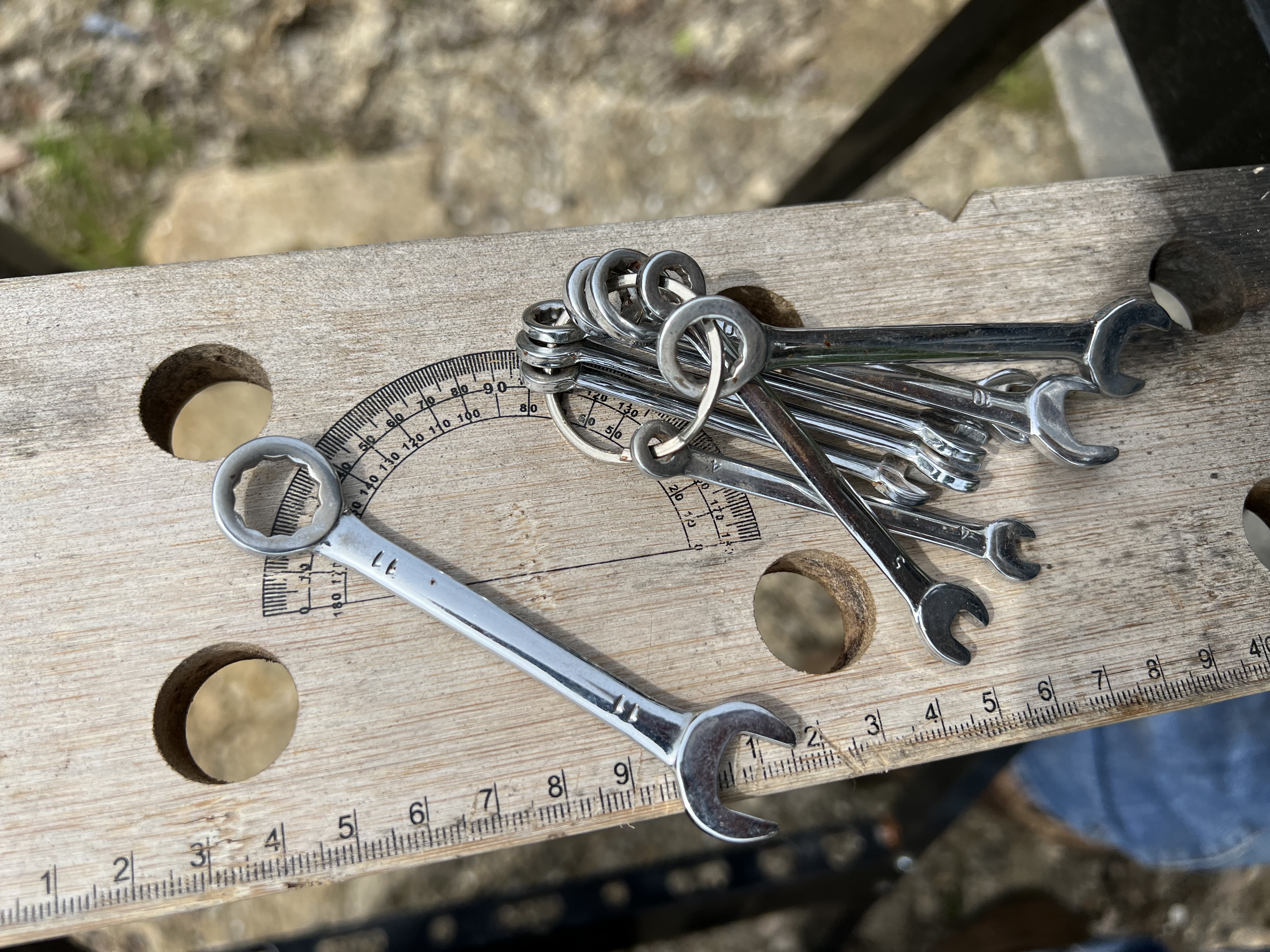

Not easy to access the bleed screw with a spanner. My only tip to anyone trying, use a small (slim) 9mm ring spanner.
Get your and in and feel for it, put spanner on from above to achieve swing.
Not easy at all, but possible. Too 90 mins to fliddle about and bleed it.
Example of spanner set i used. Its 9mm.

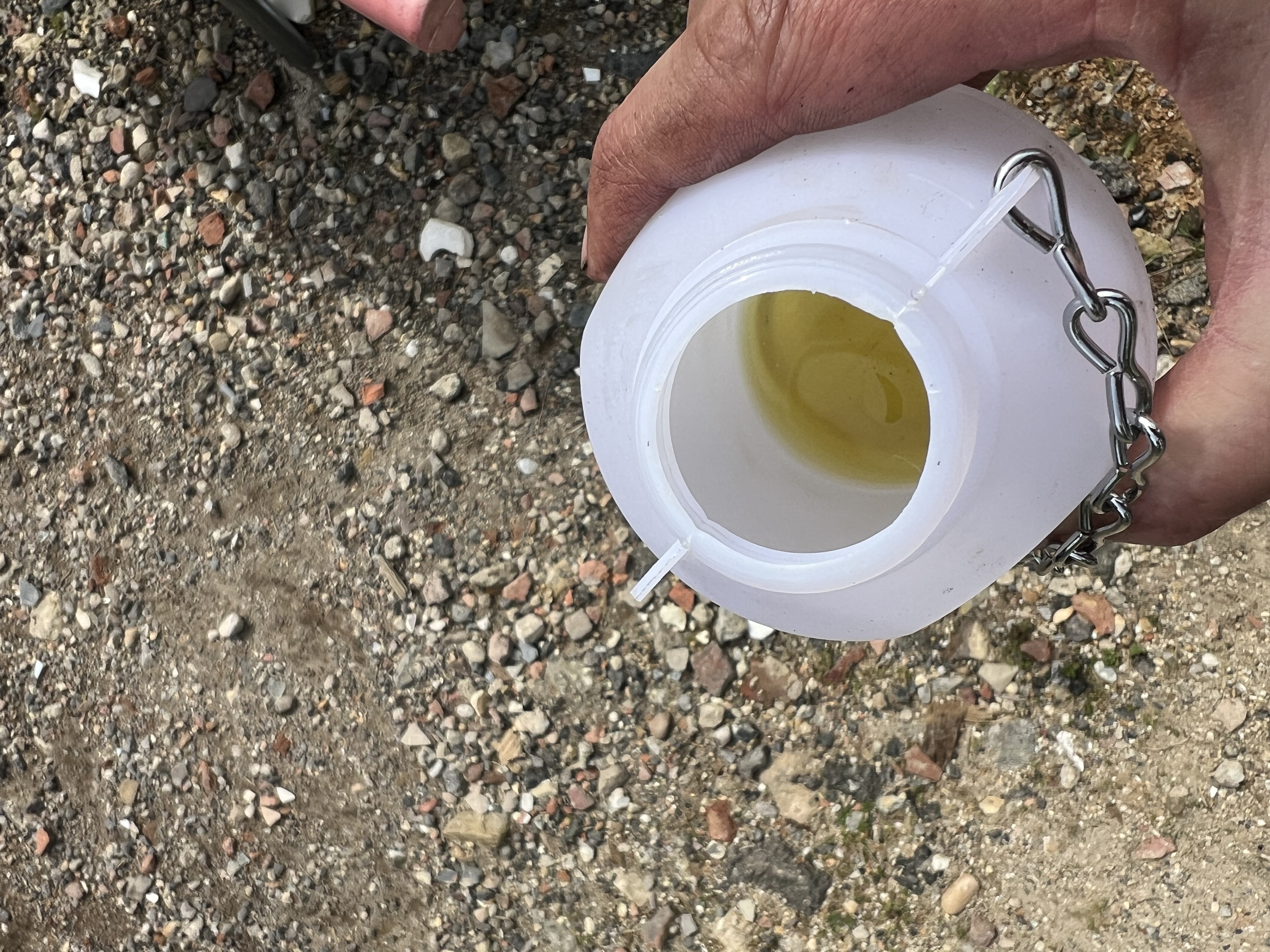

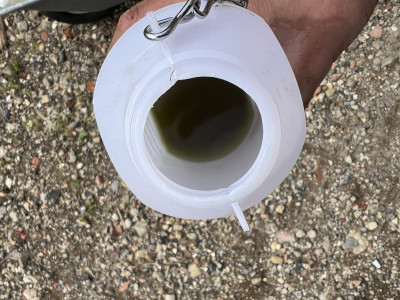

And worth it: Clutch fluid vs old brake fluid, certain Audi never bothered when asked to do a fluid change!!
