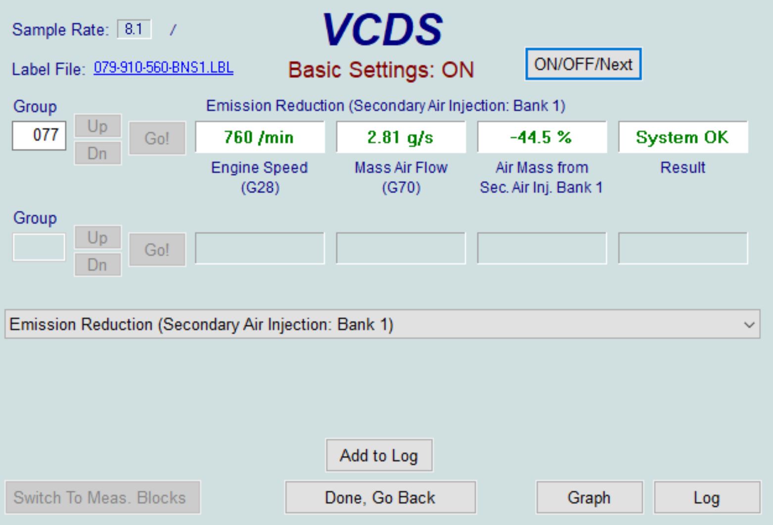

Posted: Thu Oct 17, 2024 3:09 pm
by lugars4
So update, i ran the output tests again and no apparent problems, pump runs and valves actuate ok, no sign of a leak issue.
Decided to run the readiness test in VCDS and both sides passed.....
As the codes are both sides, i am thinking intermittent fault. Relay, solenoid valve, etc?
