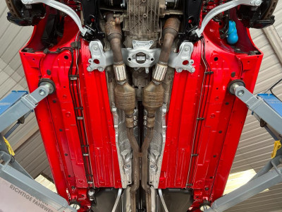

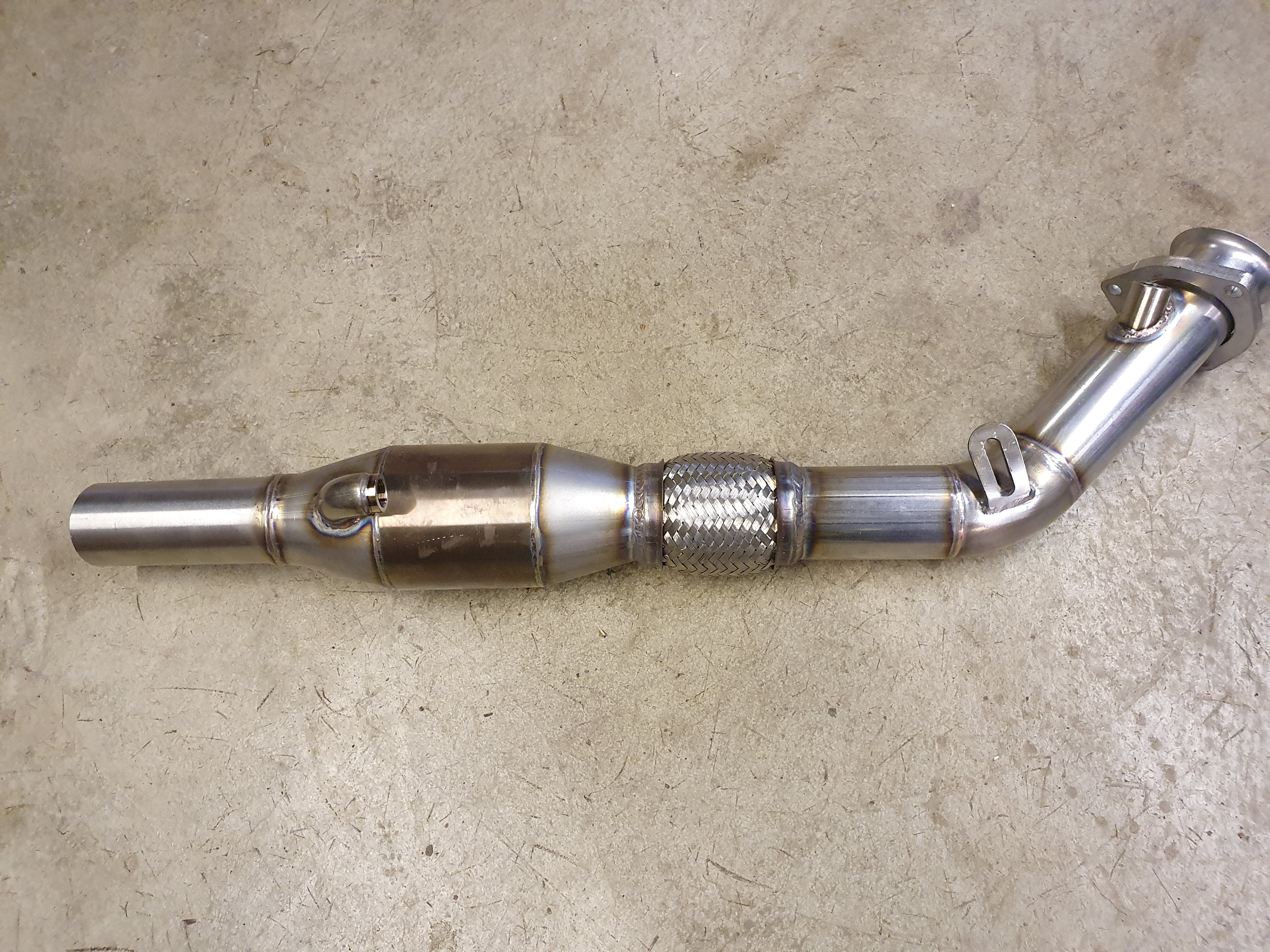

First picture is the new Zinram 200e cell cat pipes, the pre-cats would normally sit to the right of the 45 degree bend, so downstream of the exhaust manifold flange connection.

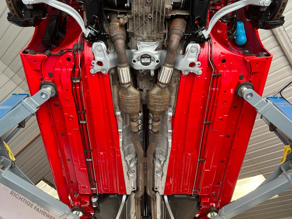

The second is of the original cat pipe section on the car, both the 200 cell main cats and 400 cell pre-cats are located on the cat pipe sections.

Ahh ok that makes sense, hence a single decat pipe in the same length/format as the Zinram one you posted a pic of gets rid of both the pre and main cats in one go.coffey555 wrote: ↑Fri Sep 08, 2023 9:59 amYeah, the 400 cell pre-cats are really restrictive. The main 200 cell cats are not too bad though so people just remove the restrictive pre-cats on the original cat pipes. But like you say, no cats will give the best flow....... assuming you have a friendly MOT tester near you![]()
I didn't realise that both the pre cats and main cats were so close to each other.
