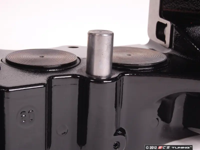

The pads sit on this slide (this is a pick of a new one obvs) This slide seems a bit rough on my caliper and the pads were really stuck in.
It might turn out to be the pistons, but has anyone had any other issues with pads getting stuck?

I've had seized pistons on other cars with single pistons. Far easier to swap out a new piston & seal kit than the 8-pot Brembos.
You could try cleaning it all up but gut feeling is you'll be better off sending it off for a refurb.
