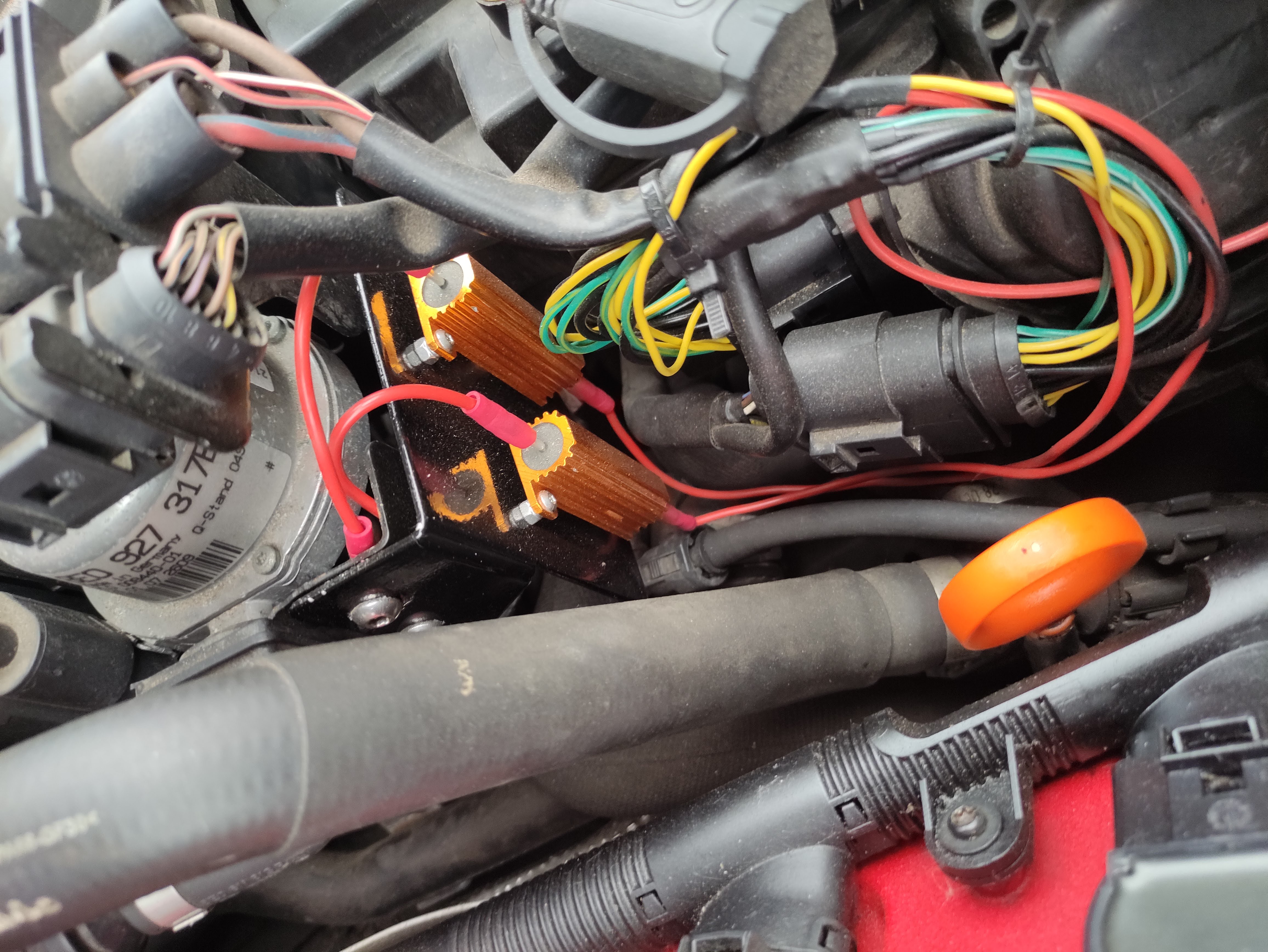

B7s are a bit awkward tbh.
I went for some standard LEDs and housed the resistors outside of the light housings.
mike

Thanks Mike. Could you house them outside the housings with the set on Ebay as they are, or would you have to improvise and lengthen the wires for example?

Here's what I've done... just need to clip into the existing circuits....
Oh, and got some extension cables so as not to mess with the OEM wires
