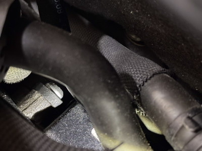

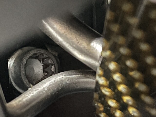

Turns out the issue was a loose bolt rattling around in the bell housing, it doesn't belong in the bell housing and hasn't come from any clutch or gearbox components. Which is where I need your help!

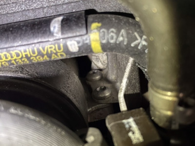

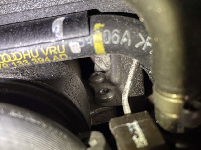

Can anyone identify this bolt or give an idea of where it might have come from, considering the car was fine up until the carbon clean? Should there be a bolt in the second picture at the back, which could have been dropped? These are the only pictures I have at the moment.

Picture 1 looks like one of the bolts from the PCV located near the firewall right abowe the bellhouse.
Picture 2 is missing bracket for lifting the engine.

My thoughts exactly, not even a hint of clutch slip or mechanical failure before going in. The fact the engine lift bracket is missing (thanks MT for identifying) but was clearly removed for the carbon clean based on how clean the thread is vs surrounding area. Very probable the bolt from this might be the culprit?

The bolt from liftingbracket looks different. But the bolts from PCV, oilfilter looks like your bolt. I think these parts has to be removed before lifting manifold.

They found one bolt missing, same as you've got pictured there MTBear, thanks for your input :beerchug: likely it was dropped down the back of the engine and found its way into the gearbox inspection hole, whatever the odds are for that!
