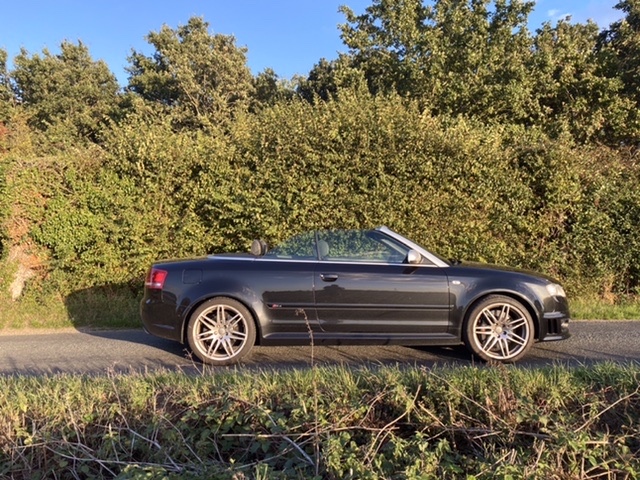

Hi all
What spacers are peeps running, espesh on the convertibles?
Im thinking 10F, 15R.
Any thought?

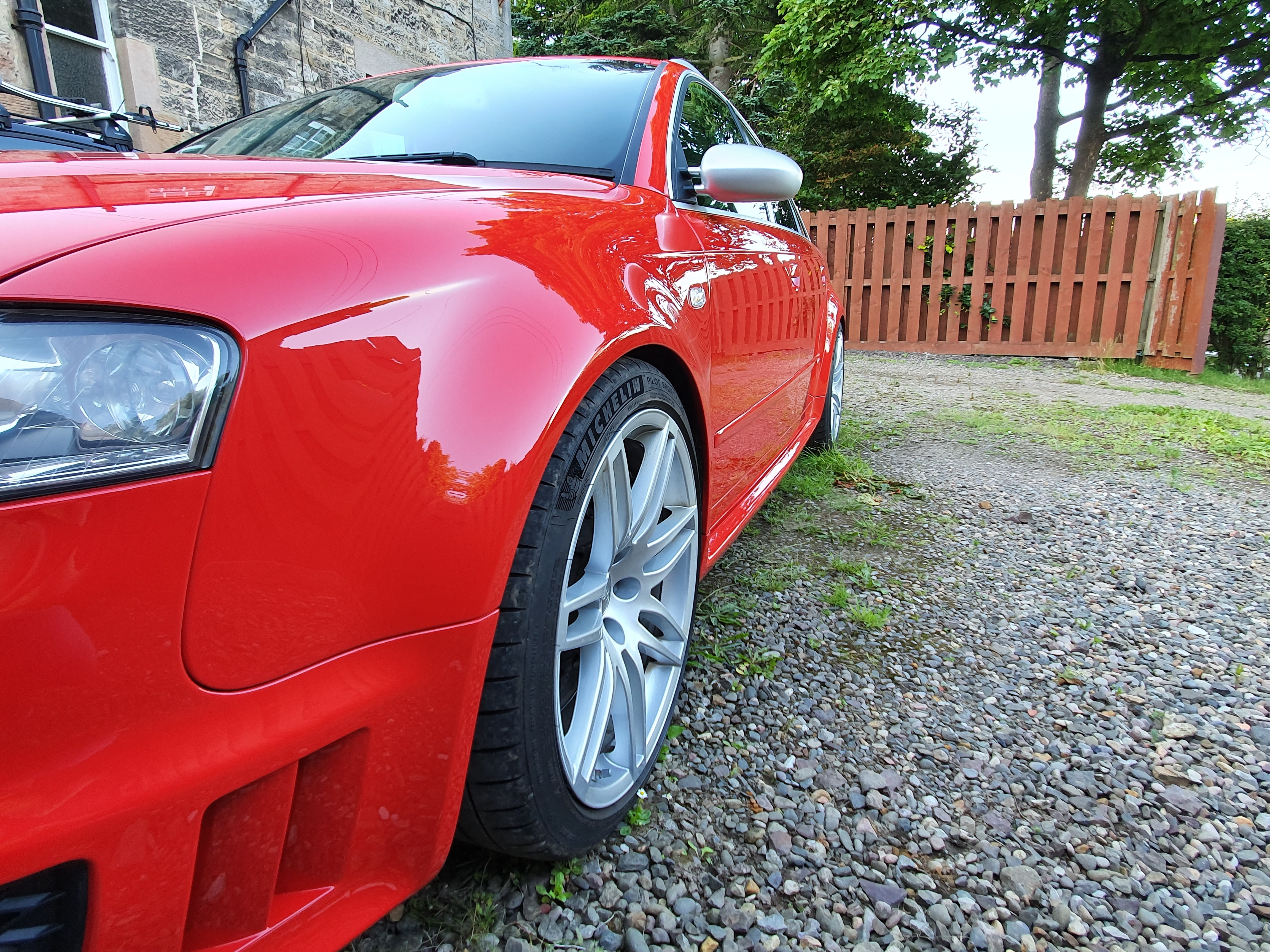

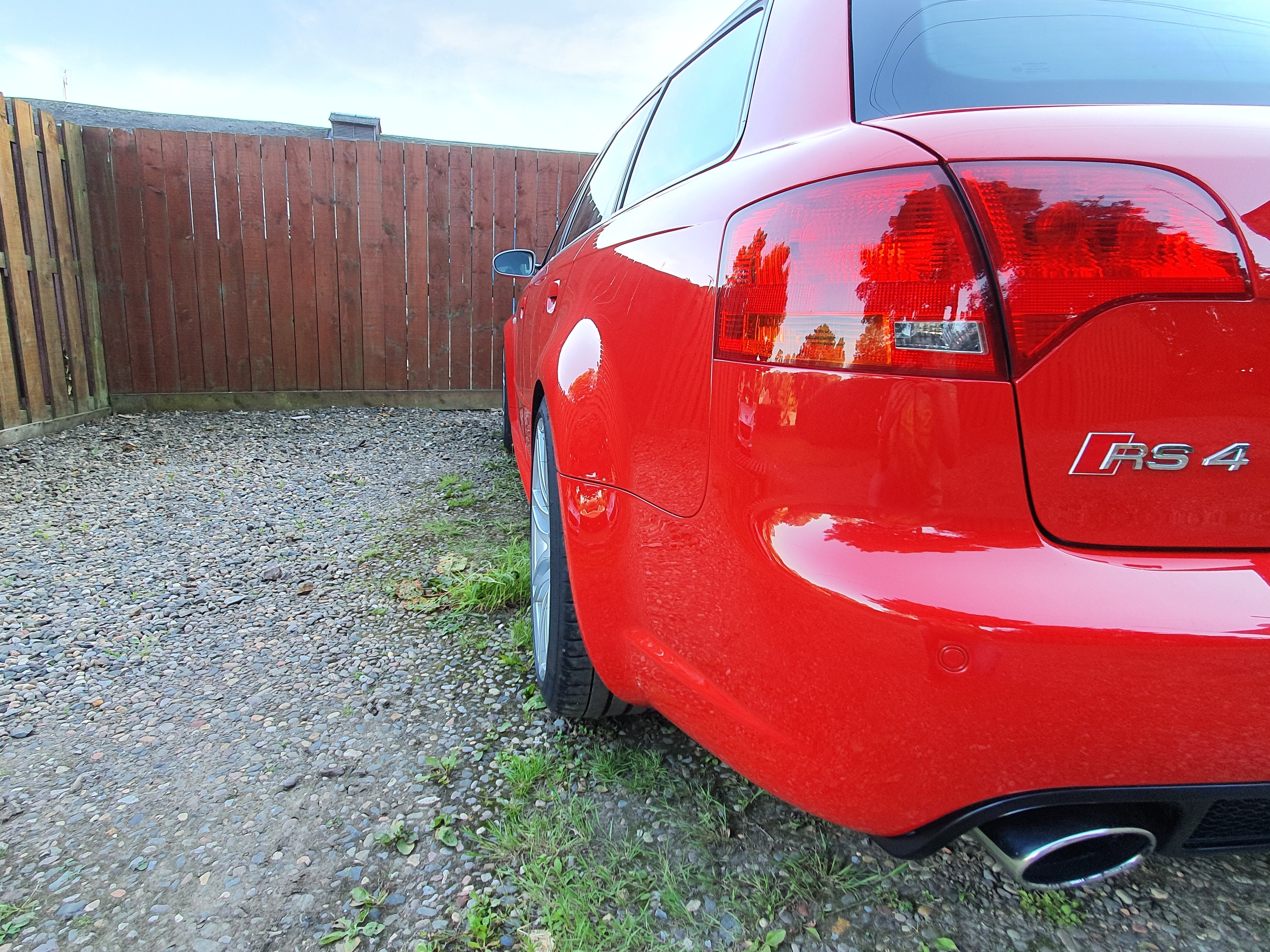

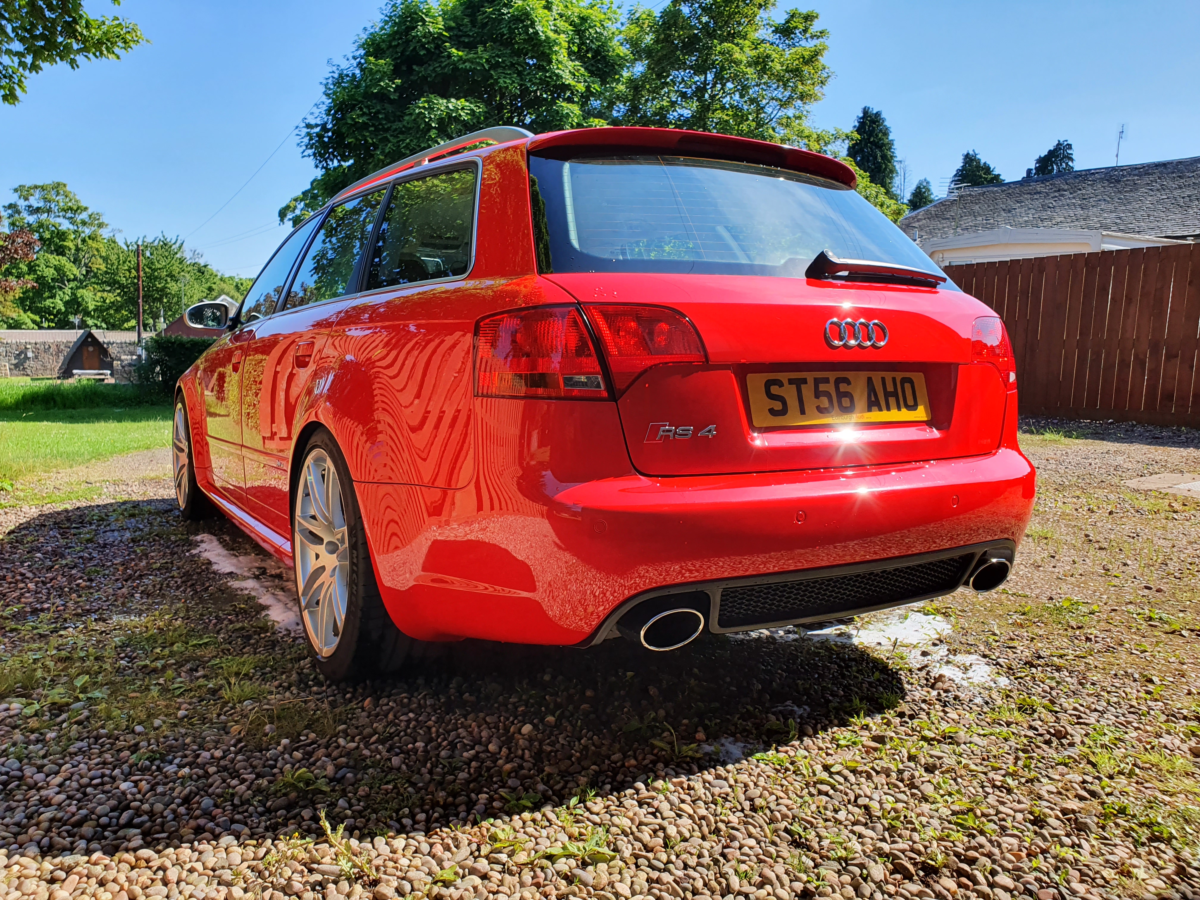

8mm all round on my Avant, no rubbing with coilovers set to SS+ height and OEM 19" wheels.
15mm will rub at the back for sure.
Some people run 8mm front, 10mm rear with no issues but it depends on the tyre sidewall profile. Goodyears have thicker rim protection.

Sumdy...any piccys? Mines still on DRC so prob a bit higher than tours??

Just incase anyone is interested...just put 12.5 on rear...which now sit identicle to fronts (which dont have any spacers at all).
