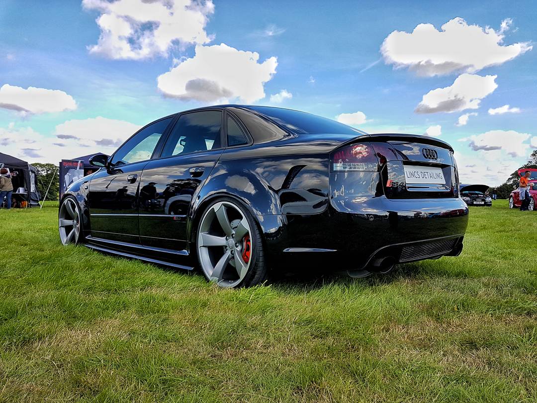

Fitted with no spacers 255 30 tyres and pretty low
Currently forsale too

That looks amazing Rick!

:thumbs: thankyou. Changed a bit since then. Wheels, trim, brakes ha ha ,
