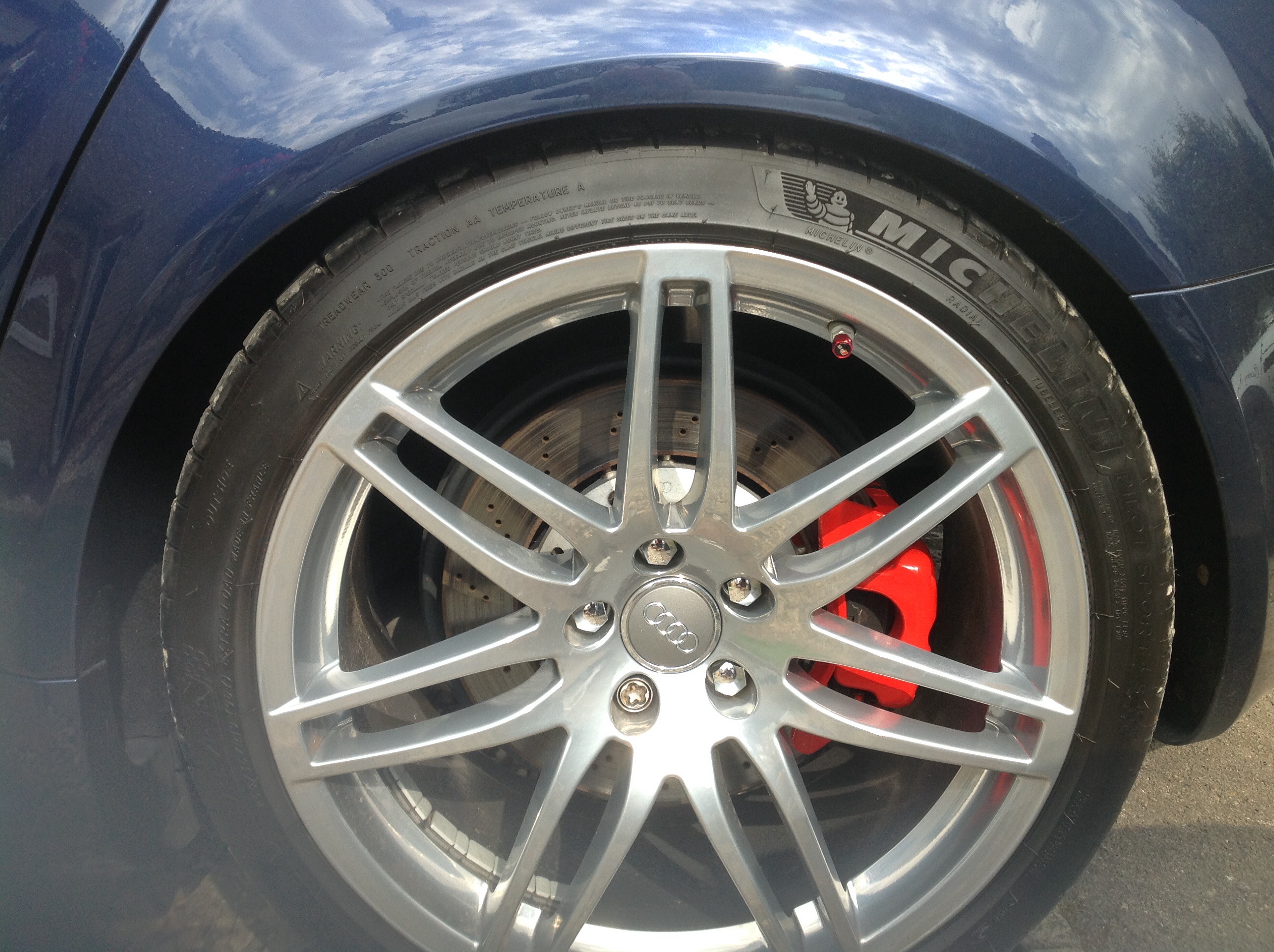

The rear looks around the same height my car was until very recently when I raised the rear ride height.

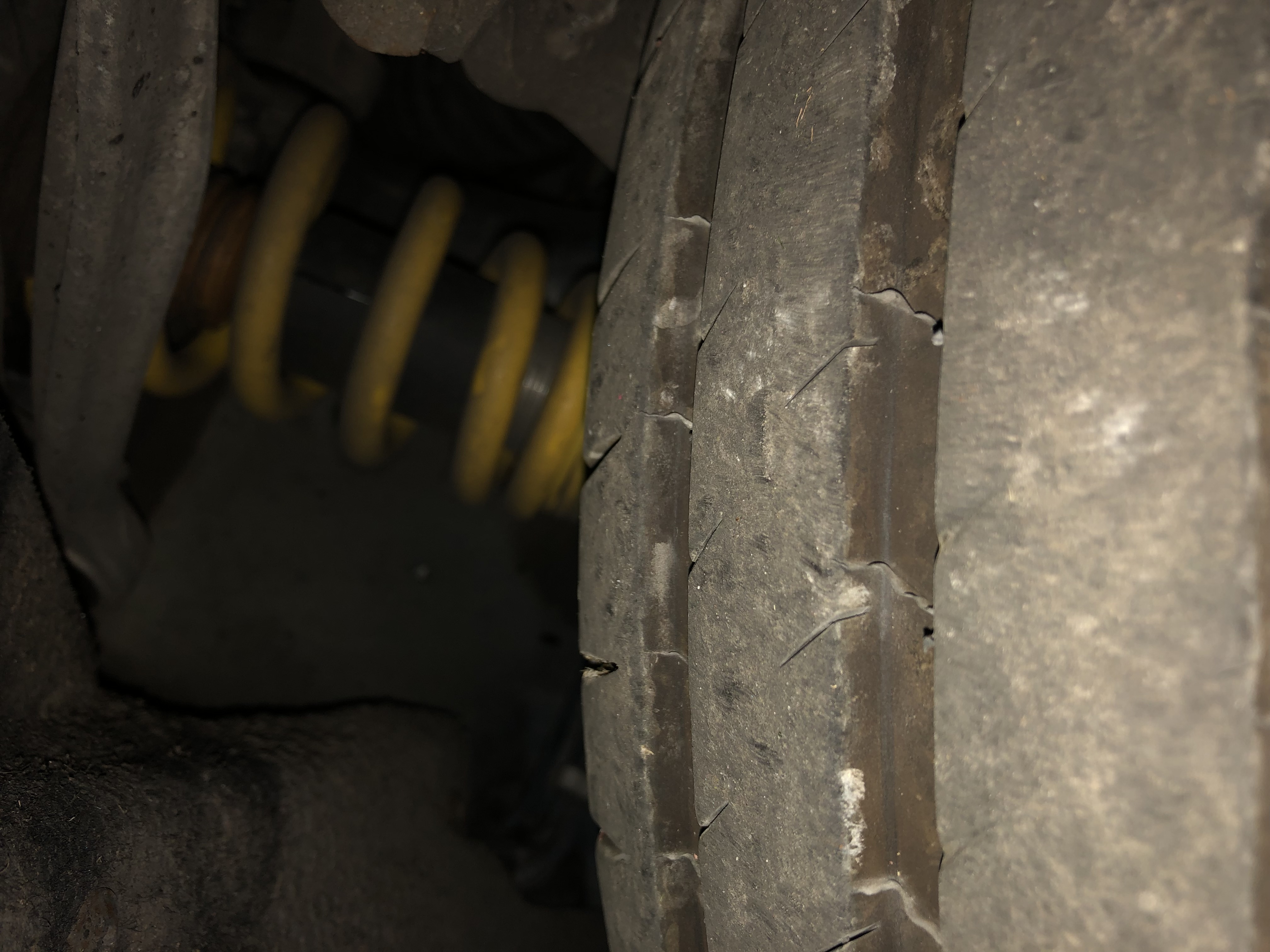

The after market suspension was fitted by a previous owner. I dont know what make it is or even if it's a good make or a cheap one here's a pic of it maybe somone could identify it for me.

You have KW V1 or V3 coilovers installed, same manufacturer as the ones fitted to my car. They are one of the better coilover kits on the market.
Both V1 and V3 setups have the same range of height adjustment.
I would take it do a good local indie and ask them to raise the ride height followed by a full geometry alignment. At full height it will be 15mm lower front and 10mm lower rear than standard SS setup. That should see you clearing most things on the road.
