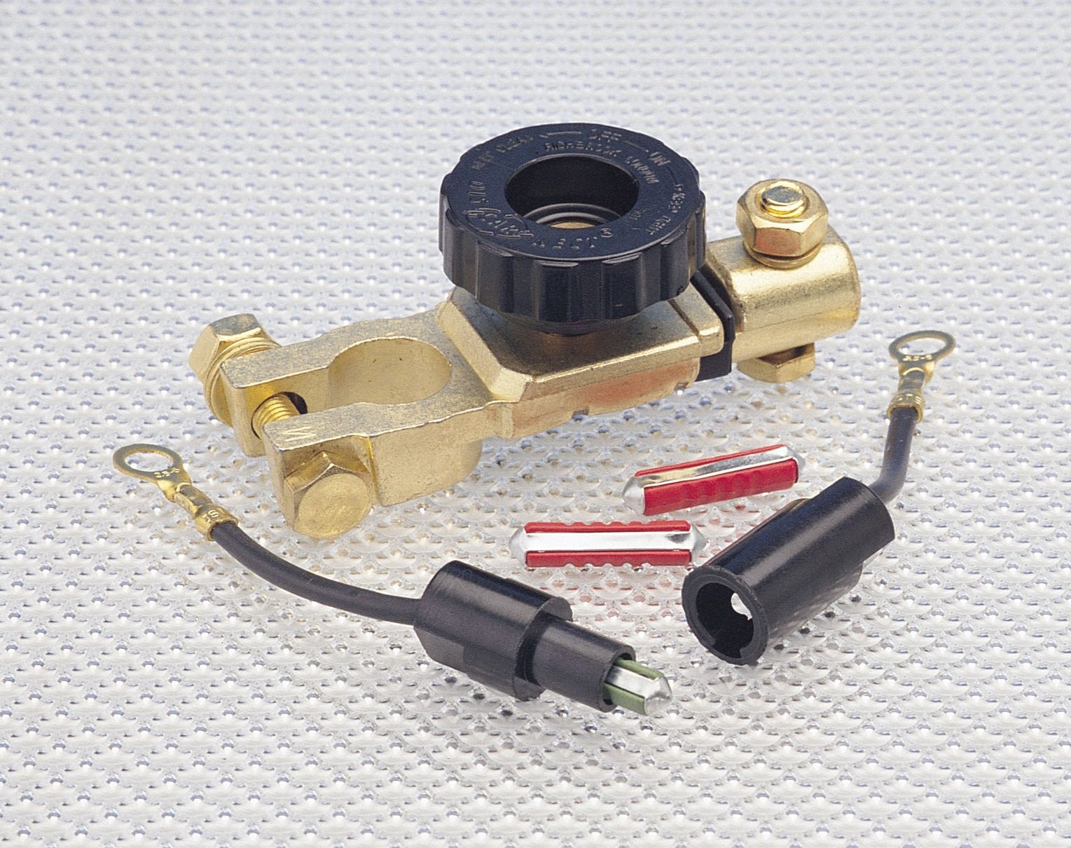

Suppose you you could use one of these - https://www.ebay.co.uk/itm/Discarnect-C ... 1438.l2649
You could extend the fused wire that just provides enough current for the electrics.
You could lock / unlock the car with this connected.
The extension could come out of the boot with a switch on perhaps.
Mike
MB2
Posts: 1575
Re: Battery Disconnect Switch?
Post by MB2 » Mon May 20, 2019 11:24 am
That could be good solution if the wires were extended outside you could undo the brass connector, lock the car, disconnect the fuse and all of the electrics and then when you come back re-insert the fuse providing enough power to unlock the car.

But, the picture from above gave me ideas, and I had already figured out a plan on how to implement a solution, both in terms of procedure and technical implementation. Only to abandon it shortly thereafter...
What I think I'm going to do is install a simple battery disconect switch - and nothing else. And in order to circumvent the procedural problem (accessing the battery in the boot while the car is already locked), I'll buy a small booster battery pack, which connects to the jump lead terminals in the engine bay, which will power the car's electronics during the short period where the main battery is already disconnected, and we still need power to lock the car.
Brilliat concept, if I may say so, plus a perfectly valid reason to buy new tools. A win-win situation if there ever was one. :biggrin2:
