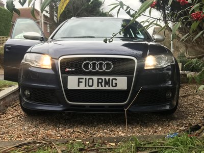

The before and after pics don’t look amazingly different, but it is much whiter looking at it in the flesh.
I’ll add a nighttime pic when it gets dark.

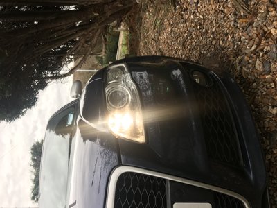

This is the before....

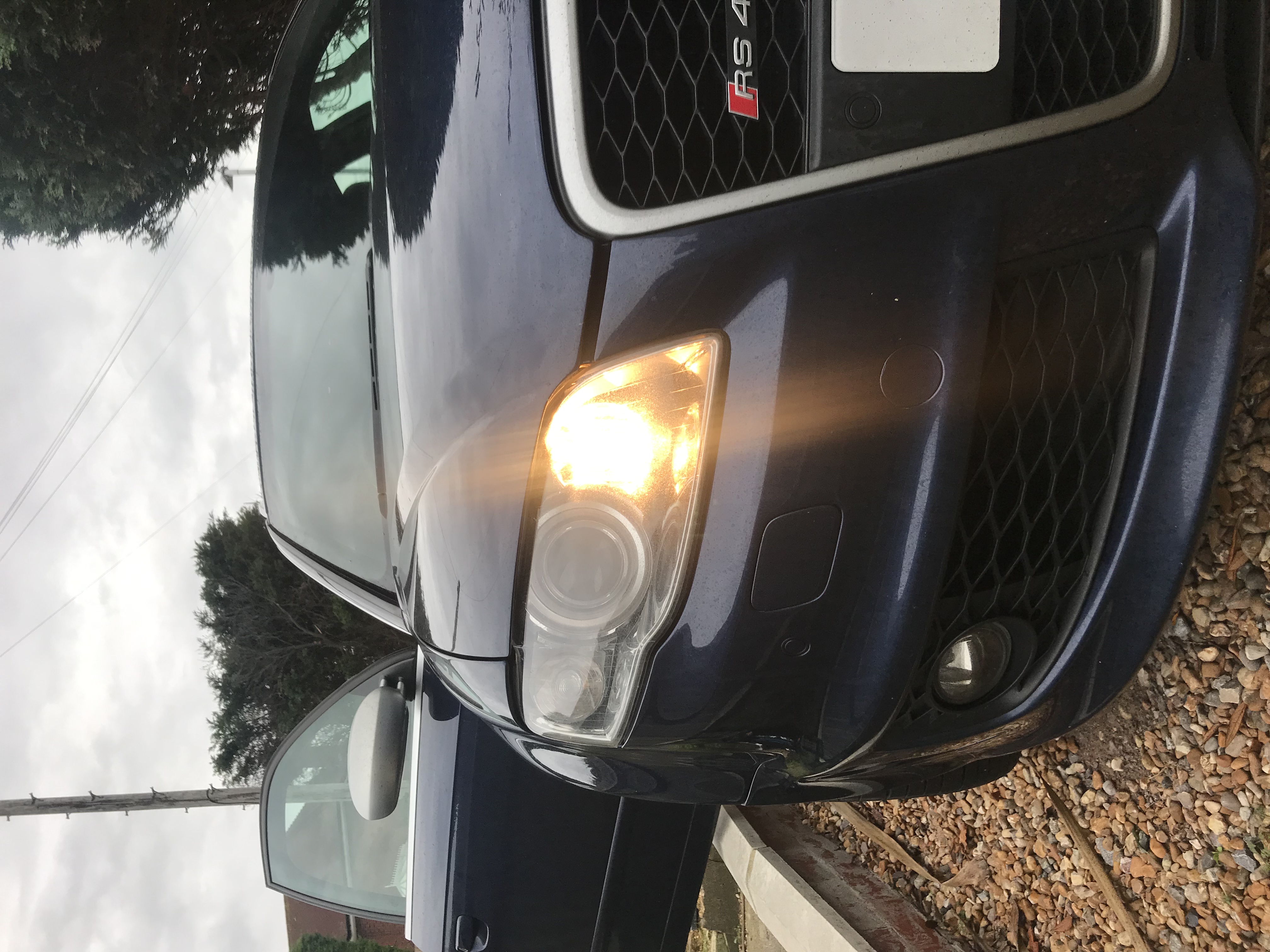

This is the passenger side done
Old close up
New close up
This is the only thing I don’t like. The glass is blue. Can’t see it when on but not sure how I like it parked. May replace with clear at some stage.
