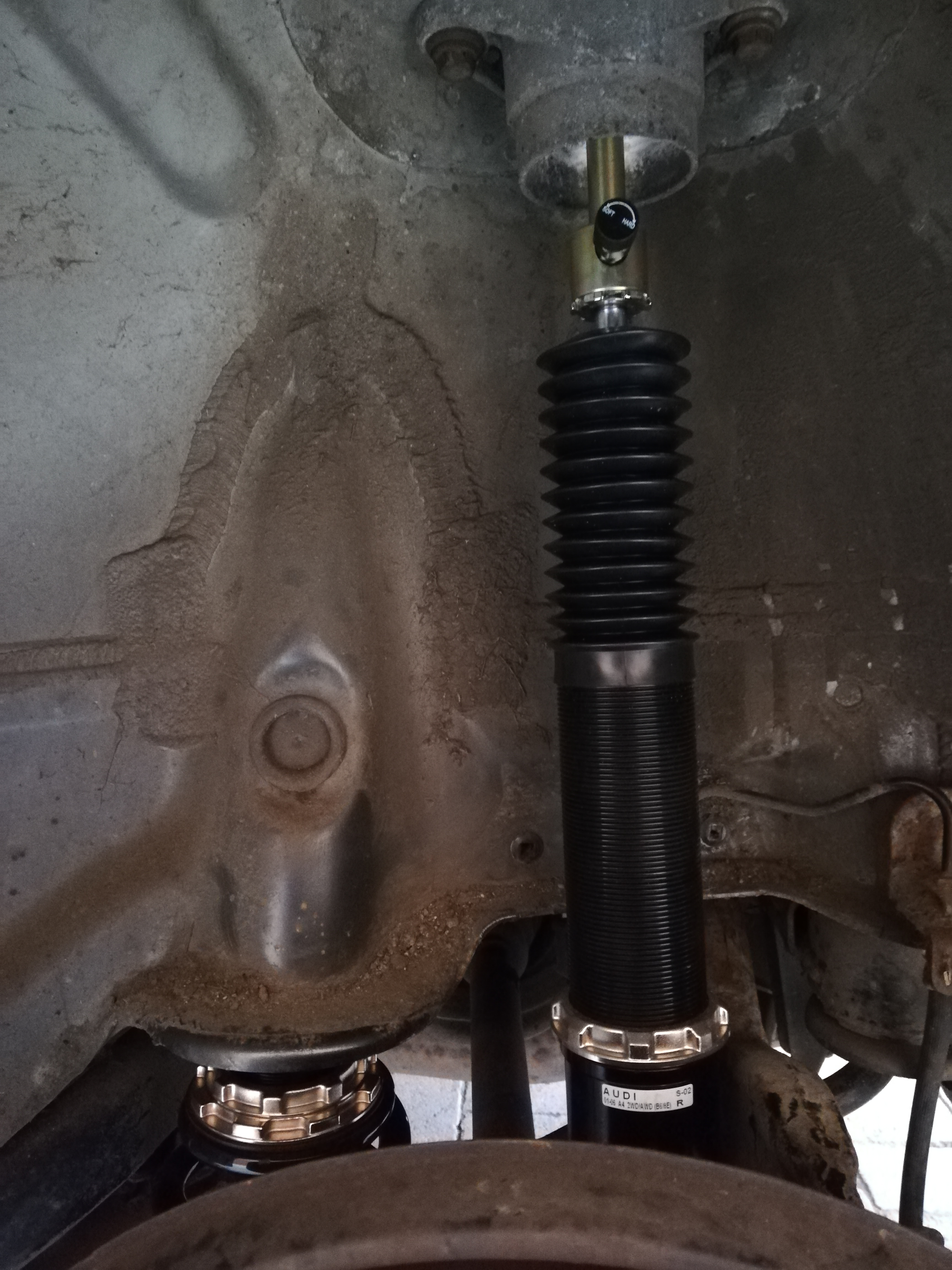

Here's a couple of pics of the rears, I've mounted the adjuster on the top so I shouldn't have to drop the subframe if I want to make any future adjustments.
And the front,
I've raised the rear 15mm and the front 5mm and I've also stiffened the damping as it was a bit soft when I went round the block the other day.
Currently I'm 10 clicks from hard in the from and 6 from hard in the back. For some reason it's sitting about 25mm higher now at the back even though I've only wound it up 15mm and closer to 15mm higher than the 5mm i wound at the front
Maybe it's because I've stiffened the damper up, who knows. Gonna go out for some fuel and a drive and will take some photos see how it feels. Now sat at 63ish at the front just a smidge under 64 at the back so will see how it settles.

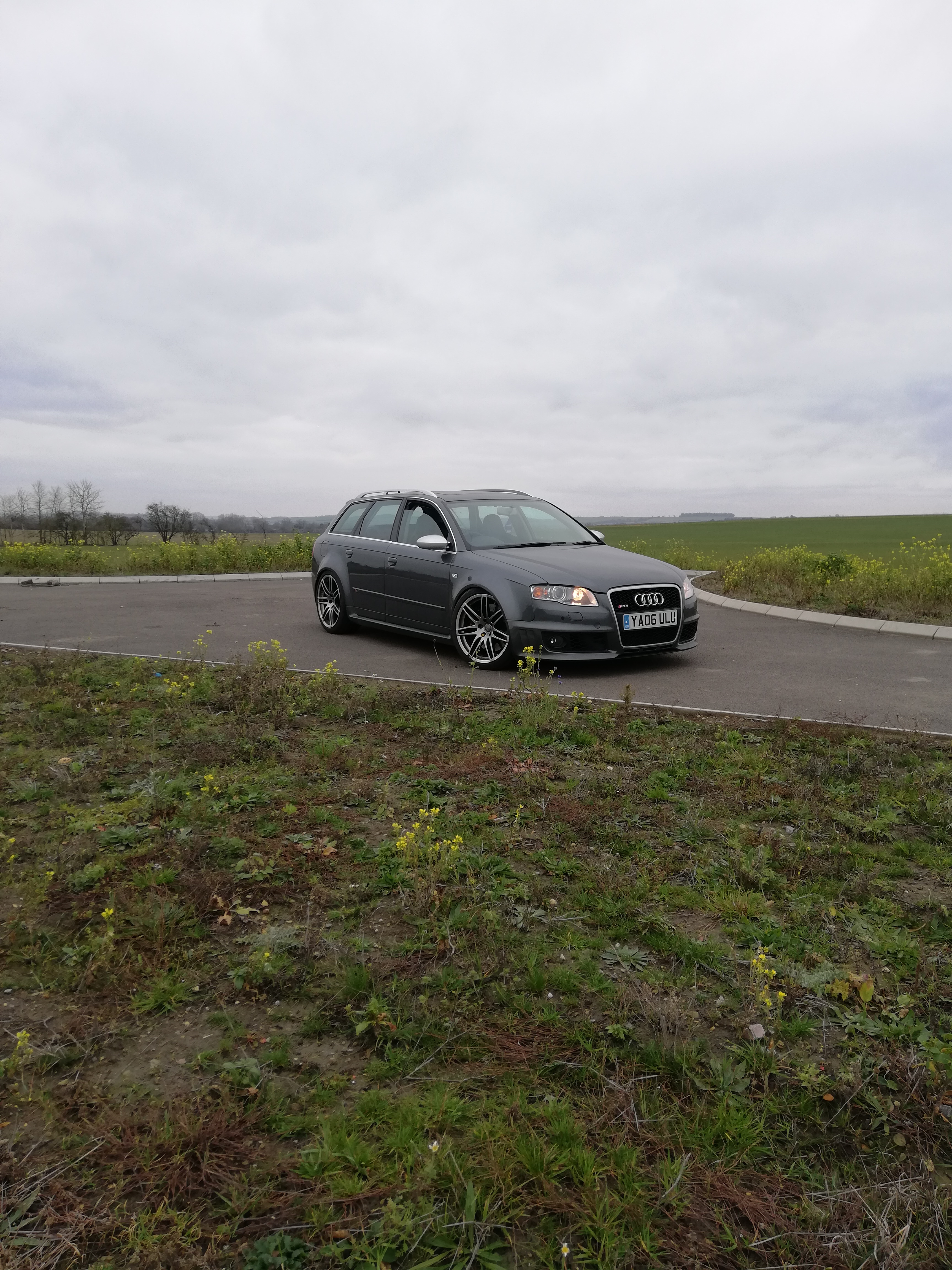

So a few pics from a little drive today, she's settled a little bit now as well.
It feels very good, slightly firmer than DRC I'd say but handles very well. Very planted, I was worried it would be about wallowy but it doesn't seem to feel that way at the minute will have to see as I get used to it again and if so then I'll look into doing the anti roll bars.
One thing I'm getting is a bit of rubbing on partial lock when cornering or turning on an incline for example, the drivers side only weirdly. I'm holding back from pushing too hard til I can sort that.
I've removed the arch liner screw and it's not resolved it as it seems to be either side of the centre of the arch. I'm happy the coils are set within about 0.5mm of each other. I have adjusted the preload when changing the ride height and am fairly confident I set it back to as it came both sides but will double check that also.
They're definitely seems to be less room on the drivers side when going from lock to lock even though wheel to arch measures the same. Will see what an alignment reveals and go from there, but realistically I'm going to either raise it another 5mm or have the arches rolled.
Alex
