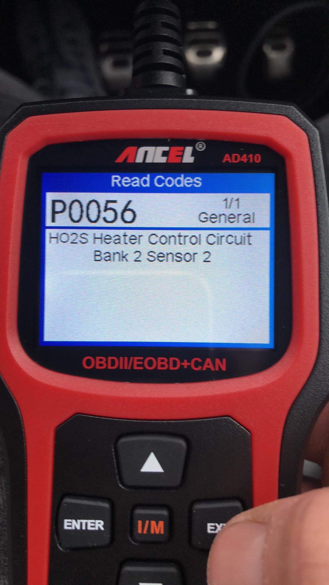

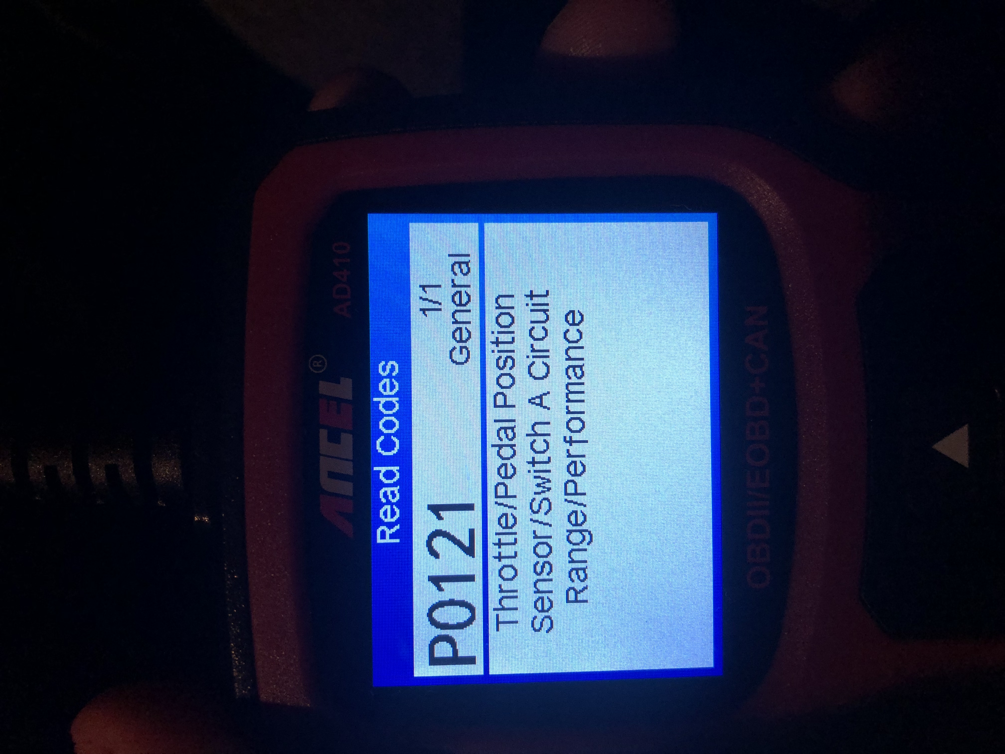

Got throttle body’s cleaned an re set Wednesday and car was running spot on all the Fault codes had been cleared!! Garage did say the throttle body might need doing in the near future!! Got in it Thursday night and the check engine light came on but didn’t change the running of the car at all I was thinking cos as it’s been sat for nearly 2 weeks having all these little niggles done like new clutch and flywheel that it just needed a damn good clear out!! So I’ve drove it home which is 100 miles away pulled up gone in Shop come back out turned it over and epc light came on and traction control and limp mode! So I’ve made it home rest of the way and then the check engine oil light came on so I put half a litre in and it went out! So got home eventually! Left it for 20 mins checked the oil was on max! Started her up and epc and traction light gone out and limp mode gone still got check engine light tho!! Then drove off and the low oil light come on again!! Any ideas what the hell is going on! I’ve only had this motor a month and the problems it’s given are very annoying

Morning, you could check the owners manual to see under the fuse allocation are the oxygen sensor heater circuits fused and see if they are ok. Otherwise could be the sensor itself, it may of been damaged unintentionally when the exhaust was removed for clutch issue. The sensors can often fail when exhausts are removed in a way that requires heat and force to remove due to age.
Seems strange to have a pedal issue as well as an engine oil level fault. My first instinct is that there is a shared earth wire somewhere that has not been tightened up properly but without a wiring diagram I am only guessing.
The car needs plugging into Vag Com and the pedal potentiometer checking first along with oxygen sensor heater resistance.

The first one could be a throttle pedal, i have had to change my pedal in mine easy job.
I did change the throttle body aswell first but i think its was in more the pedal in my case.
Seconed one is lambda sensor bank 2 sensor 2. Need new on that. After replacing one on mine i found they all seemed to start failing.

Ok well that’s made me feel a lot better lol the engine light comes one exactly after 5 mins of car running after I’ve cleared the code so I reckon the 02 sensor is sensing a fault and the engine light is coming on!! And as for the esp light and traction control light that Happens intermittently when I put me foot down it’ll go straight into limp mode with lights up on dash
Re: Had enough
Only way round the sensor is buy a new one.Sunshine88 wrote: ↑Sun Dec 02, 2018 1:29 pmOk well that’s made me feel a lot better lol the engine light comes one exactly after 5 mins of car running after I’ve cleared the code so I reckon the 02 sensor is sensing a fault and the engine light is coming on!! And as for the esp light and traction control light that Happens intermittently when I put me foot down it’ll go straight into limp mode with lights up on dash
But the throttle problem i would buy the pedal first its cheaper, google you will see lol
Re: Had enough
I would take it to an Audi dealer or better still MRC. My throttle body was faulty i.e., Tranction light, Engine light and limp mode came on. Audi found a fault on their diagnosis machine. They removed and tested my throttle body and couldn't find a fault. Refitted it but the problem came back so I bought a brand new one anyway, Audi fitted it and the problem was cured. I think it cost £1300.

When ever I go over 5000rpm the epc light and traction control light come on and limp mode! I’ve sorted the engine management light which was down to a faulty lambda sensor! And the oil sensor needed replacing aswell! So that’s them 2 sorted out! I’ve brought a second hand throttle body from a which had done 43000 miles and looks very clean! That’s getting fitted tomorrow and have been told that the wiring is spot on for the throttle body! Will report back if all is well
