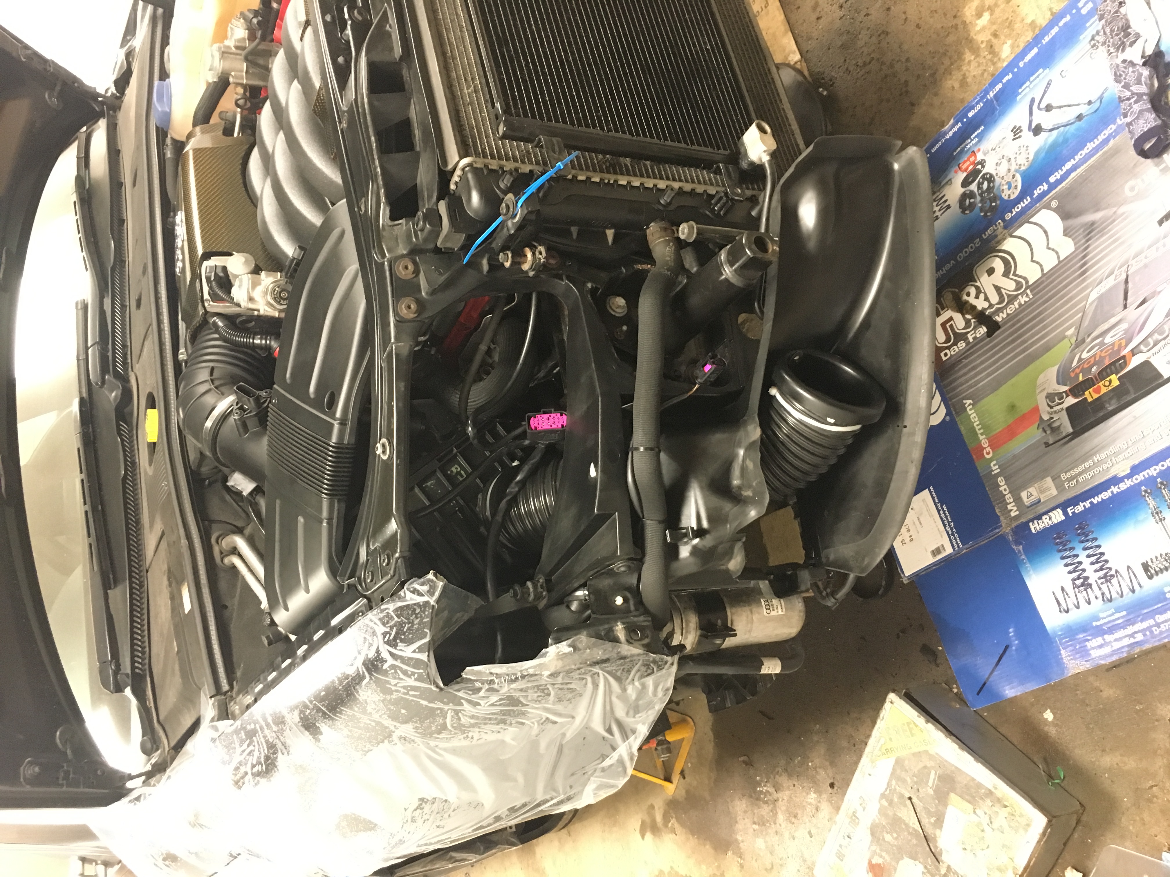

Evening all has anyone a guide on fitting one off these ie do you leave the bottom half off the original air box as I am doing a caf as well your help would be greatly appreciated 👍

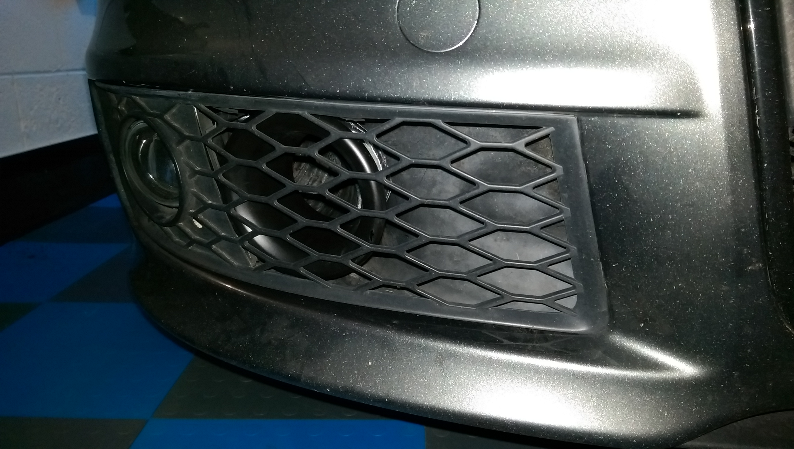

As Mike says - fit a large CAF from behind the fog light grill (assuming you have aux radiator delete?)

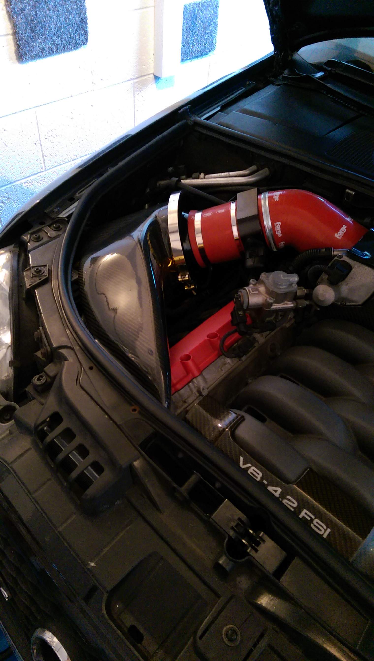

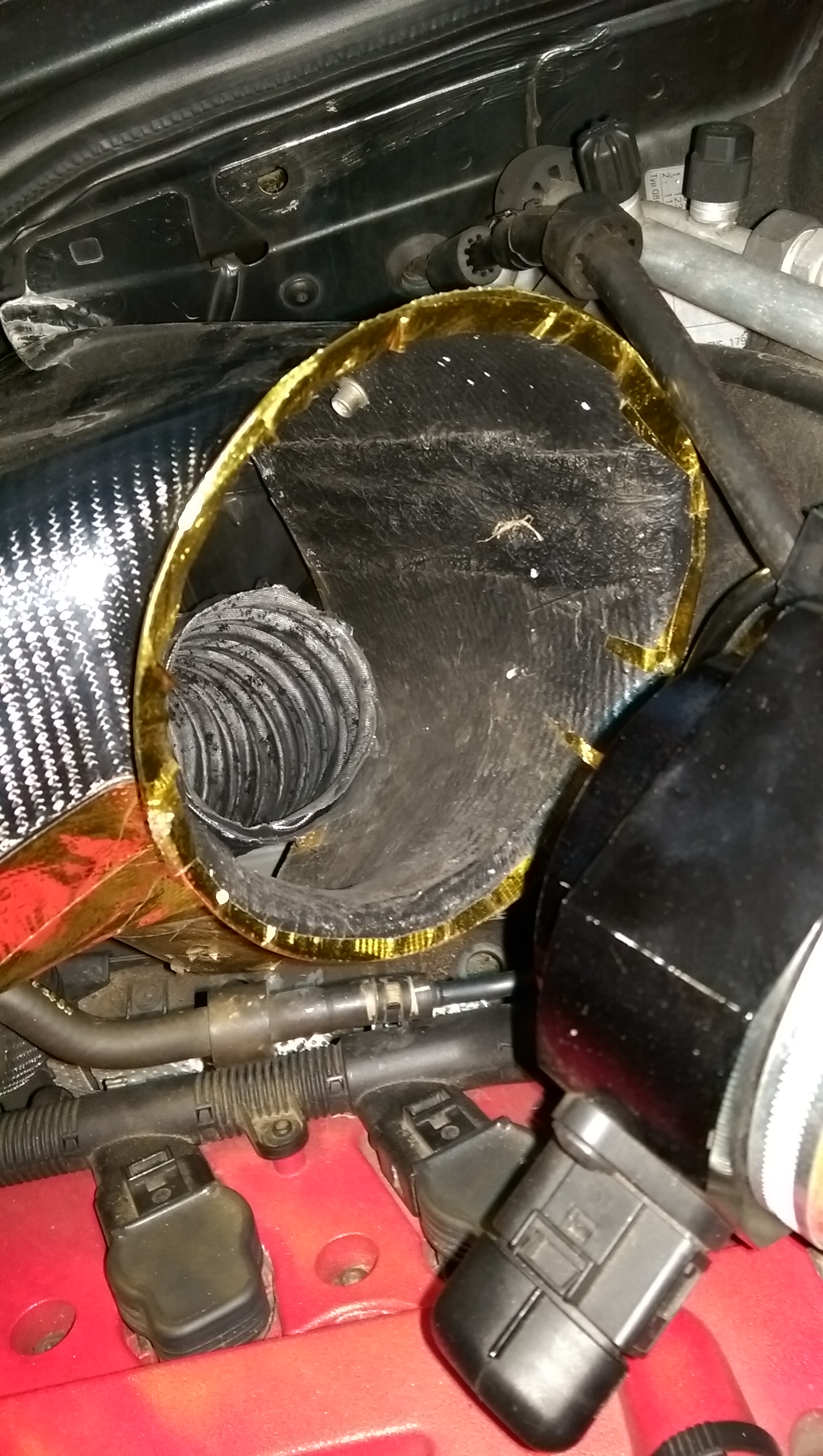

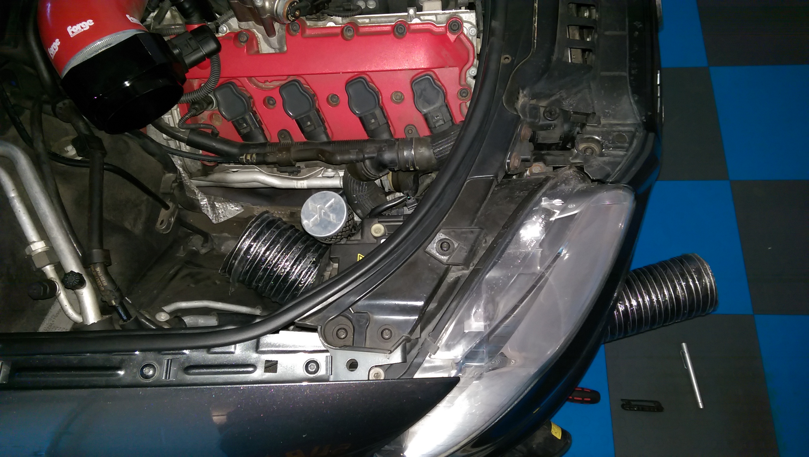

Heres a few random pics of my upgrade install -
45mm diameter feed removed ready for 102mm. My opinion is any larger would be struggle to fit
Inlet trumpet fitted
Engine bay bling
