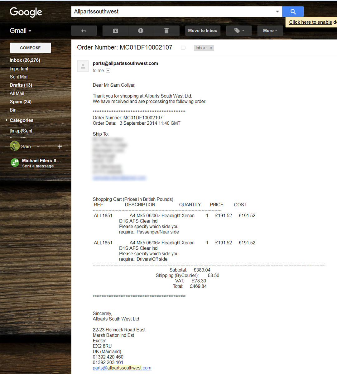

The company was Allparts Southwest but they have recently re-branded and no longer show the headlight in their online Shop. I'm sure they will still be able to get them though, from memory it was around £300 per headlight and you just needed to swap the Xenon bulb and balast over from your old one. They come direct from Magneti Marelli in their packaging.

Thanks for the help - unfortunately because the car will be at Audi I am a bit limited in what I can do with the headlights themselves. The left one has flickered a few times and went out a couple of times too last weekend so I think makes sense to change the ballast and probably the headlight as polishing hasn't restored it and console myself that the "free" labour offsets the cost.
I rang all parts south west but they said had never sold A4 headlights (although I remember the thread)...

Re: Headlight replacement
Sounds like you spoke with a jobsworth; here's the confirmation email I had if it's any use:
Click to enlarge:
Click to enlarge:
