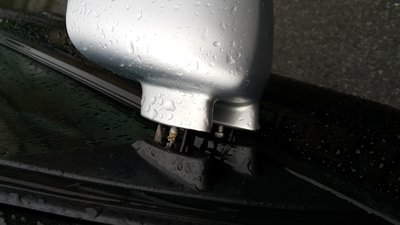

Hi Guys,
Someone just knocked my mirror. There doesn't look like theres any breaks. I tried to just push it back on but no joy. Didn't want to use too much force in case i snapped it. Do i need to take off the whole thing and re-fit?

You can probably push that back in. It does need quite a bit of force - rember it is designed to come out when hit by another car so you need to "roll" it back in, opposite to how it came out.
I put mine back on the floor straight on with my bodyweight but I would avoid removing the triangle if you don't have to as that should be a lot more work.
The springs are flat square metal so quite strong but even pressure should get it back in.

It pops back in very easily although it needs some force.
