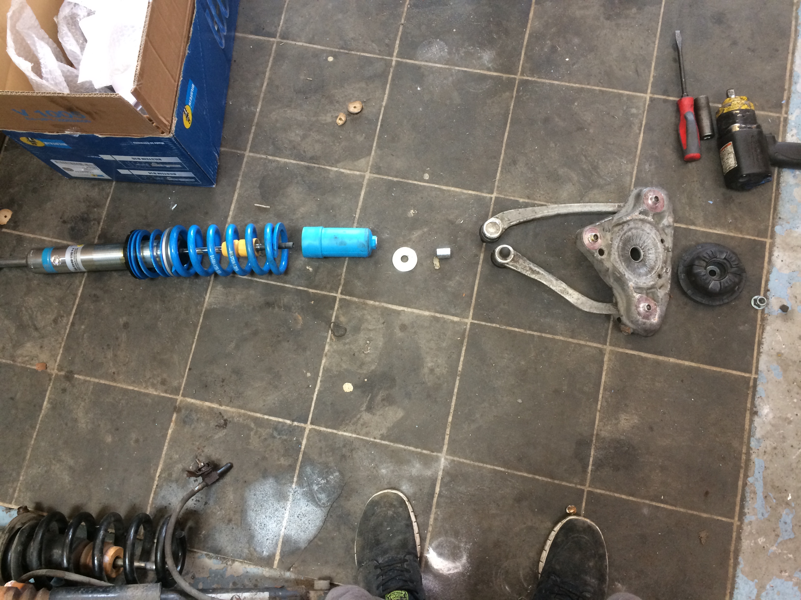

managed to fit my brand new B14 Bilstein coilovers to my RS4 this afternoon/ evening with a lot of swearing...
went for test drive and its knocking over any slight bump both sides on the front.
now I'm guessing I've fitted something i shouldn't have or incorrectly... i fitted the new coilovers in the layout they came in, and diagram of the handbook provided but not sure if i needed to take something out?
I noticed the spacer (that i fitted under the top mount) provided by bilstein was much wider than the original one fitted by audi..
and there seemed to be a washer underneath the dust cover that bilstein provided which just looked loose with no real location...
Any advice welcome, guess I'm gonna be up early pulling all the suspension off in the morning :boohoo:

Had the fronts off again and moved a washer position and seems to have irradiated the knocking noise, but now I have a creeking noise from the nsf when stationary and turning lock to lock.. anyone experienced this?
Below is the layout of the front shocks I have fitted if anyone can confirm this is right

scratching my head a bit now.. i can't remember seeing a bearing, unless it dropped out when i took the old units off..
looking on that image I've put it there isn't one there? (where exactly should it be)

ah now i see, the bearing is part of the upper rubber bushing. cheers
seem to have it in the right order by that picture.. guess il have to take it off for another look :shock:

Problem solved! Front spring wasn't sat evenly in the top mount so was rubbing on centre metal cup..
