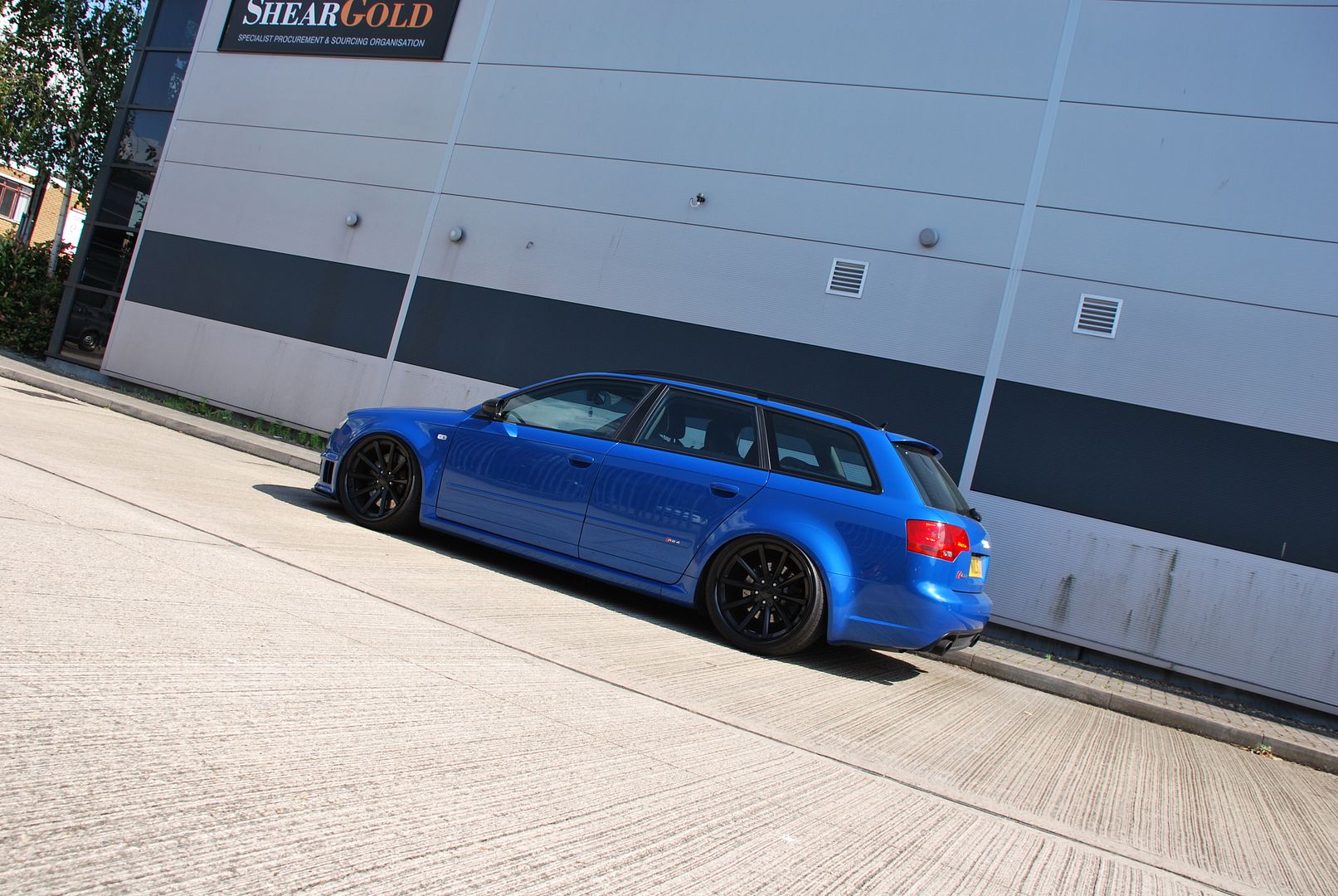

That's a blast from the past. Near on 3 years that the wheels have been on. Just about to send them off for a refurb in a couple of weeks.
There were some doubters that said it couldn't be done. Anything is possible with persistence :thumbs:

Wasn't a bolt on but you'd be surprised how little work it needed to make it happen.

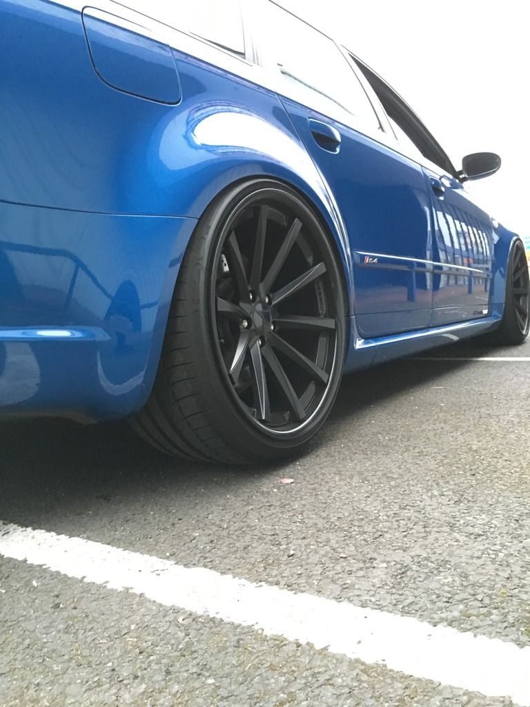

I ran 10.5x20" vossen CV1 ET30, I had 8mm spacers front to clear brakes and 10mm rear to have them sitting correctly in comparison.
265x30x20 tyres
They were aggressive, but I was on air suspension, on stock I don't think they will work, a little too aggressive I'm afraid
Looked amazing though!!!

This is 20x10 255/30 tyre with 3mm spacer on front to clear calliper et25

Wow looks really wide? Assuming theres some rubbing?
