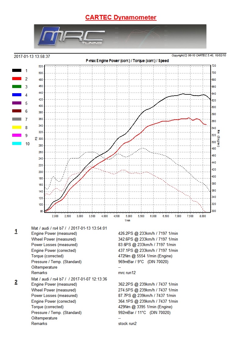

Looking forward to driving home.
Gains look good on paper

Good gains, i think you'll enjoy the drive home....
