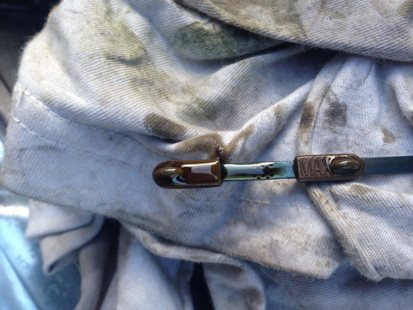

OK was topping up this afternoon and took a few numbers.
Firstly please note - I do not top up to the max line on the dipstick as mine uses the oil noticeably faster when the level is maxxed. I top up to midway between the hatched area and the max line on the dipstick, this is about 2mm below the max line as per picture. Some measurements after top up:
Top of bracket to dipstick tube lip: 42mm
Engine measurement block 009: 77.5mm
Instrument block 007: 2540ml
All done on level ground - pointless otherwise
Hope this helps you.
Paul
Paul

Re: Help needed re oil level
Paul T you are a legend
Thanks for going to this trouble and I appreciate you being so specific about where your dipstick was reading.
The VCDS readings are uncanny as they are exactly the same as on my car. Wonder if it maxes out at a certain point and doesn't read higher than these figures?
This is the reason I asked, the MTM Supercharger conversion uses dipstick as return for supercharger oil, means undoing the union to dip the stick but it's worth it, although in time VCDS may be better once I get to know where the top up point on the stick is in ml/mm
I've measured from bracket to mouth of tube and I get a few mm more but then my stick only reads to the top of the hatched area which on this basis I should treat as the this car's real max.
Thanks again!
Thanks again!
No problem! It is interesting that the numbers from VCDS are identical and i tend to agree with your conclusion that likely there is a point that they max out. Wish i had run the VCDS measurements before topping up as well - if i get a chance i will try that next time i do the fluids. Interesting to try to figure these numbers as an 'electronic dipstick'.neckarsulm wrote:Paul T you are a legend![]()
Thanks again!
